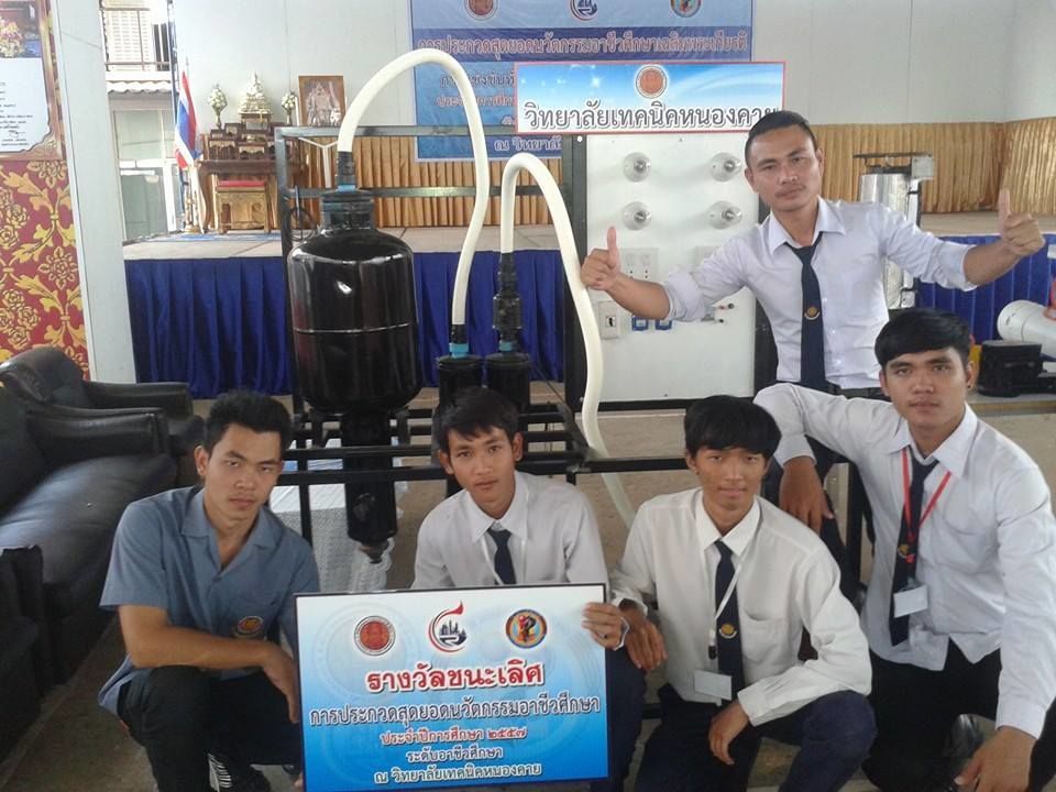

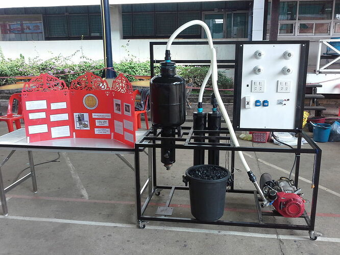

Koen; The middle picture with the yellow bulletin board, what is the tube going from the top to the bottom?
Very interesting how much work they put into even the bulletin boards. This location looks more like what I would think a college shop should look like — maybe minus a lot of the equipment needed for the students. TomC
Glad it’s all going good for you, and them.

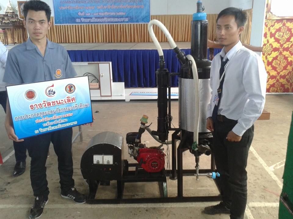

That tube at the right side of the picture comes from the center reactor (top) and is connected to the air intake nozzle from the charcoal reactor ( bottom ). This tube passes the gas from the pyrolyse to the gasifier.
I apologize for asking that same question earlier. Other than getting rid of plastic, I don’t understand what the pyrolysis gas has to do with the process of changing charcoal into CO. Are you burning it to maintain the endothermic heat for the CO2 to CO reaction? Is that to save on the amount of charcoal used? Sorry but I guess I haven’t been following this thread as well as I should. TomC
This unit is a “on demand” build, based on an earlier idea i had.
The plastic is gasified under absence of oxygen, generating kind of pure plastic gas :wink: useable for many purposes.
In this unit i can sent the gas back thru the charcoal bed, to ensure a kind of purification, converting to mainly H2 and Co with more HC present.
I am not entirely sure about the output, only that the gas will be richer then just CO with a lot of nitrogen.

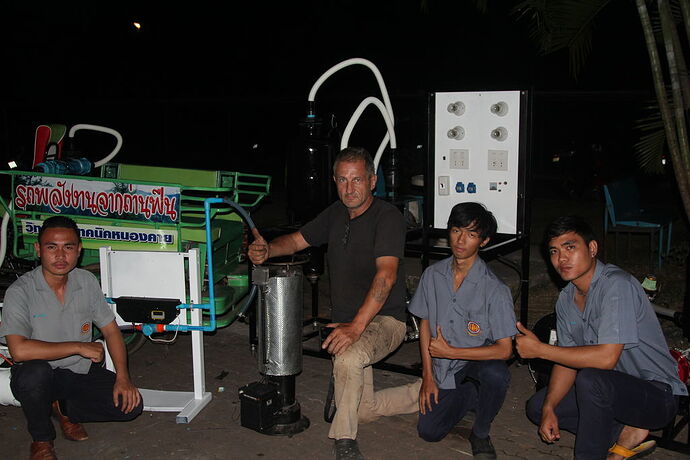

For me its testing before teaching… a kind of “Mythbusting” so to speak.
I look at it as a huge energy balance/scale act…
Putting how much energy in, and how much is the outcome…
Testing that gas in IC engines and trying to adjust, improve…to drive of with it…
Its also an immense fun to walk unpaved roads…
Making a copy of someones work is only half the fun…

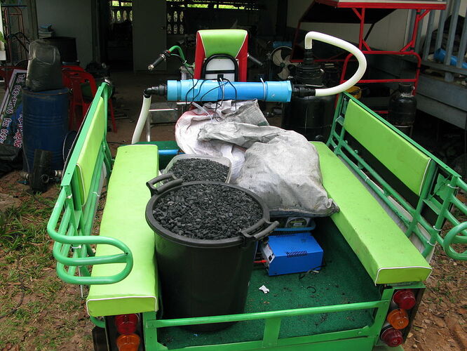

SWEM when making a stop at the gas station :stuck_out_tongue:
no tank to fill, only charcoal on board…

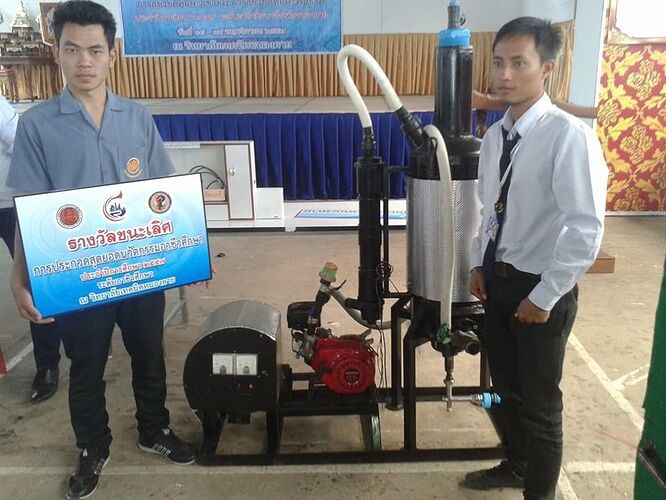

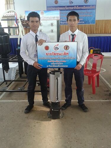

Great performance of the students…
They had to present all by themselves
Provincial contest, submitted 12 projects, did get 8 awarded…
8 projects to go to the next contest level.. one school never had so much spirit…
3 projects with the gasifier are also next level approved :stuck_out_tongue:
also the cooking stove, developed by Mr “Osit” Sitichai is awarded , i will start his idea in a new thread…

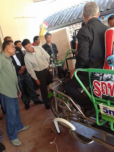

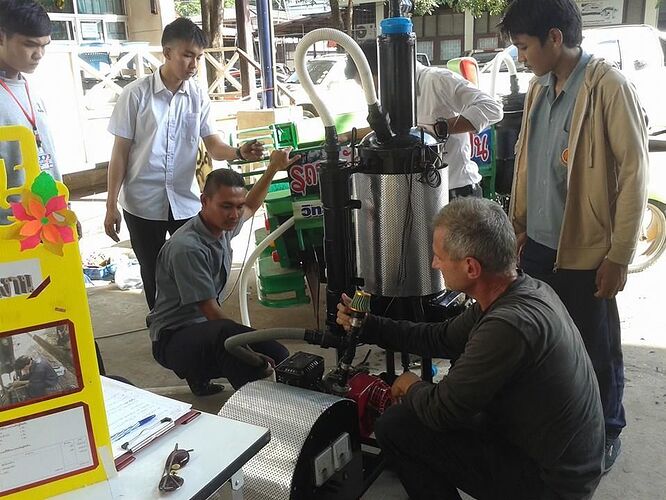

2 more pictures, one students explaining their work towards the director of the college, another the dual starting and running an ic engine

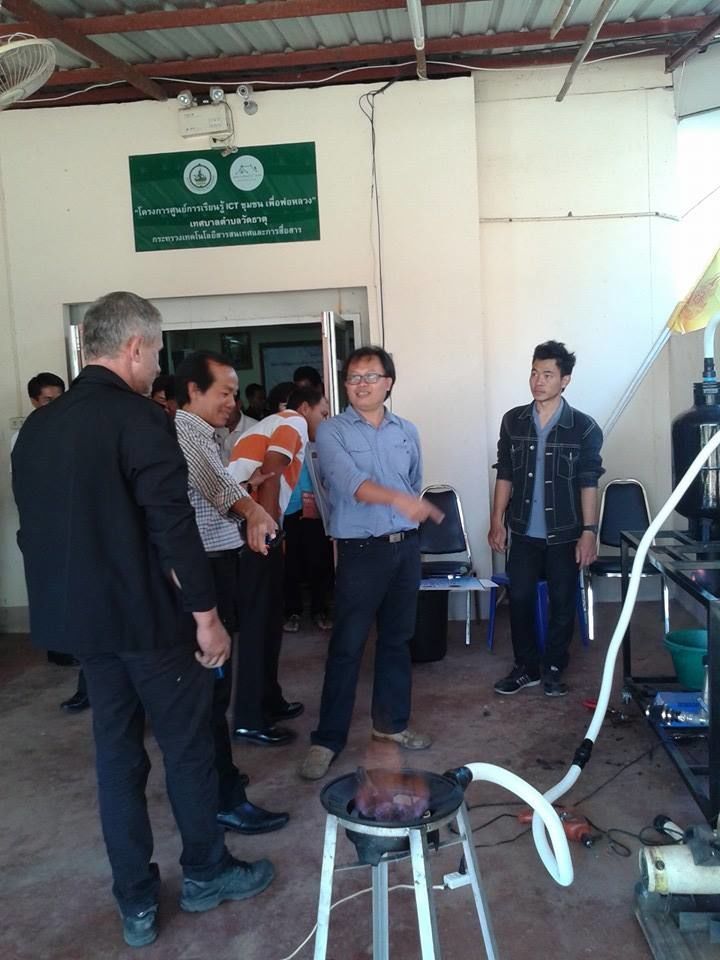

again an unexpected show to do…
chief of provincial department of energy asked us to promote our system to the local comunity
