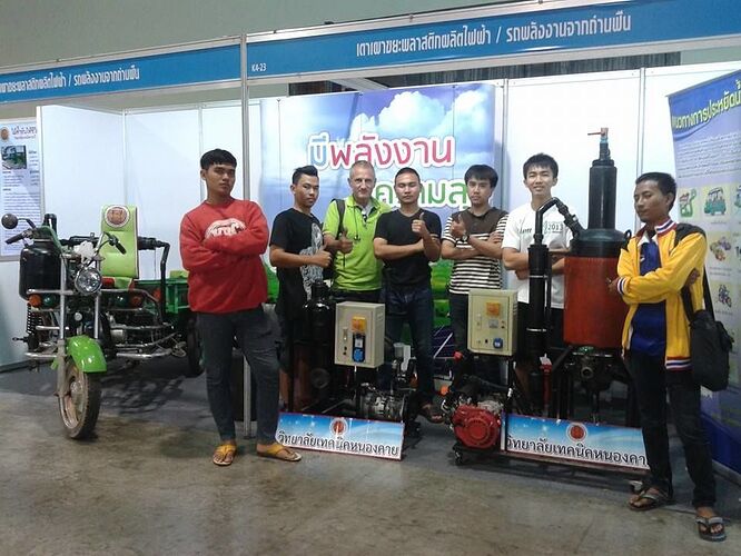

Sorry Koen… but these guys are using your charcoal gasifier reactor or is another design?
These are al mine, build them myself.
