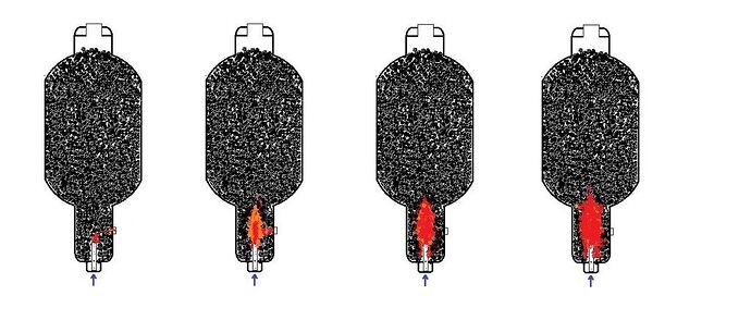

the small section (5 inches) of the base your gasifiers allows it to improve the reduction (+ CO2 = CO)? Compared to the larger section normally used (20-25 inches)
For an old 2litres engine, 20hp, I wanted to use a pipe 7 by 24 inches to base.
What do you think?

The 7 inch pipe would be a little to small for the 20 Hp, it will get glowing at full power.
Make sure you give it room to breathe
Meaning that the air must be passing the charcoal bed without to much effort.

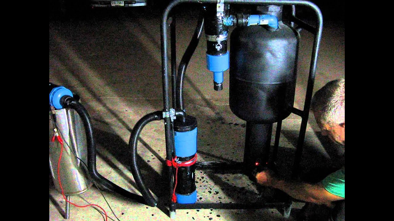

hi Koen
I would like to test on my two-liter engine, a generator with small nozzles verticals like you are building (ceramic nozzles for high speed 25 m / sec gas. And over) my concern for an engine 20hp 2-liter the nozzle would be 20 mm minimum diameter and I fear that the coal from clogging. What do you think of using 3 or 4 nozzles 10mm diameter installed side by side instead of one big one?
The small diameter nozzles you use to 25 meters / sec minimum they will create significant pressure loss?
The verticals nozzle clogging they sometimes small coal?

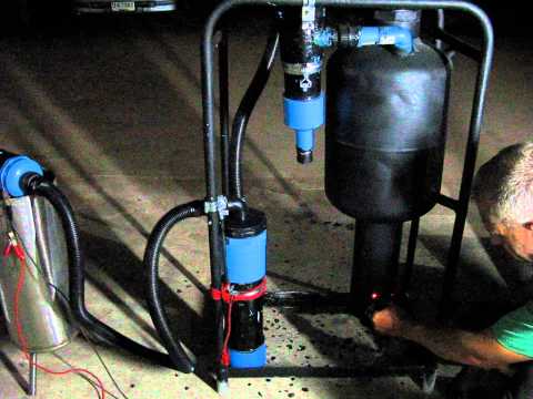

Hi Thierry,
The multi nozzle is a working solution.
I prevent clogging with a rod inserted when i shut down or just to poke the nozzle sometimes

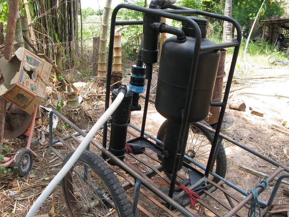

rebuilding the filters, first stage to be cyclone…

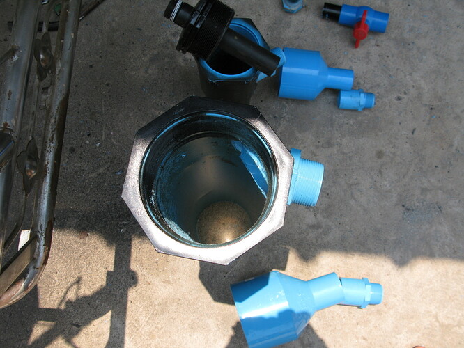

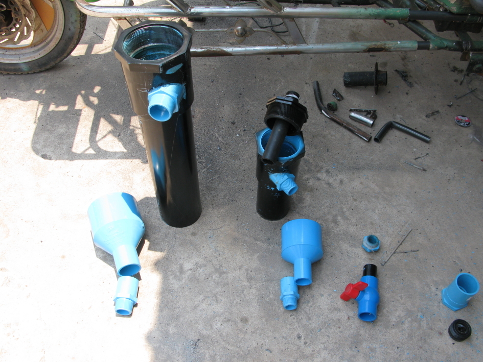

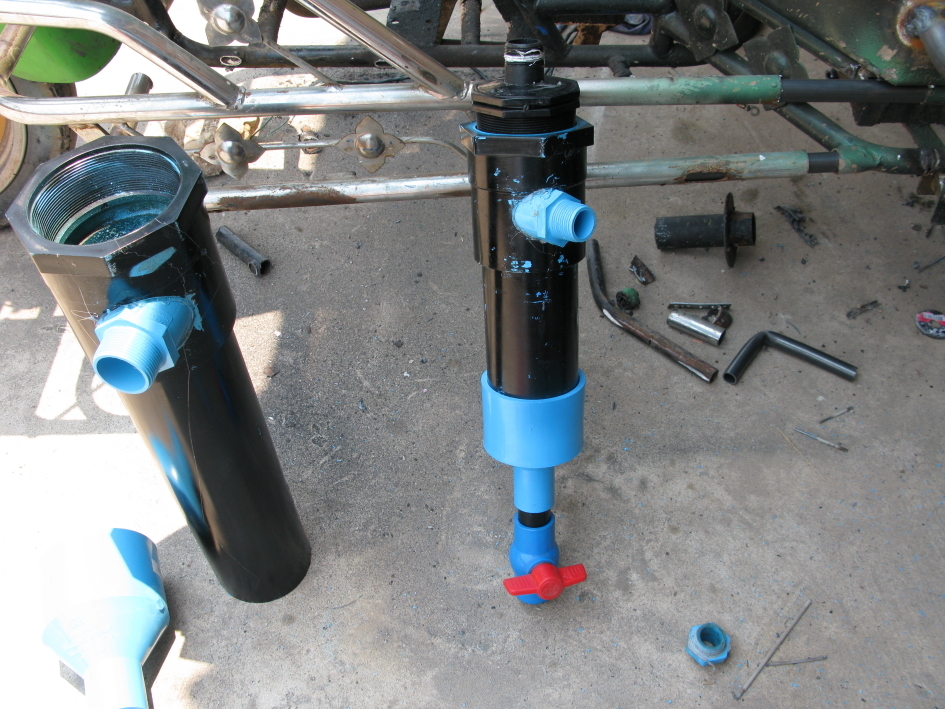

The positive effect of the low temperature allows the use of plastic ![]()
changing the way i can replace the nozzles…

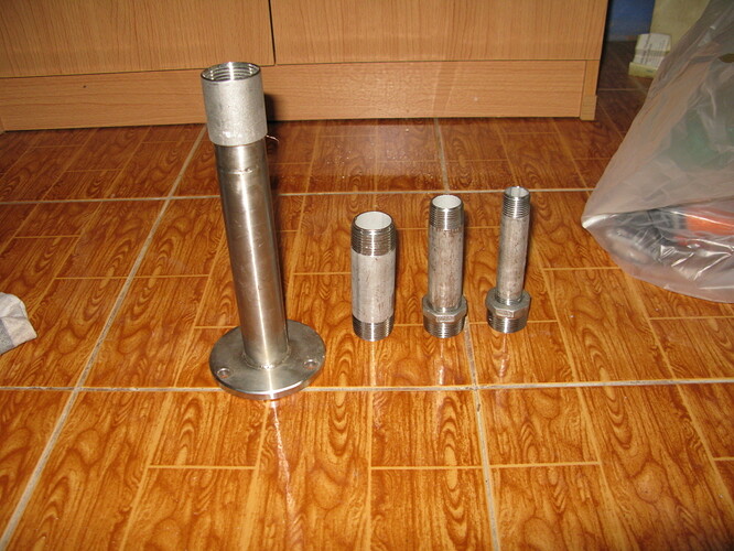

Standard pipe = 1"
reducing with adapters as desired
Also can mount the ceramic nozzles or the TIG cups
In the picture with stainless piping as nozzles 1"-3/4" and 1/2"
Have to cut them at length

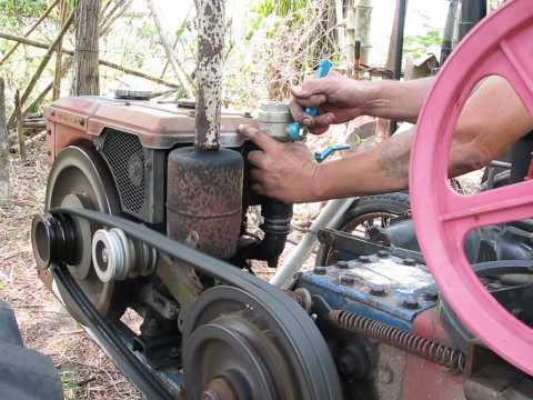

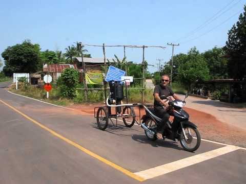

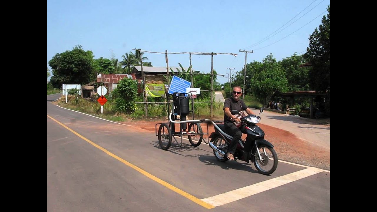

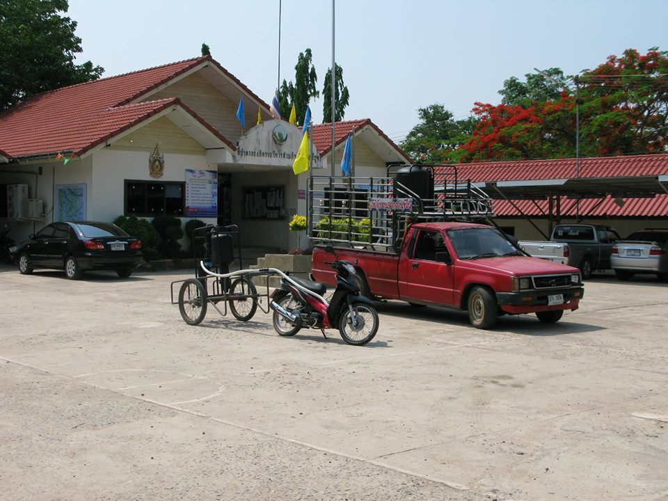

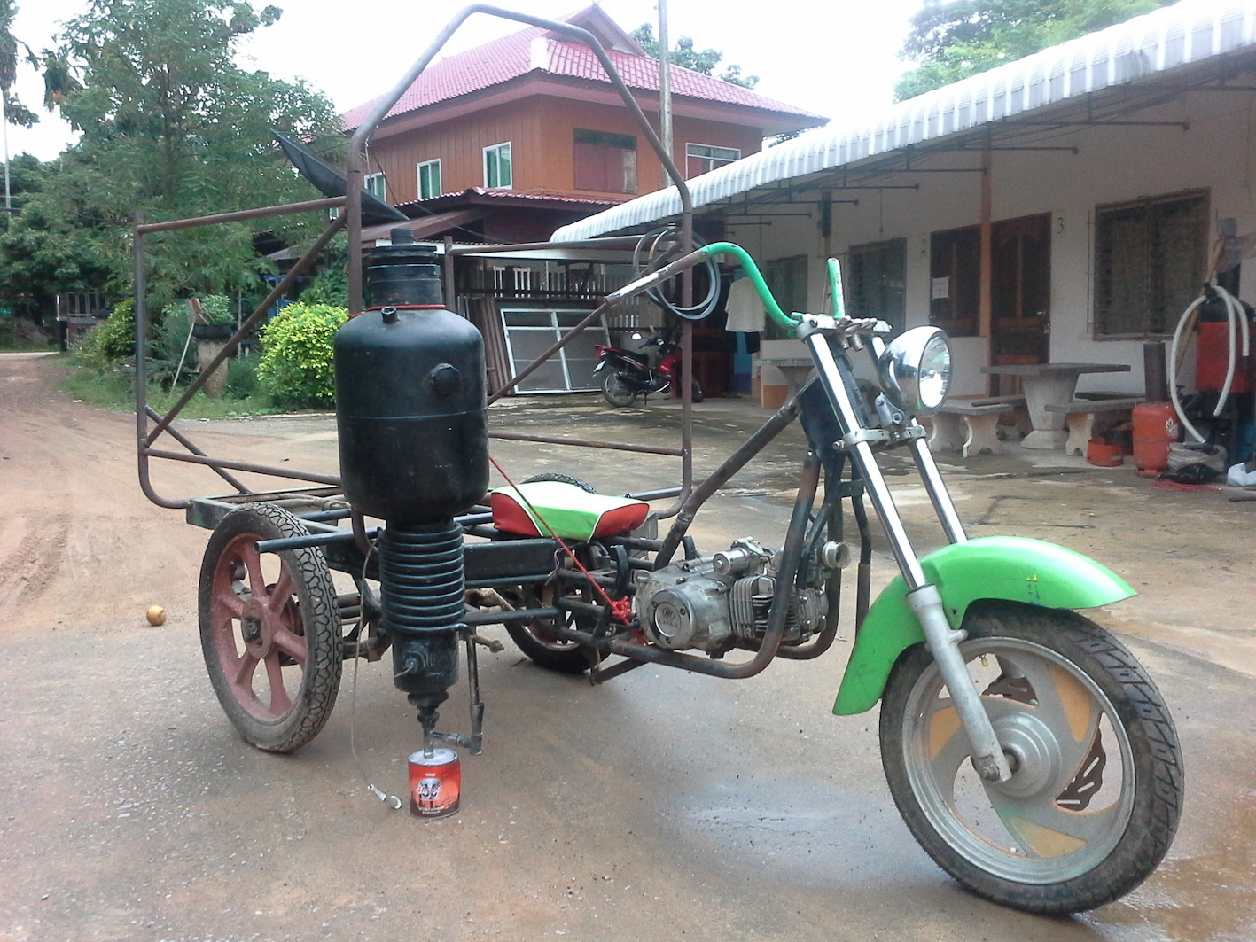

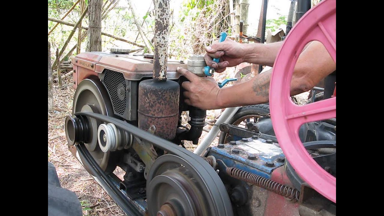

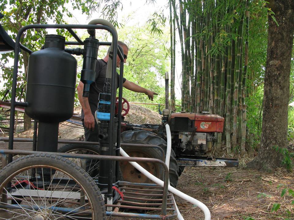

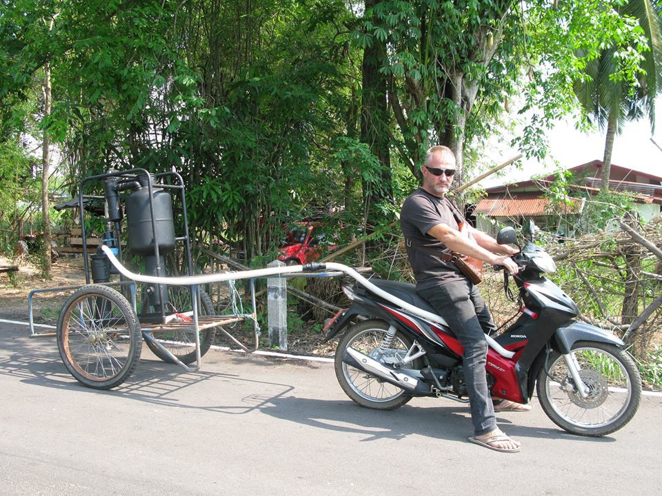

Modified the fuel injected bike of my wife,
Show in the village, next to the pickup

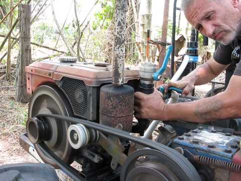

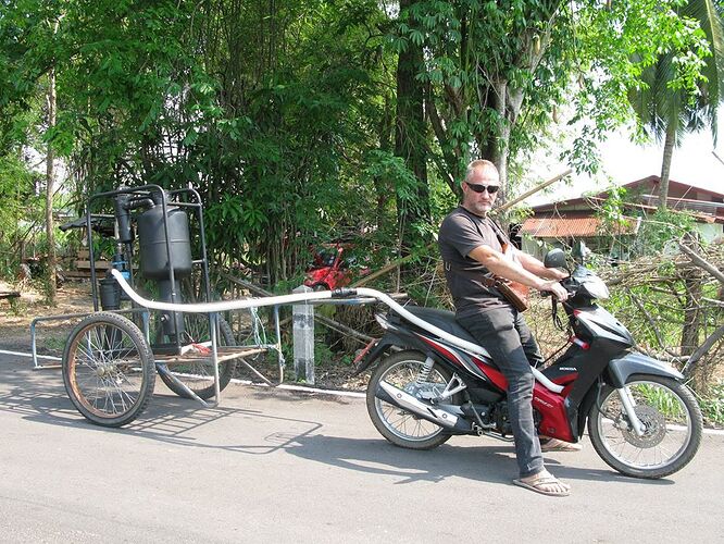

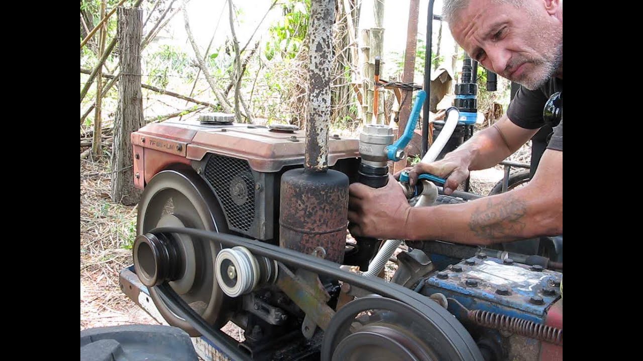

Powering a small diesel engine from the Thai tractor
fun around,
videos coming up
Also some more pictures at facebook.com/renewableenergythailand

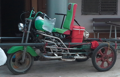

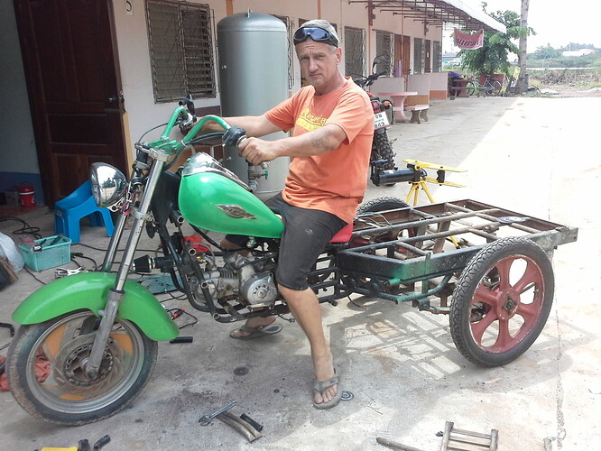

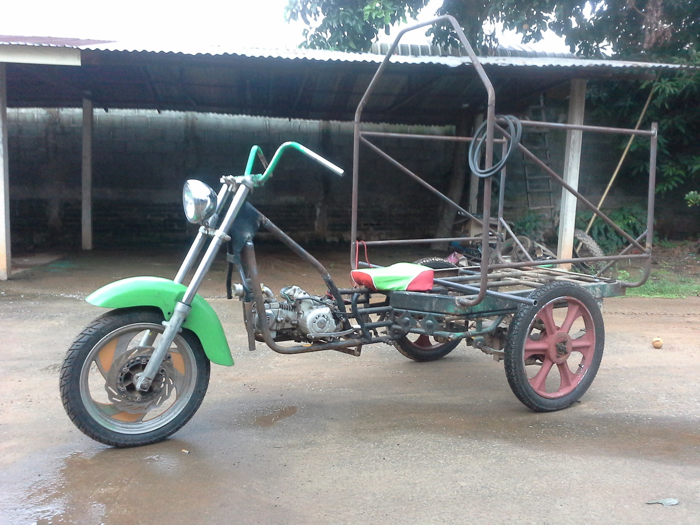

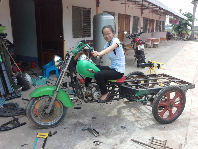

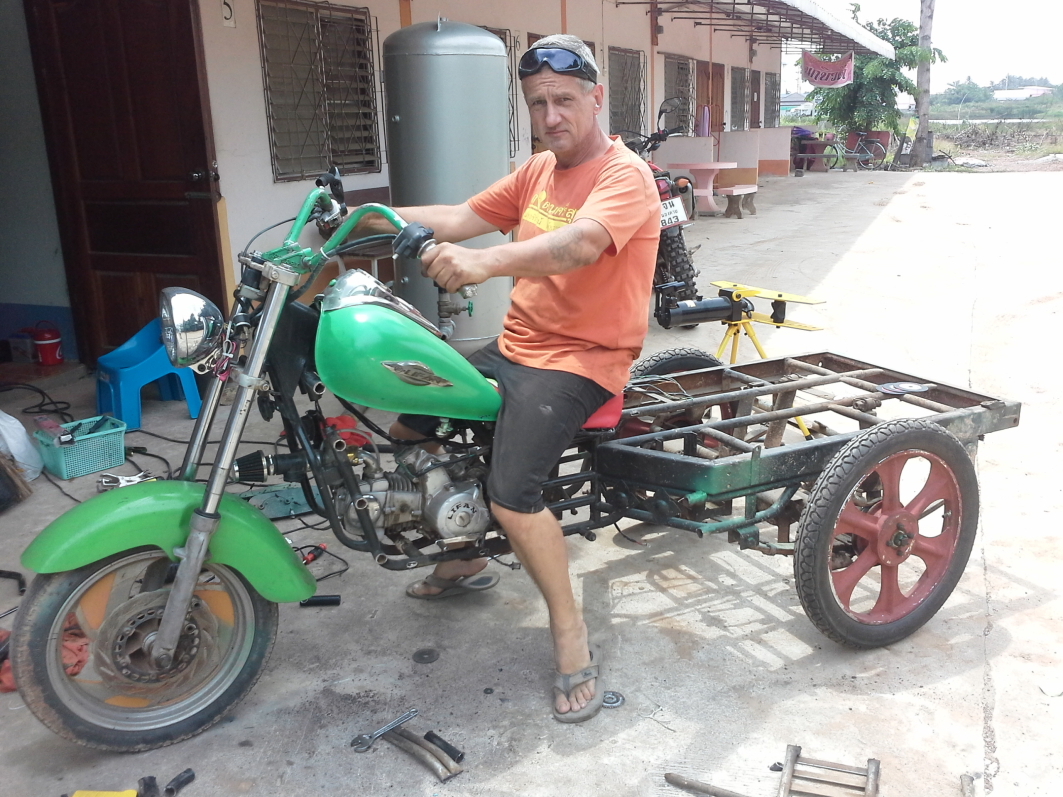

Working on my Low rider again… Taking time off…
Next week starting on a new location- workshop, want to drive this little fella
The last picture was before the modifications, ball head, seat level
Will keep it “naked” without the shiny bars , just a simple low rider
I really like the low rider! Could convert that into a motor home.
