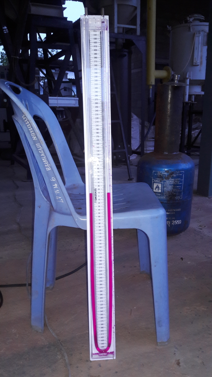

I would like to know the order of magnitude of depression of a gasifier the engine intake?
How H2O ", and cyclone gasifier and filter?
Thierry thank you.
Hi Thierry,
I hope i understand correct: you mean the vacuum from the engine and all parts ?
Up to now, i build them as “easy breathers” so low pressure drops for the small engines.

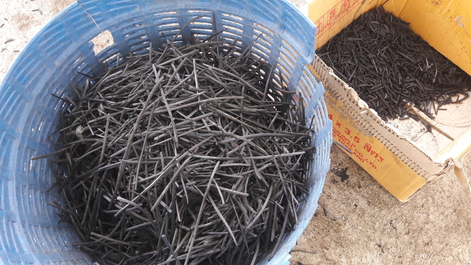

The use of small, soft charcoal , helps a lot to keep it “easy going”

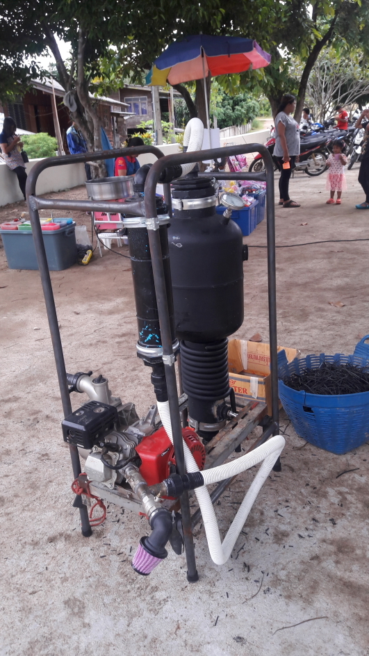

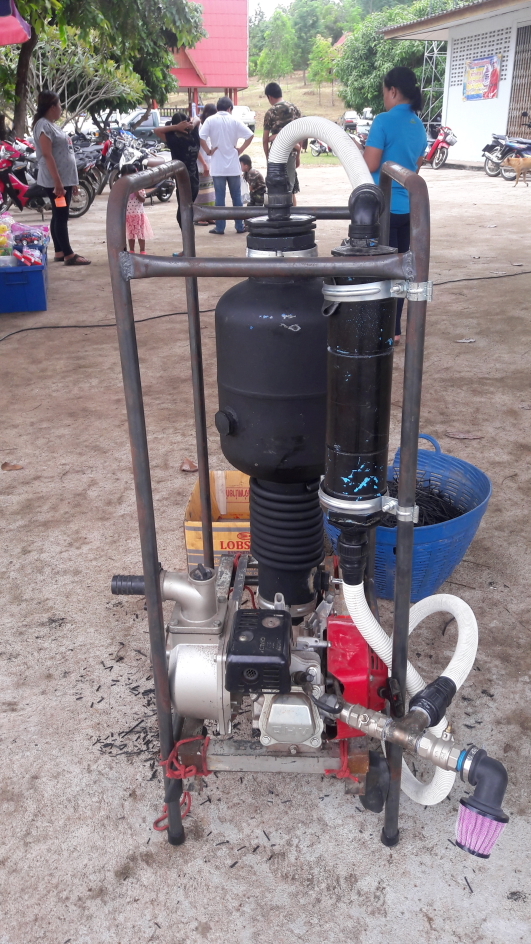

No , this is a downdraft gasifier for raw bamboo

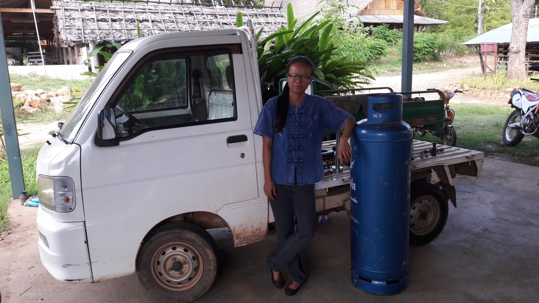

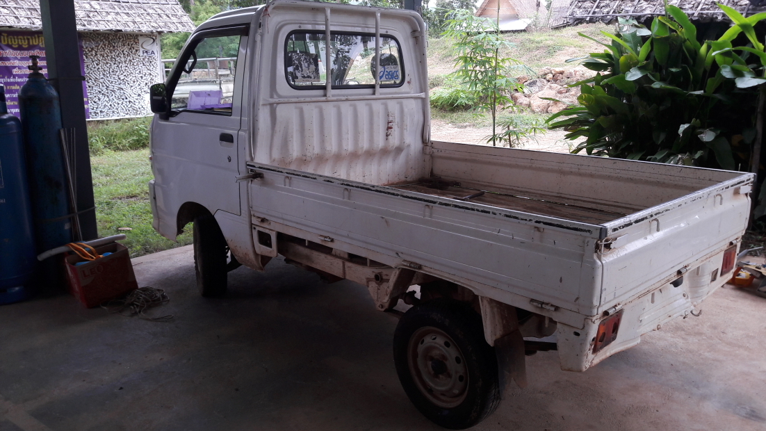

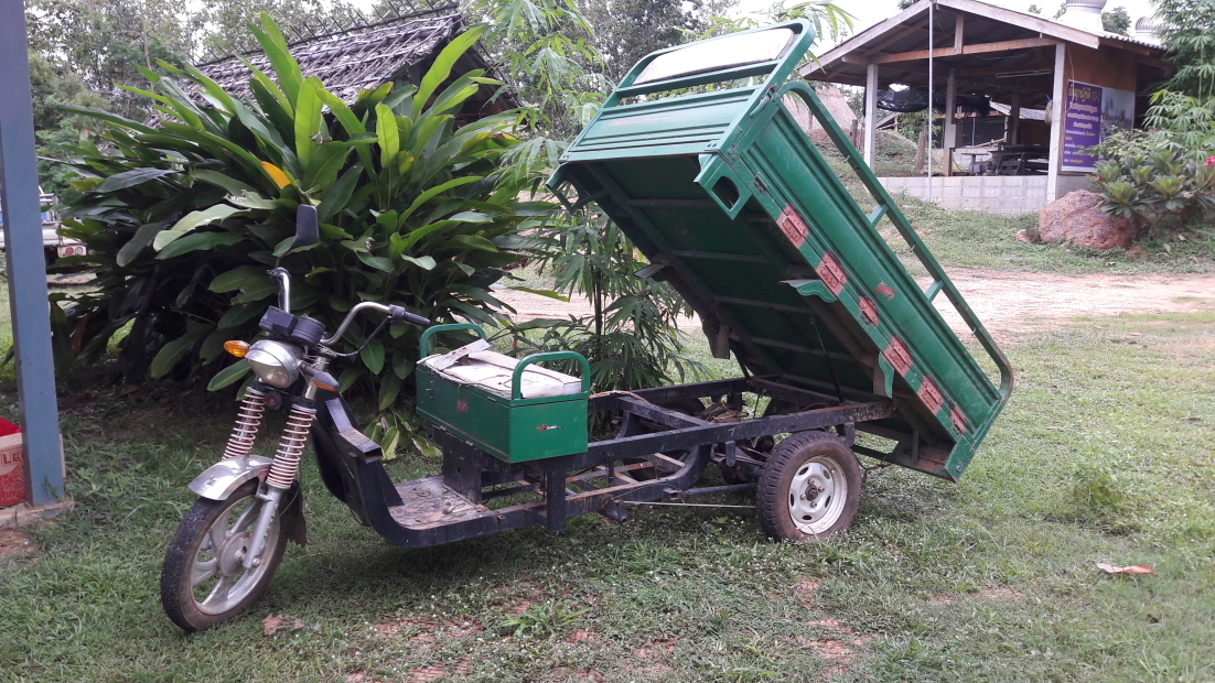

Two more little projects to build a gasifier with.

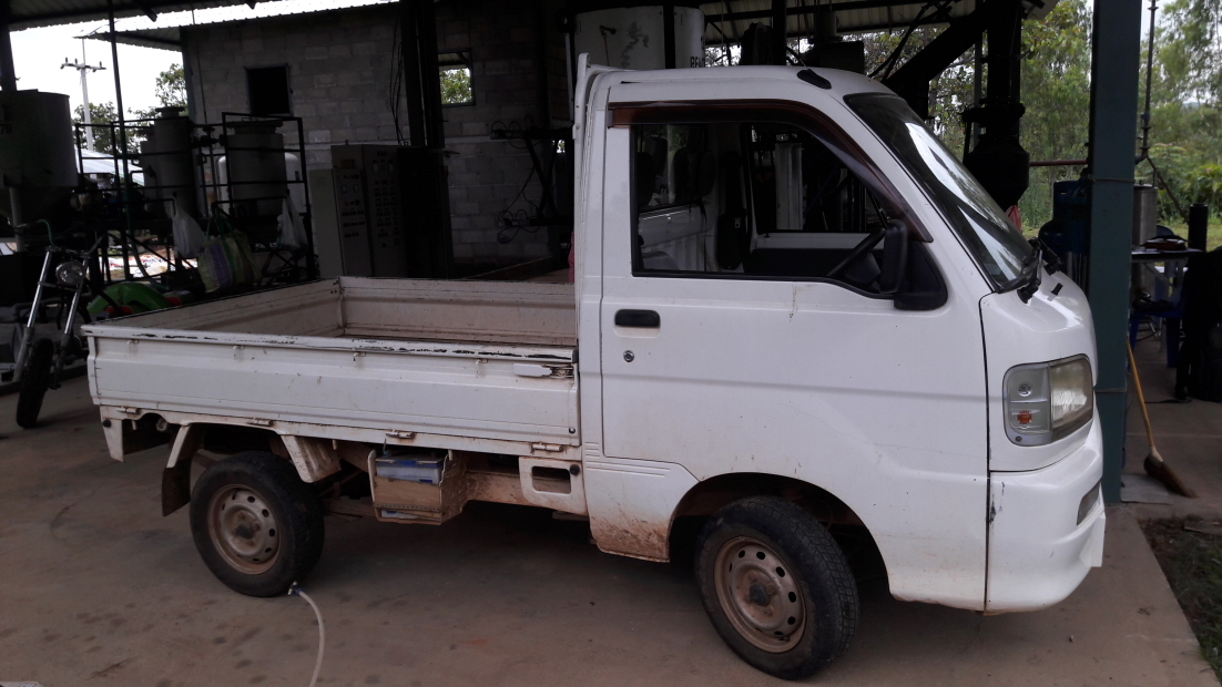

The white little pickup is a “Tuk Tuk” with a 3 cylinder 659cc gasoline engine. It has a EFI ![]()
The green trike is an electric driven, need to build it with gasifier-engine-pmg to battery charge and drive.
That is the neatest little truck i never seen one like,or the trike EITHER.This will really be interesteing,perfect for the charco crowd you have,Thanks for posting,i will be watching too,nice doners vehicles.
I’d love to have one of those trucks
a little to big to take in the carry on luggage… but might be suited for the check inn ?

You know the compression ratio of the engine of your truck?
It is a small-displacement engine and a square.
You do not miss crainds power?
Arvid.
Small suzuki carry Used in Quebec are imported “importation Ecoboat”
Phone: 819/729/3450
Thierry,
The engine is a 3 cyl , EFI , 598 cc, Daihatsu
Common used in Thailand Tuk Tuk and Japanese little trucks
CR = 9,5, Bore 68mm Stroke 60mm
On gasoline it should have 43 Hp @5900 rpm
I don’t need the power, i just need it run and move the car with some reserve power…

Nice comparison on the truck sizeing,how fast them trucks drive on regular basis.Looks about like the ones the deer hunters use trail rideing,and they go about 25 mph.The tires look a little bigger than the trail wagon transit.
