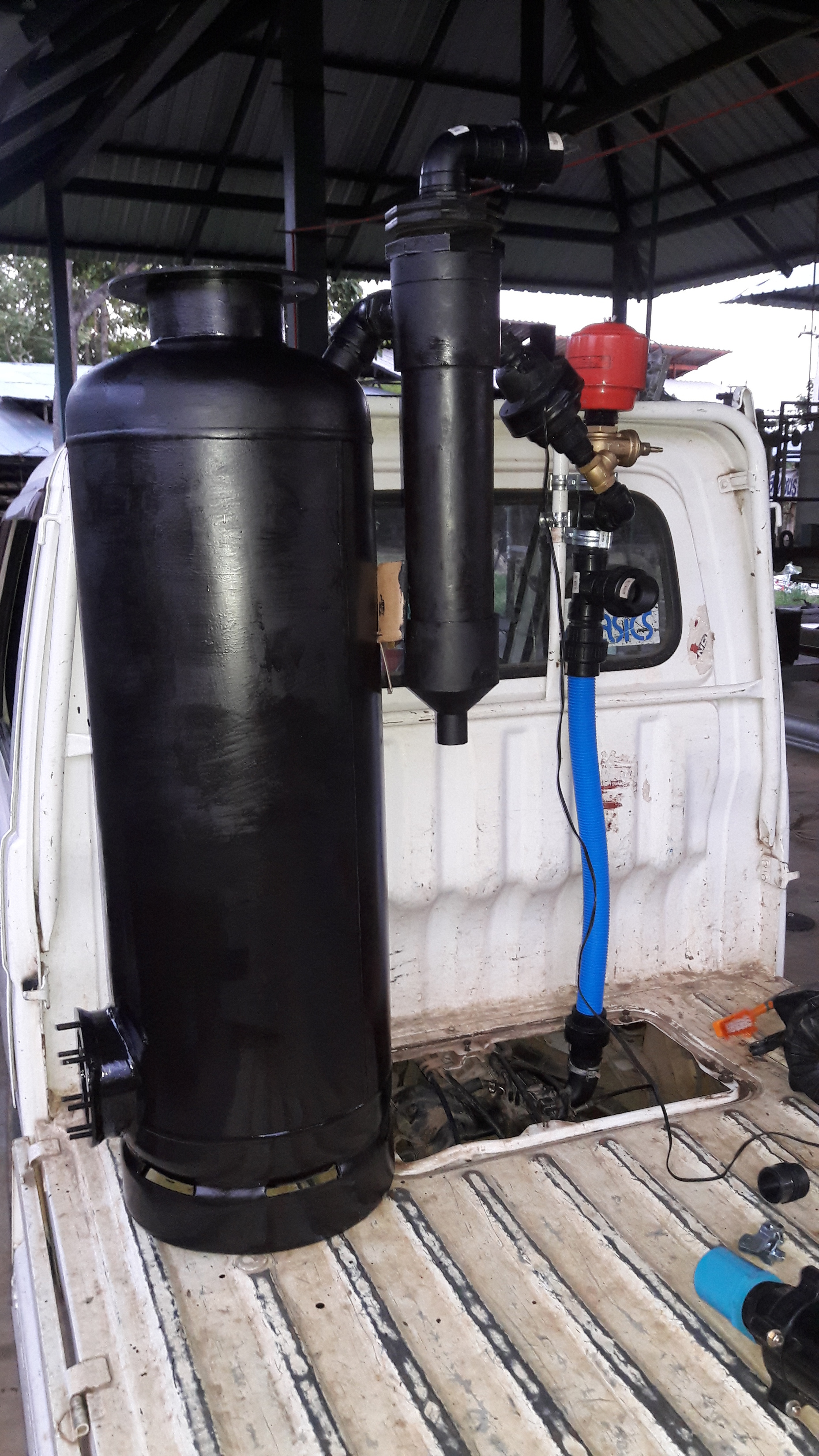

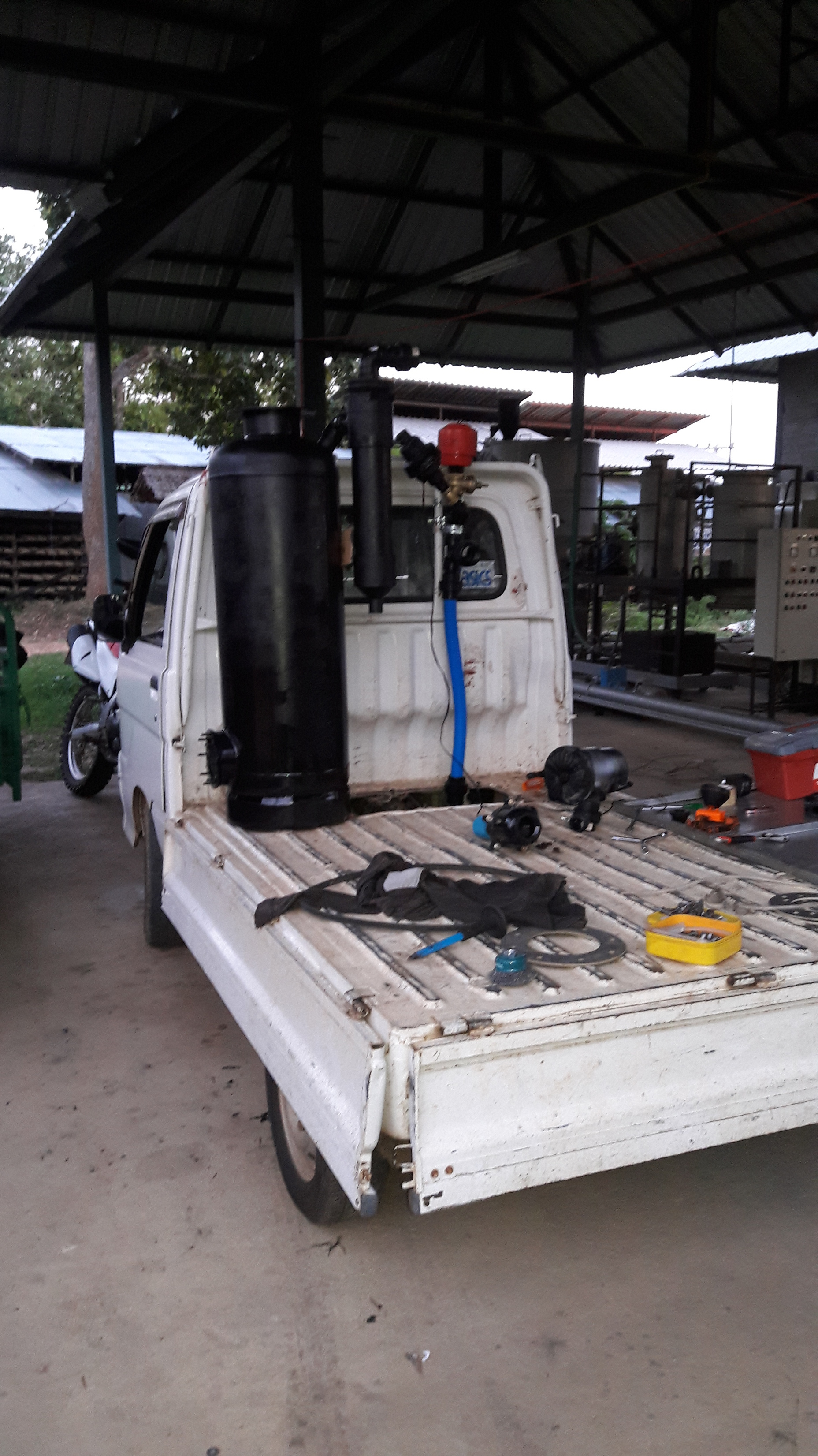

tested the speed on gasoline today, did get up to 120 Km /hr
Not to forget, it does has 43 Hp for the tiny size …

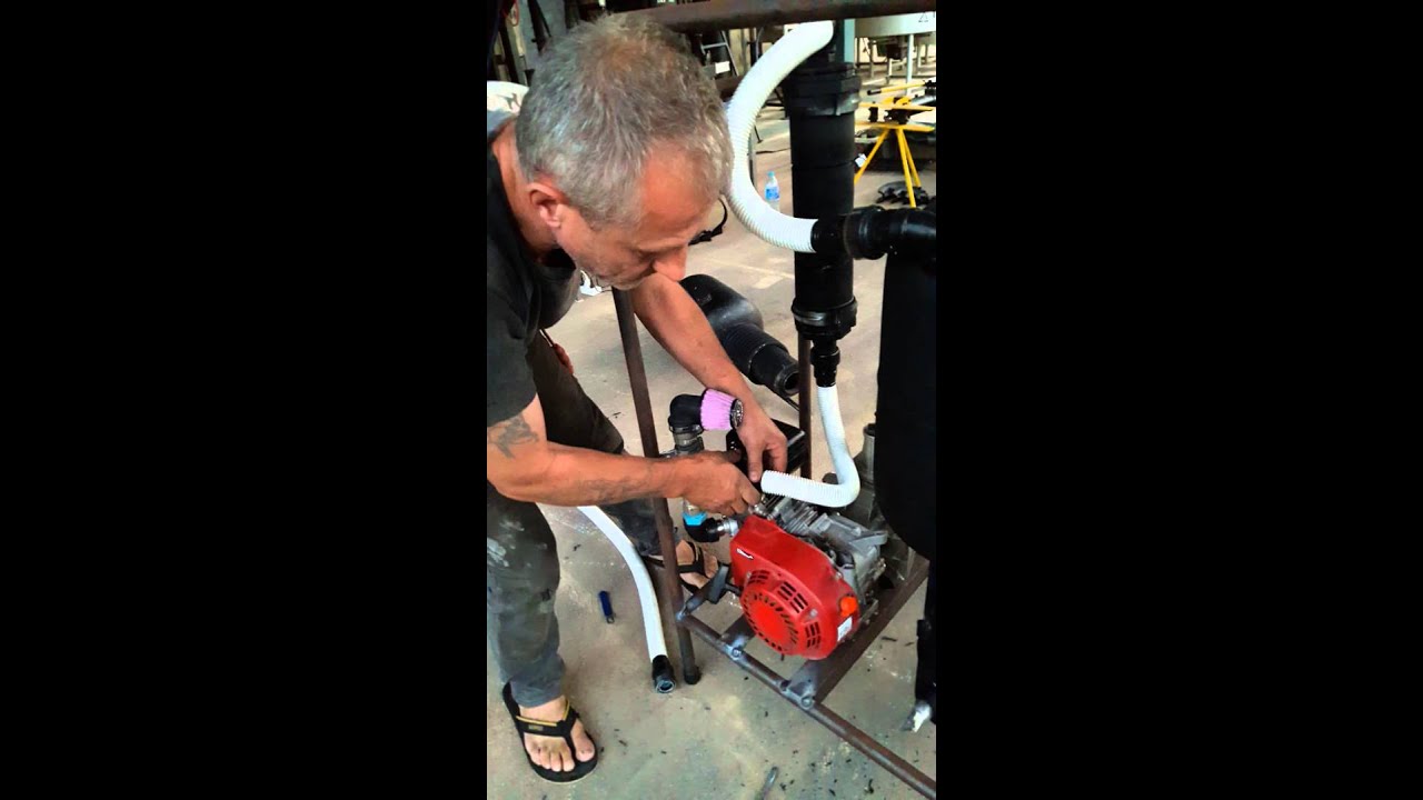

Another waterpump gasifier ready…
This should be the training - teaching module for the locals of my new working place…

Extra nice… Is it OK to run the water pump dry?

No the pumps require water to protect the water seal between engine and pump, i lubricated them with teflon grease

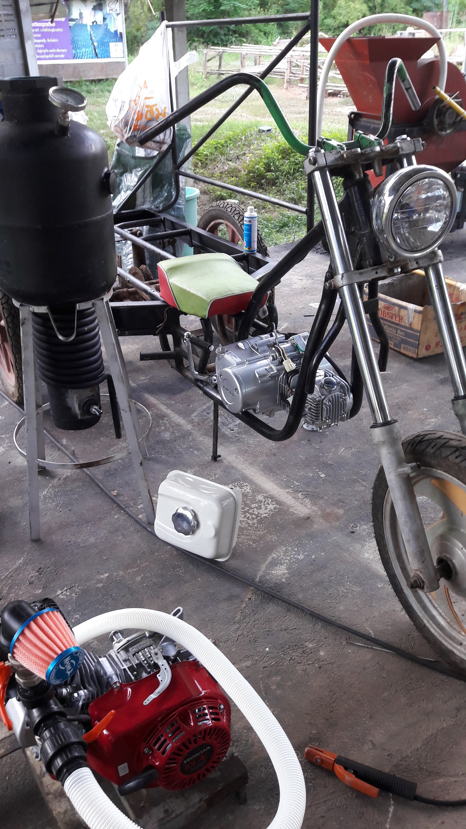

Making new sets to run soon…
Also the trike is getting his parts… new engine on board… Lifan 125 cc
New Honda GX200, carburator stripped away and replaced with ball valves…

Looks good Koen. Where is the nozzle on this gassifier, on the side?
hi Don, The nozzle is inserted thru the lid of the cleaning port at the bottom side, but points upwards.
Hi Koen Van L when you pulled on the pump motor,it reminded me when i put an HHO gas hose too a 5 horse briggs off a wallmart bag of HHO ,when i pulled the rope the bag went off,thought i was going deaf fore a while, I could hear the drywall screaching in the shop, it eventualy stoped ringing my ears after about few mounths, torn ear drum indeed.That was kind of stupid when i was supposed too have the gas in a ballon too help prevent flashback.
