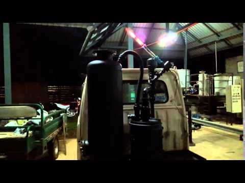

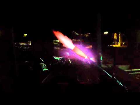

and the gasifier is alive …
Have not started the engine on the gas…
But it has to be on show for the province governor on Tuesday… also 2 more gasifiers…
and it seems the Governor wants to testdrive himself…
Cleaning up and adjusting to do

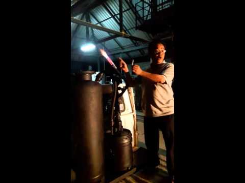

Today i had the governor as a visitor… with him about 70 other “important” persons…
All district mayors, province major and so on present…
Anyhow… he did take the Tuk tuk for a ride… i was on the back… he was happy, i am still alive…
i have the movie on my FB but can’t post the link here…
some picture i have to
