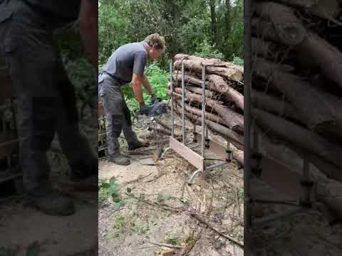

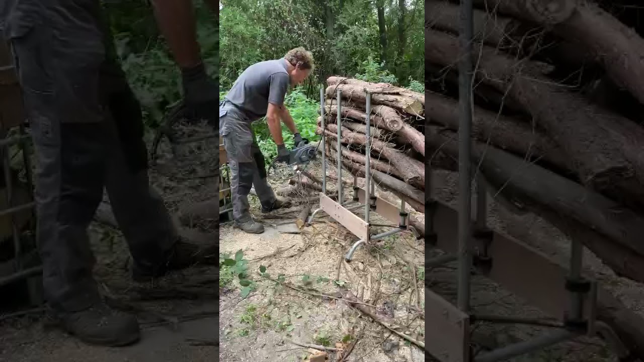

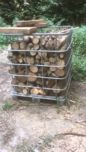

Conifer, cut it in less then two hours. Me cutting with the powerpack, nice and quite. The middle one playing with the agria tractor to get the wood to the saw. There wasnt more time available, but things are coming together now. Efficiency instead of running like a fool (the last fits me better)

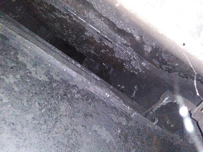

Not sure if you can make heads or tails of this picture but here’s my damper. It has different settings but I’m not sure if it’s meant to be closed for non use and wide open for use or actually tuned in?
It’s a pretty small opening so I would think leaving it open is plenty fine when using. The handle has a hole so that leads me to believe you’re SUPPOSED to adjust with your poker or a separate tool when the fire is going.

Oh. Dampener OPEN all of the way when firing. Control your fife with your size splitting and always three pieces laying. You gaps gasses velocity and radiant heat support for clean combustion.

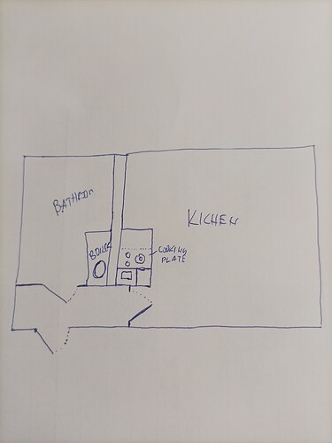

When l designed my stove l placed it at the wery center of the house. Every room, including bathroom, has one part of its wall actualy being the stove. So the walls heat my house :smile: a few tons of brick acumulate the heat for a long time and the masive chimney runs trugh the bedroom and radiates heat all night.
Hope you guys get the idea… I wanted to make things as simple as possible. No pumps, thermostats, radiators… Just a few smoke haches to controll what heat is wanted where, oven, hot plate, bypass chimney, intake air…
Initialy l thod l wuld need a thermostat operated hach for hot water boiler as its a natural draft smoke-trugh boiler, but it has shown that its not nessesery at all. It seems to pull just enaugh heat on its self for our needs and it never overheated in almost a year of use, even thugh the stove burns 24/7
Great engineering and design work you have done, this is the KISS at it’s best. I like it very much. Are you going to draw up detailed plans on this design?
Bob, lm afraid my paper drawing skills dont mach the drawing skills of my head. I can try if there is strict interest, otherwise l preffer to make a video :grin:
