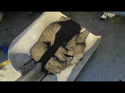

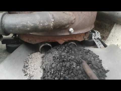

Since I’ve been running rather high vacuum this last week and I haven’t emptied the dump for more than 1000 miles I thought it was time.
The video shows clearly that the left dump cap has been leaking air in. After filming this I went for a 20 min ride and the right hand side of the dump was hot to the touch, as it should be when empty. However the left hand side was completly cold. This suggests I have an ash bridge in there, since I didn’t get anything out. The gas passage is probably blocked on that side. When it cools down I’ll stick a wire in there and bust things loose.

I just got in from scratching down the ash cavity. I augered out another showel of only white ash this time.
I think since the gas outlet is to the left, most of the slipped char and fines blow that way and piles up. An airleak in the left cap then turned most of it to ash.
Solution: More silicone on the threads and then I may have to empty the dump a bit more often. Especially the left side.
