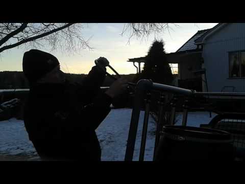

I was pushing Kristijan for an update yesterday and today I realised I haven’t made one myself in a while.
I didn’t have any arrends to run and the weather was nice so I decided to go for a ride just for fun. I went up the mountains and visited lake areas where I haven’t been for a long time.
When I got home I decided to wash out the coolers, while the condensation tank was warmed up and not frozen. I haven’t done that for a couple of months.
Weren’t you worried parking the truck on that slope that the water running out would cause ice in the snow, and your front wheel drive would just spin.? Are you making a statement with a “white” house? I thought everything was painted that rusty red color. Sure good to see someone driving in this winter weather. I feel like a dunce. I have gone out to the shop a few times, but I am stuck at getting the old gasifier apart and I get discouraged very quickly in the cold. TomC
Are those electrical water tight EMT elbows on your cooling rack? You had the nuts loosened before the video so you could just pull them loose?
Don, those are gray 2" sewer pvc. They all come with rubber seals. I use same type all the way up to the motor. No nuts, screws, glue or anything. We have the white pvc too, for fancy visible bathroom/kitchen use, but I like the gray ones better. They are sturdier (and cheaper).

Chris, these rubber seals work pretty much like hydraulic piston seals, only they are placed on the female side. In sewer use the more water pushes on them the tighter they get. Easy on, hard to get off. Not really made for vacuum mode but still tight enough. I pull 40" H2O from time to time and no sign of leaking in. A 2" pipe is 50mm. I went down to 48mm on the cooler for easy on/off. It still seals. They come in 15/30/45/90 degree and 2"/3"/4" dia.

I took my 1 and a half year old son to the hardwere store when l bougt parts for my gas suply. We came to those fittings and he sayd “kocke” (meaning Legos or other toys that assemble). And he is absolutley right! They are Legos for grownups. I love them. They come in all shapes and sizes, and are compattible with other materials. And dirt cheap.
Kids sleeping, work done, animals fed, so l took some time to watch the video in peace over a glass of wine. Pitty, l expected a longer one
thats actualy a compliment. Realy quick procedure. How do you open the bottom of the condense tank?
Allso, has cool weather produced more water in it?
