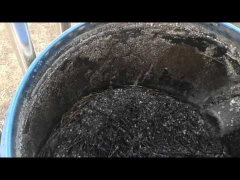

While doing some other maintenace I thought it was time to look down the hayfilter that hasn’t been washed down all winter and several thousand miles.
Jo, looked pretty clean compared to mine with less miles. Your hay looks like what I just put into my filter hopper to replace the old stringy hay.
