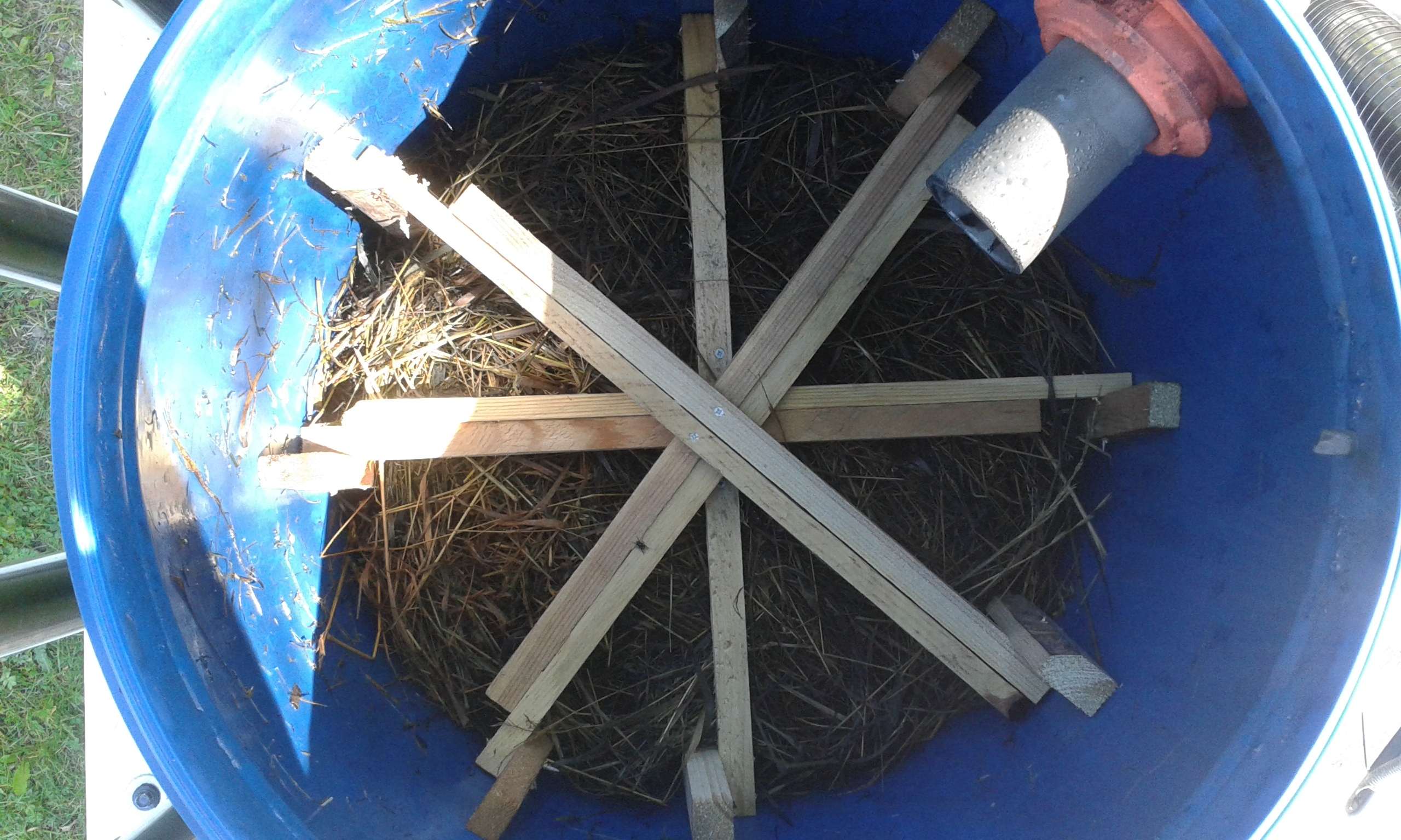

Inverted my lid on the filter barrel (plastic). I left it that way. Next time I got out of the truck the whole barrel had imploded (yes I know Chris did the same thing - I just thought mine was sturdier). It´s now brazed with a crisscross of wodden stickers inside the hay. Seems to work fine. If I can sneek off tomorrow while wife is packing I´ll show you.

Flatened my filter barrel again today. I’ll open up in the morning to see what happened to my crisscross stickers.
