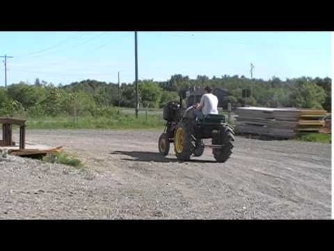

Here is a video of starting the tractor this morning. I would have posted one sooner but, i have to admit I kept screwing up… and was rushing it… not the tractors fault, not the gasifiers fault… my fault… we live we learn.
I keep hearing “i’m in a hurry to get things done” in my head… gotta stop that.
my new favorite song. I see you like to start up using the vacume rather than gasoline too. I also found it easier and faster. looks like a job well done.
Congrats on your tractor build Arvid. I really liked that start up video. Took less time than harnessing up a team of horses.
