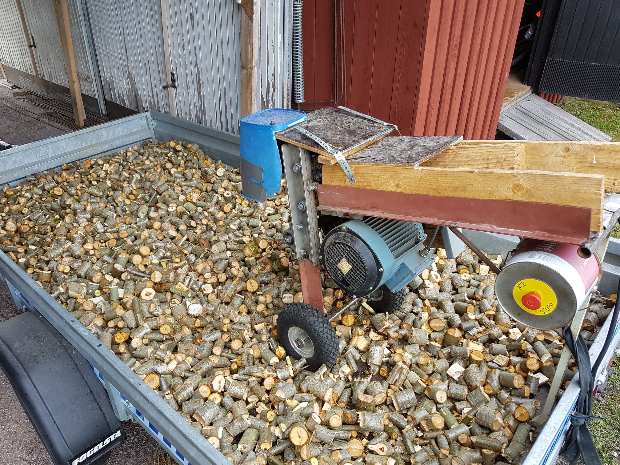

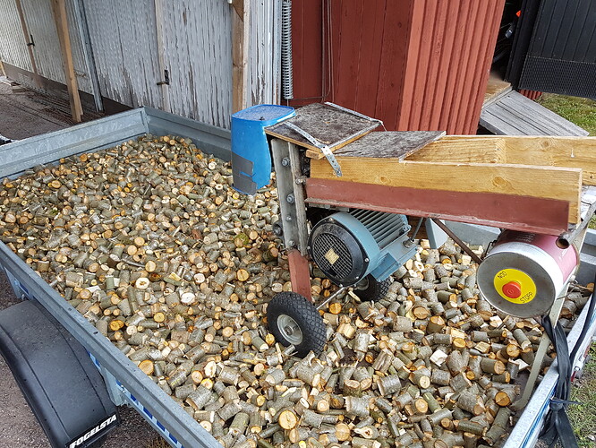

I haven’t done any chunking in over a month. Inspired by @goellie’s chipper video I felt like it was about time.
An hour of wood gathering, 15 minutes of DOWing and another 15 minutes of chunking gave me a small batch of fuel for the truck equivalent to about $150 worth of gasoline.
One and a half hour of work at work gives me a net income of only about a tenth, doesn’t give me free exercise and isn’t nearly as fun.

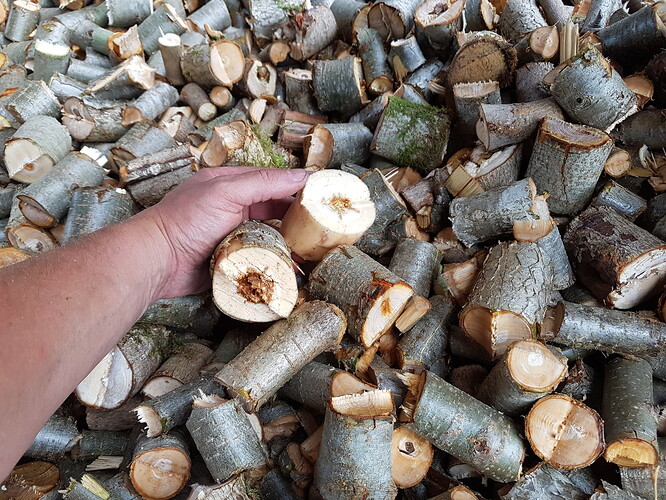

If you’re refering to the wood I chunked it’s a mix of mostly grey alder, mountin ash and different sallow. Even a few maples in that load. I like to save the birch. It grows slowly but is better quality firewood (easier to find customers).

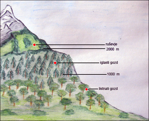

Ha, interasting. Here there is litle to no spruce/pine untill about 3000ft of elevation. We live on 1800ft. Preety much all country looks like this
Its funny, you can judge hill elevation quite accuretely just looking at the hillside. Allso whats interasting is there is usualy a clear transition between conifer/leaf trees.
Due to global warming the boundry gets pushed up thugh, but on the other hand we will likely loose all our conifer due to bark bugs anyways, in maybee 100 years. Unlike many other, l think this is a natural phenomenom. Beech/oak will fill in the space fast.
Edit: haha just noticed the pictures inscription. I guess you get free Slovenian lessons
Haha, we live on 570 feet. Pine trees are getting shorter already at 1,000 feet. Not even mountains reach 1,800 feet around here. You need to go a couple 100 miles west to find those. At 2,600 feet (800m) there are no trees at all.
I’m glad I inspired you
Your chuncker you call it rebak? (is it polish inspired) or is this a common system in Sweden?
nice machine!
Thank you!
Definately Polish/Youtube inspired. I’ve never seen a Swedish one. They seem to use them a lot in all of Eastern Europe though.
I just call them rebak. I don’t know which language that is. @KristijanL might know. In some videos they are called spalicovac, stepcovac and even betok with Russian letters.
Make sure you have several hours off if you start watching those videos. They are very addictive
I am not sure either. All l know is štepkovac means something that does… well… what the Rebak does
the root of the word means to make many identical objects fast.
