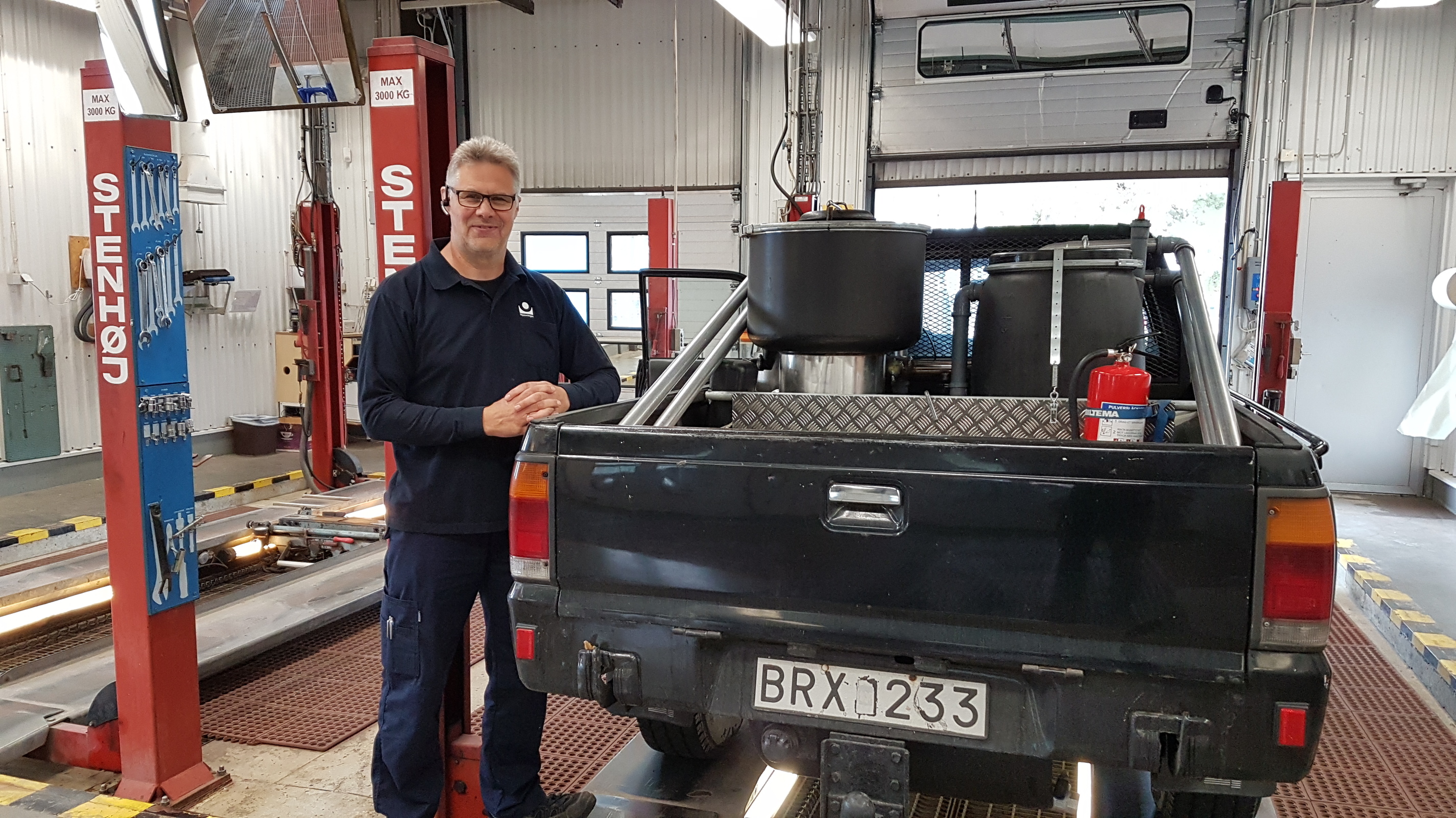

HURRAH!!! Finally! Finito complette! APPROVED! ![]()
Today was the day when the Mazda got legally registered as a gengas vehicle. Ha, after I mentioned “hybriding” is possible the inspector actually put it into the “flexi fuel” category, which has some road tax advantage.
The new curb weight is 4233 lb, which means my whole system weighs 485 lb (incl. fire extinguisher, one bag of wood, some condensate and so on). Still, I would guessed about half.
We worked through the latest 1974 oil crisis documents and checklists. I got only one minor remark which was overlooked - I forgot to bring an ash bucket ![]()

Hey, it just occured to me. As far as l know, this is the first modern fully legal and registrated woodgas vehicle on the site isnt it? I know DJ tryed but gave up, not sure about the legal status of Koens vehicles but everyone else of us sort of drive in the “gray zone” of the law.
Kind of a mile stone dont you think?

Thank you, thank you,
@KristijanL, I belive we had a few short visits on DOW from at least two owners of registered vehicles. Johan L (SWE) and Vesa M (FIN).
I don’t want to steal anyones milestone ![]()
@mggibb, Would you belive me if I told you over 60% of the price of gasoline and diesel is tax here. Equals about $4:50 a gallon of pure tax. On the other hand we don’t have toll roads (except city centers of Stockholm and Gothenburg).
