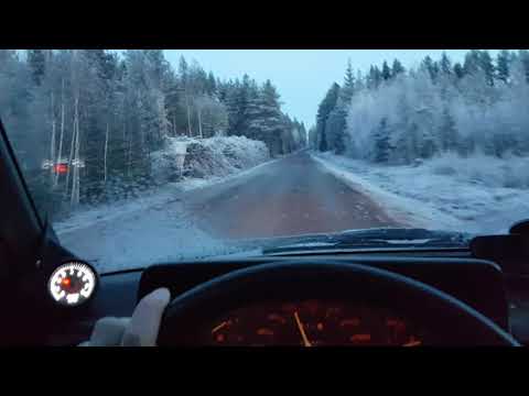

I sort of agree with TomC, there’s not enough DOW on DOW these days. So, I turned the camera on going in to town today.
Apart from having trouble keeping the hopper juice liquid enough to empty it, the gasifier seems handle the -15C just fine.
No snow yet but the cold did a good job squeezing the moisture outof the air. Looks like it all ended up in the trees.
Thanks for the ride JO !
Hi JO, even if you didn’t speak one word, it was a beautiful drive with you this morning. Thanks for sharing it with us.
I notice the large piles of trees along the side of the road. There is so much growth that has to be cut down. Is it just cut down for fire wood?

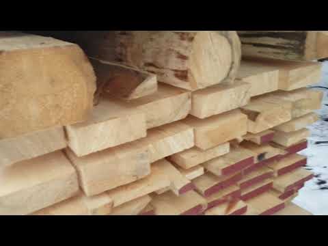

With days off and the truck running as it should again, I’m looking for reasons to DOW. So, I brought the dogs for a ride to check out the lumber I milled this fall.
Great ride. Makes me want to get out in the bush…
Looks like the dogs had a great time.
My brother has a Scottish terrier much like yours, I think he wants help getting in vehicles too.
