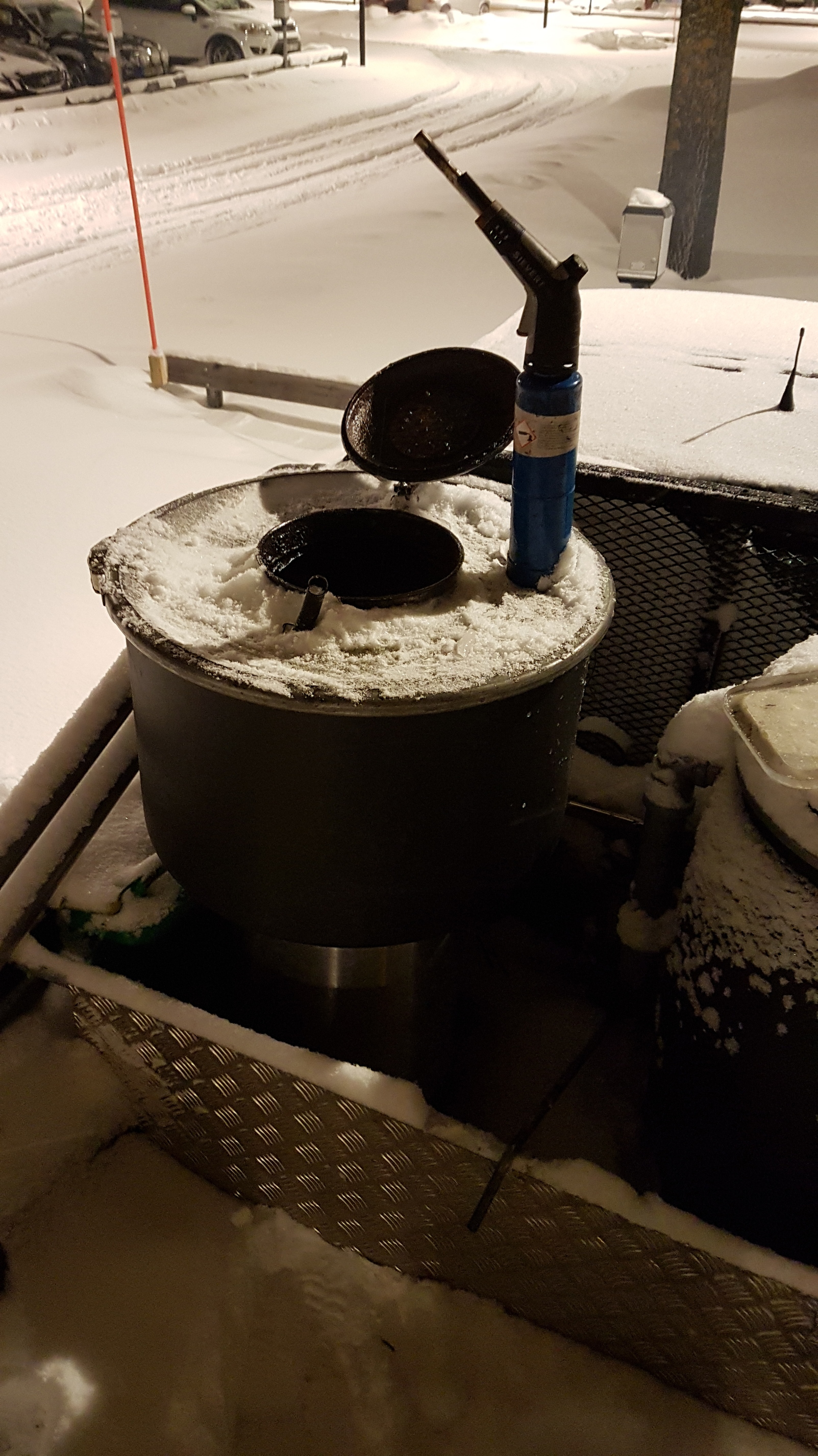

At lightup and DOW home from work this morning it was -22C. Tires and suspension rock hard. Made me think of -40C @taitgarry00 and @TomC , but also of DOW people during WW2 and what they had to endure. Winters of the early 40s were what we call “wolf winters”, with long term below -40C temps.
Avaraging 200 pounds of wood a day for heating and another 20 for transportation. Cost saving eq to about $20 a day.
If I turn the heat up some and go for another ride I should be able to quit work :smile:

A cool hopper allows for condensation and dry wood.
Lightup early morning, going home from work.
