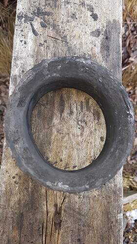

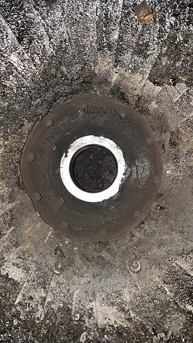

7,000 miles since March last year. I decided to vacuum the gasifier, Leitinger style. I’ve only done that once, in the fall. I have no other way of emptying the dump area and the coarse sandy part of the ash likes to accumulate as a bottom sediment.

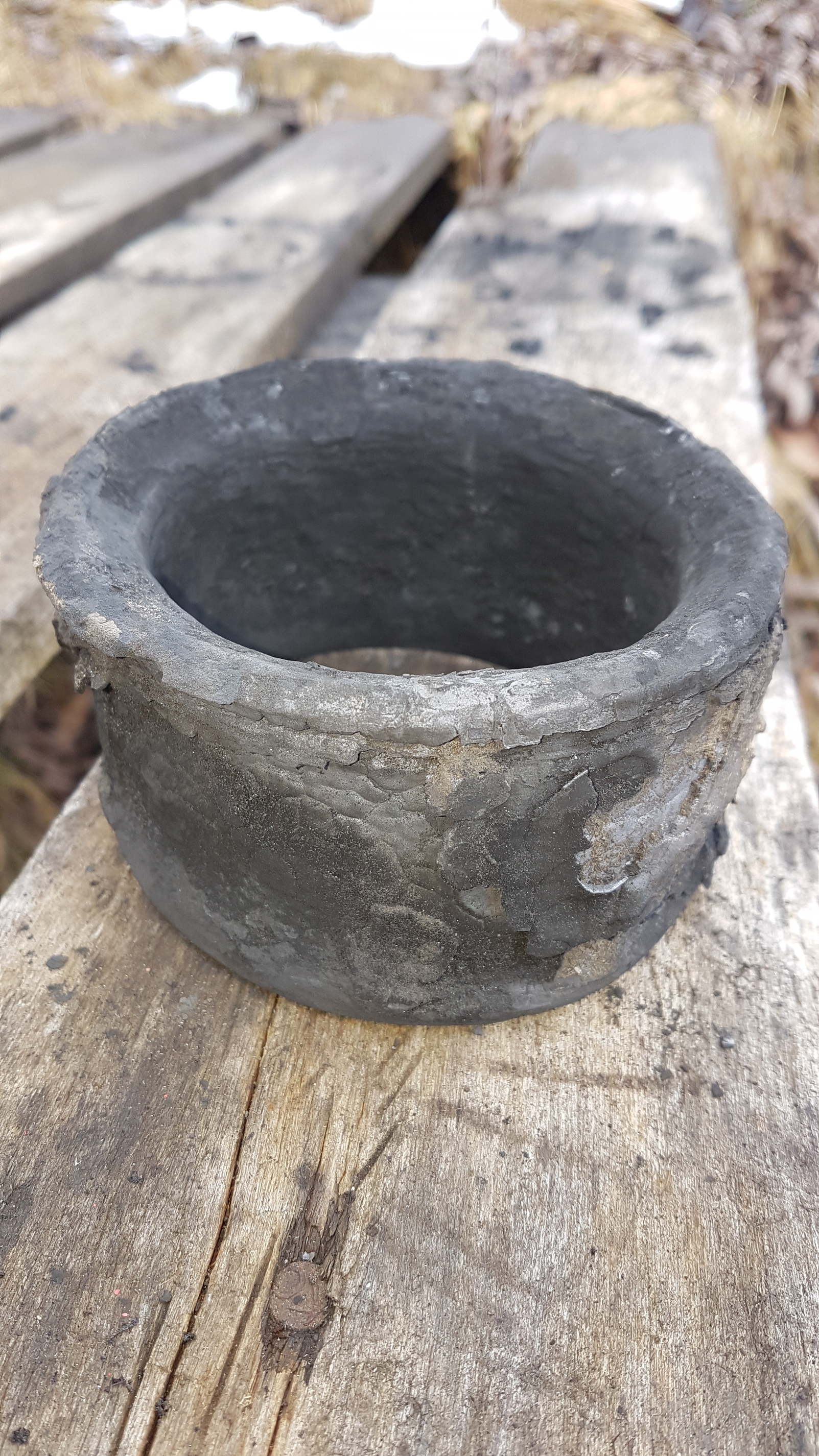

While doing this I discovered my restriction looked funny. Kind of oval shaped. When I touched it, it was loose and about to fall down. It’s a bearing racer and its flange sat on a spacer. The flange is now burned away.
I put a new bearing racer restriction in. 4.5" ID this time. The old one was 4" ID (before it became oval
What’s funny is that the flaky side of the restriction is the outside. Inside is smoth as new ???
No damage to the thin 1/16 ss protective shields around the nozzle area.

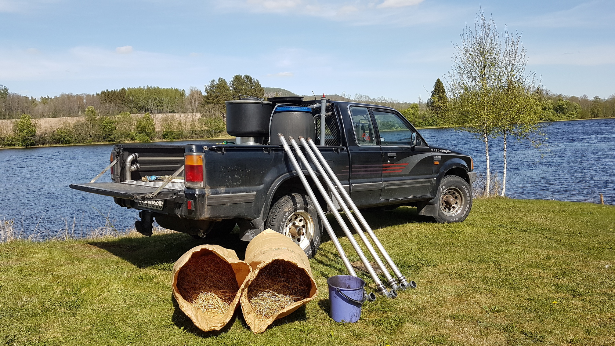

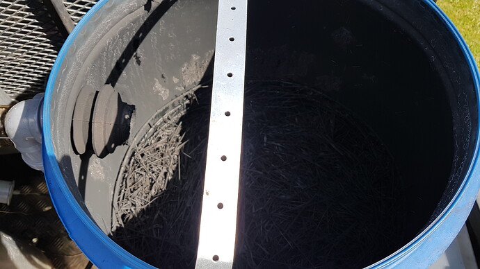

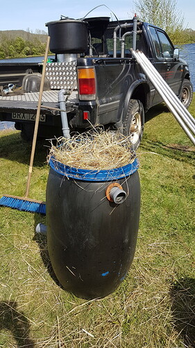

One year and about 6,000 miles since last haychange. Lots of soot in the bottom layer but otherwise the hay still looked healthy after a full year of use.
