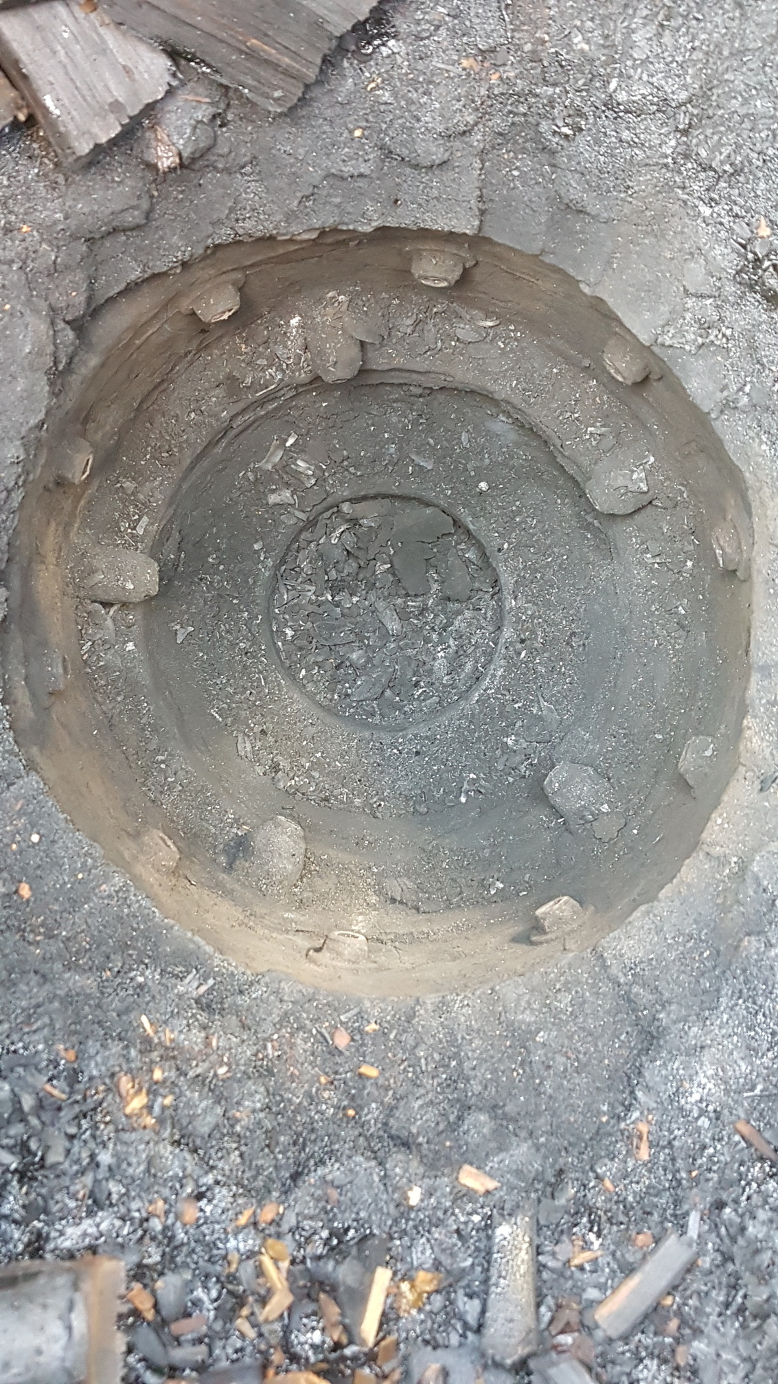

But life goes on and the truck has to be maintained and fed. 8,000 miles inspection of the firetube below and adding to the fuel supply for the upcoming winter.

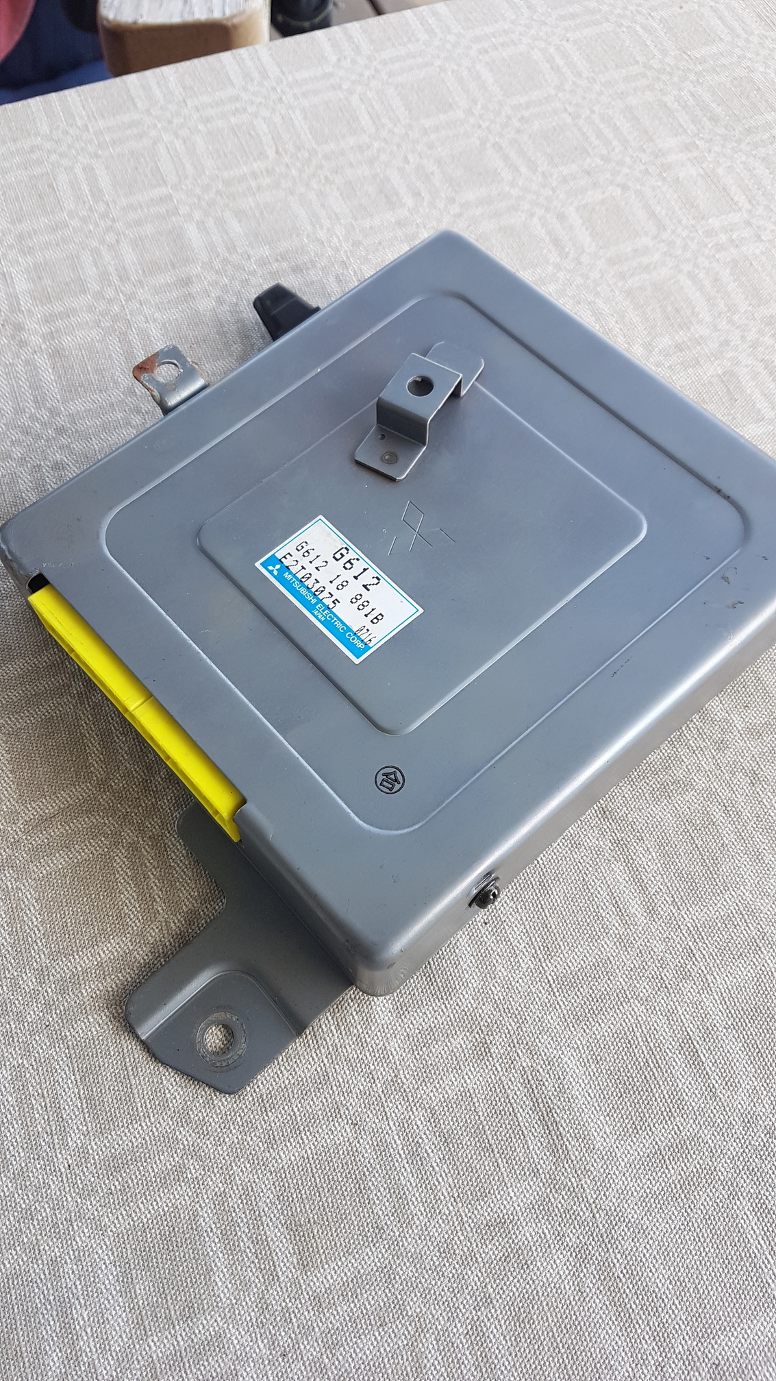

All this time I’ve had problems running 100% gasoline. Lean condition and unable to crank up cold without a adding woodgas, and then suddenly, like flipping a switch, rich condition when the motor is warmed up. I’ve checked every sensor there is, with no luck.
Today I finally got to it. I swapped computer box with my junk Mazda. SUCCESS
The truck runs as it should again.
Lets just hope I don’t get lazy and start running gasoline again, now that it’s possible ![]()
