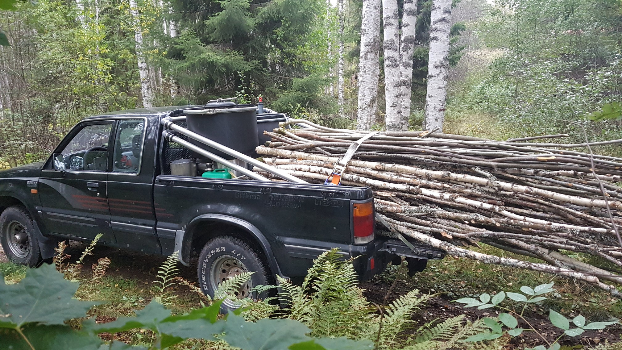

With firewood comes limbwood. That’s a good thing since gasoline tax went up last week and then Saudi bombings this week.

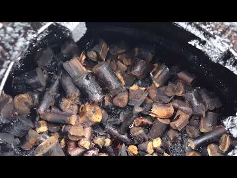

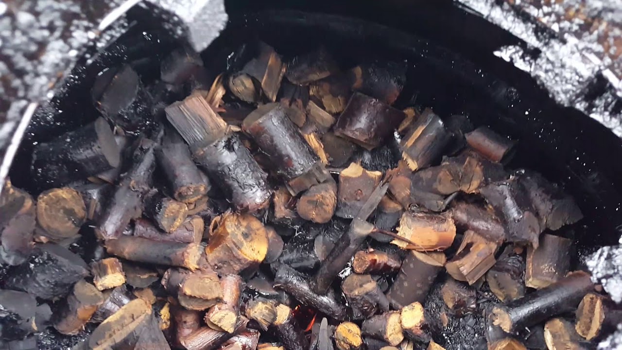

@Jan asked me the other day what blower I use. Decided to make a lightup video. Unfortunately I flushed the system yesterday and no stored woodgas cranking up - otherwise a normal lightup.

Jan, I love your simplicity with the blower for starting up your wood gasifier. I think most of us have been making it way to complicated. I am going to rethink what I was going to do to a more simplified approch on my gasifiers for now on.
Thank you for your start up video.

The main reason I switched from Rabbit to Mazda was the Mazda was possible to legally register as a woodgas vehicle and the Rabbit was not. Also, the floor rusted out on the Rabbit, with a no-go at inspection. No MIG and no thin welding experience.
I built the Rabbit gasifier without knowing what to use it for. It didn´t really fit the car. Too tall and somewhat experimental. Looked a bit funny. The power to weight ratio on gasoline was better with the Rabbit but still the Mazda performance on woodgas is better. I think, mainly because of 3 valves per cylinder. Downside is the head is probably more delicate. I have had some ratteling going on from time to time, probably when flakes of soot let go in the intake. Never anything but smoth running with the Rabbit.
All in all the Mazda is a more versitile vehicle, with 4-wd, a back seat and a lot more loading capacity. About 50% higher fuel consumption though - but that doesn´t matter ![]()
Allways nice to see a cold startup, very fast startup too.
Some gasifiers have a torch hole for lighting, would that make starting faster?
I hope to make a auto lighting system that work by a timer, so the car is ready to go when I wake up in the monning.
JO, thanks for the video!
Jim, this way is fastest. The fire spreads from center outward, while a lighting port ignites only one side then the flame front has to go over the entire hearth.
Auto ignition is not pracicly possle with wood. Maybee charcoal.
Problem is each time you startup you need to inspect your gasifier content with a stick, as JO demonstrated.over cooldown, tars will glue the wood together.
But what you can do, at least l did, is inspect, poke and fill the hopper in the evening. In the morning, l hit the fan, touched a torch on the light port and drove off on petrol. After a km or 2 the fan can be killed and gas can be blend with petrol, in a few moments you are 100% wood.

I forgot to mention, charcoal gasifiers are generaly way easyer and faster to lightup. woodgasifiers make potentialy tarry gas at lightup it is not adviseable to run startup gas in the engine, but thats no problem with chargas. With charcoal you dont even need a fan. Idle the engine (mpfi) on petrol, light and drive. The engine will provide suction and cut off fuel when gas gets richer. When it gets rich enough, you open the air and kill the fuel pump.
