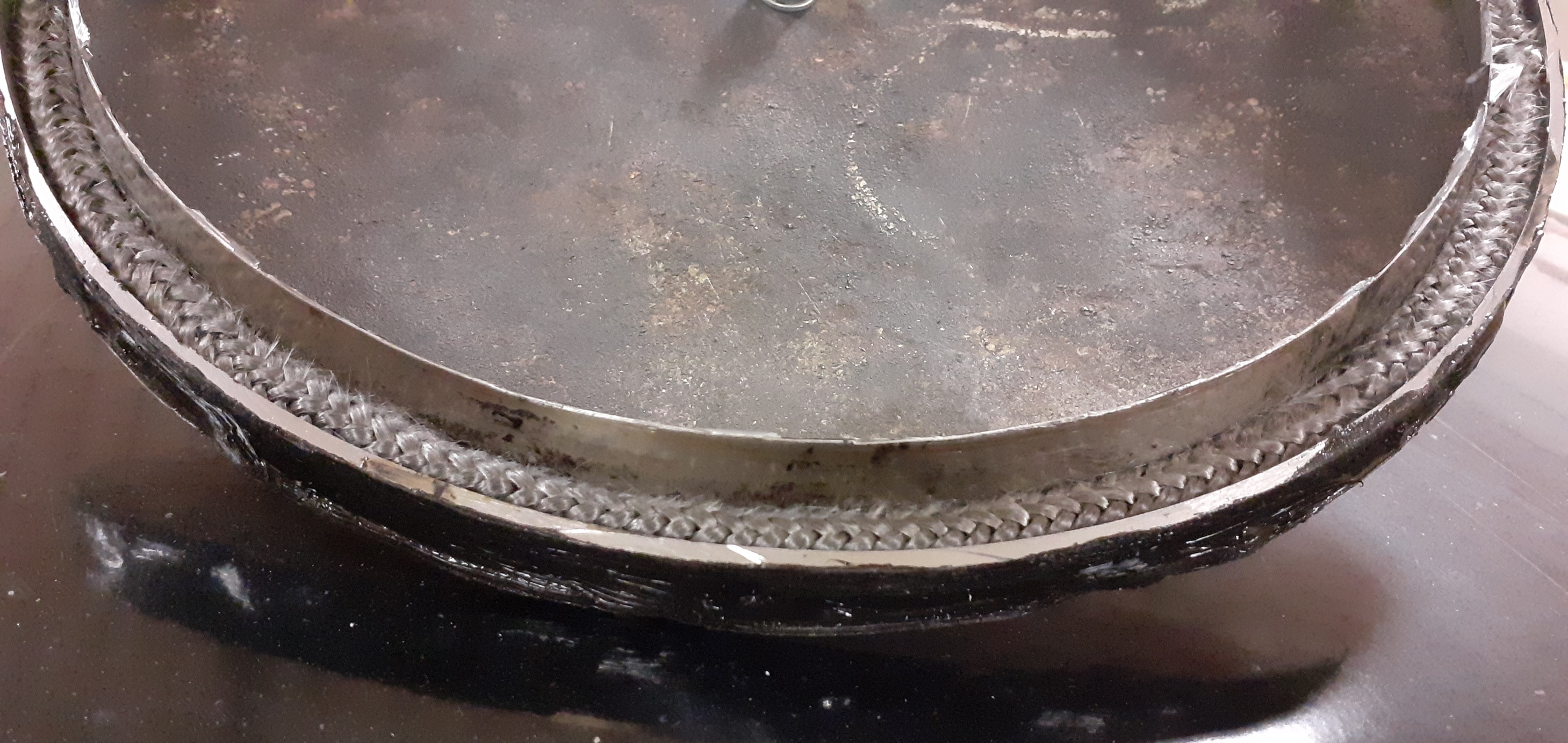

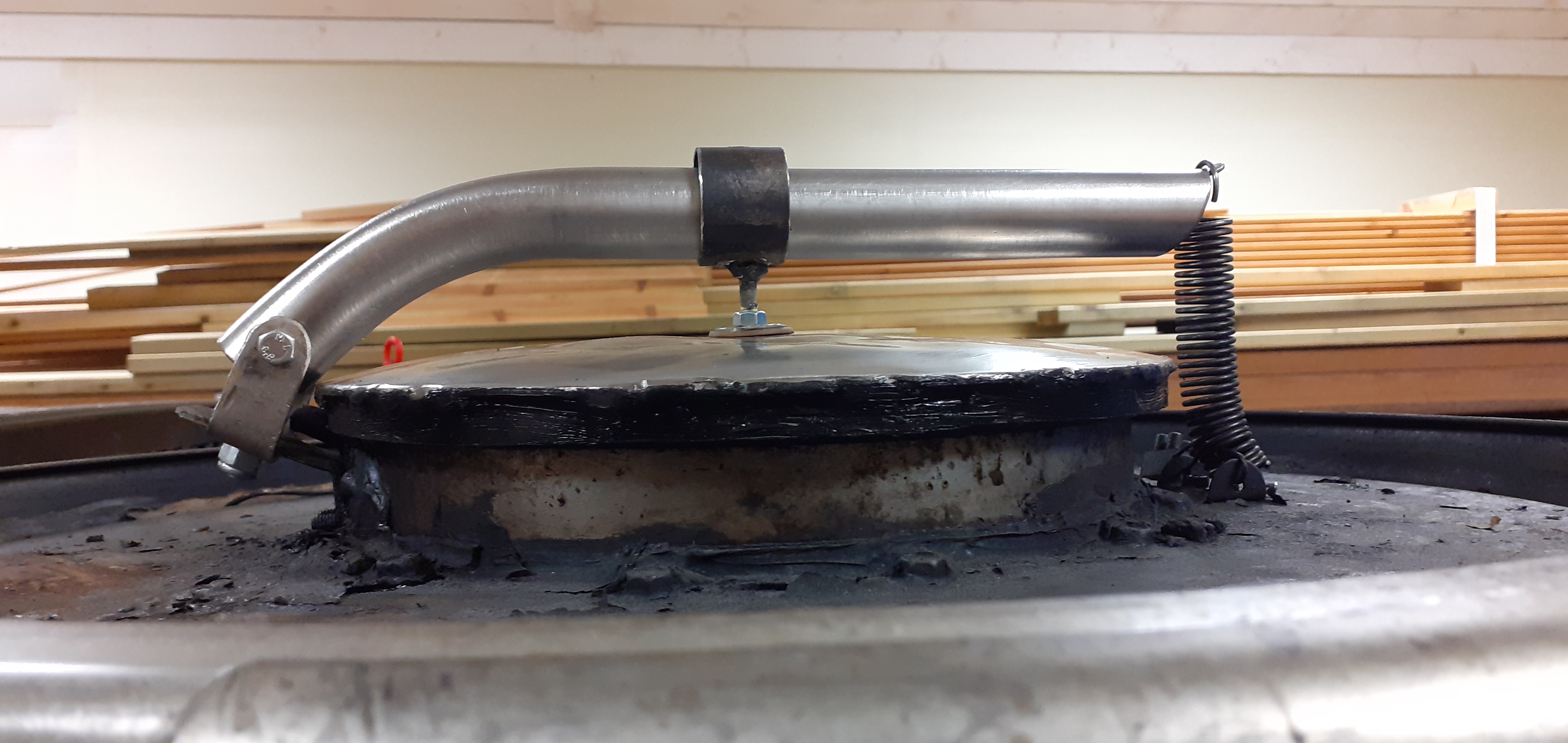

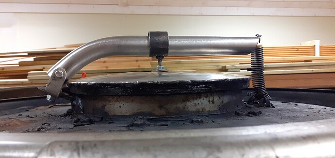

Fabricated a new hopper-filler-puffer-lid. The old-flimsy-copper-kitchen-pot-lid has taken enough beating. (English language uses a lot of stacking)
Utilised the old cut out bottom of the ss hopper vessel beat it with a sledgehammer on an envil to make it slightly dome shaped.
Looks like that lid can get tight, you have good ideas.
