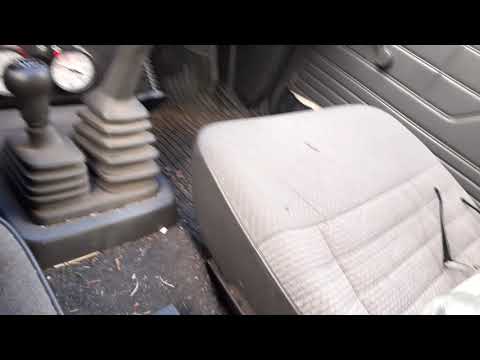

In the back of my mind I’ve been wondering for some time if maybe my heat exchanger is a little tight on the air side. I decided to do some experimenting.
The gasifier air supply has a removable cap where I can let fresh air straight into the nozzle manifolds, bypassing the heat exchanger. I did some top speed testing at a certain stretch of the road. First with all the air going through the heat ex and then I removed the cap and drove the same stretch again.
Wow, what a difference. Top speed increased from 90 to 110 (55 to almost 70) at that particular stretch.
Also, a huge difference in vacuum ratio. It climbed from 3:1 to 6:1 or even more. Obviously much less work for the hopper area to pull on the nozzles.
Maybe my imagination, but it seemed even the exhaust had more bark to it at WOT.
I’ve been jumping up and down the truck bed enough for today. I’m back to a headache and an increasing fewer - BUT with a smile. The thinking chair is next.

I did that by installing a new tennis ball valve and go for another test ride ![]()
In the video I read the guages slightly wrong. I was pulling 12:2 with the by-pass valve open vs 15(16):5 with the valve closed.
I’m still amazed how only 3-4 inches less vacuum at open road speeds can make for this amount of extra power.
