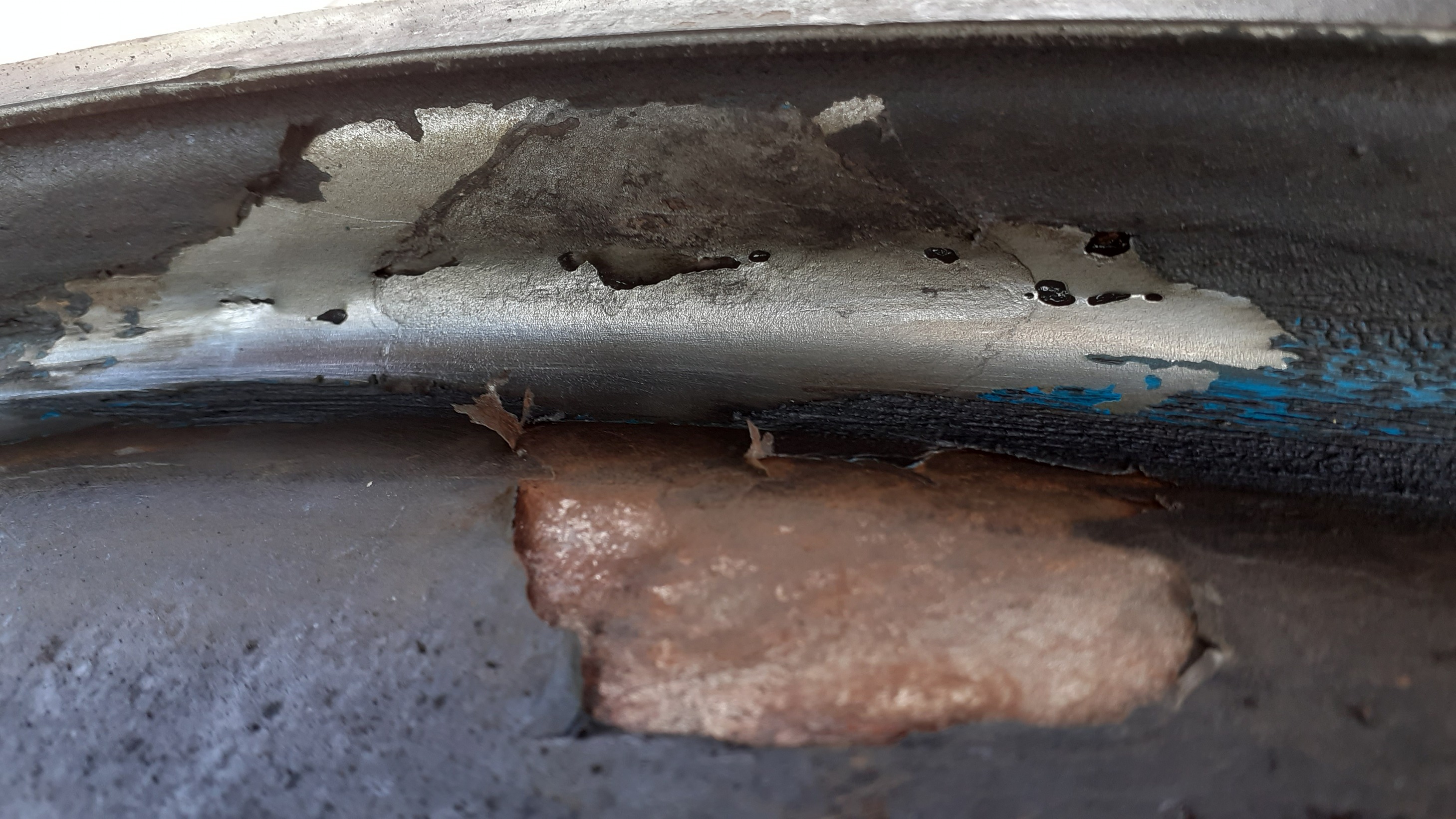

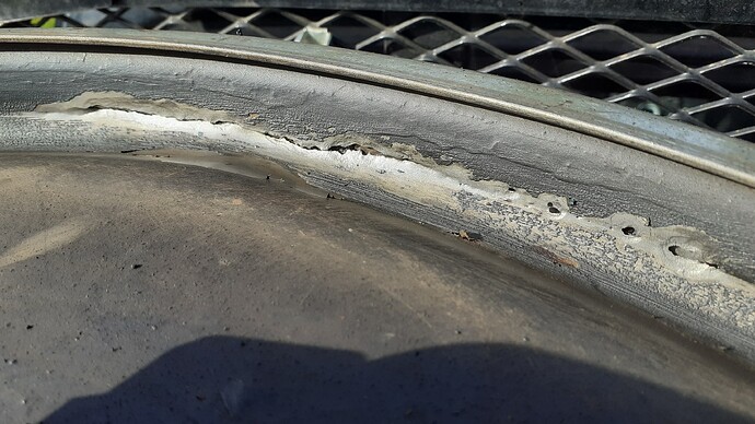

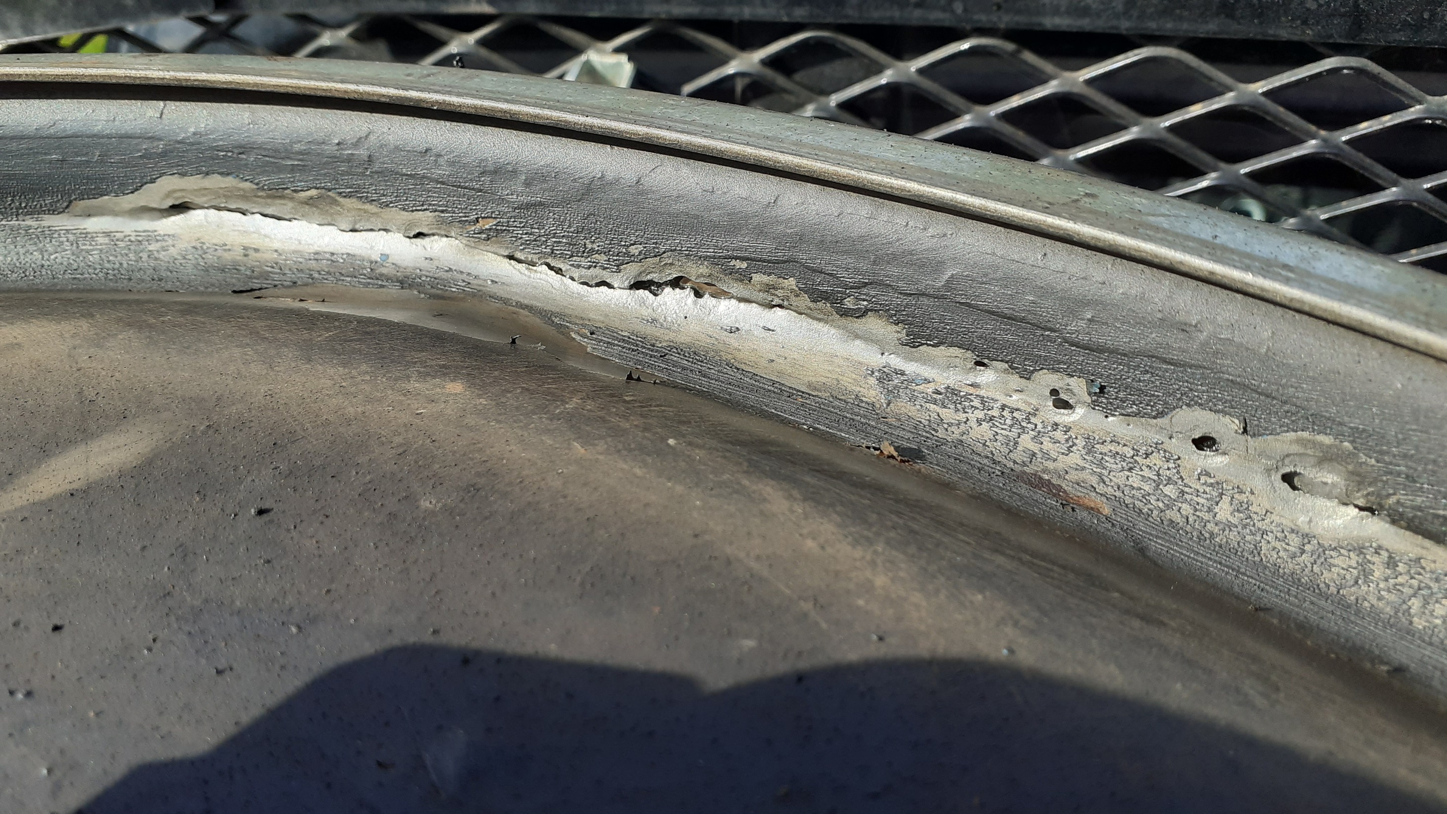

The truck had been sitting for about an hour today and when I cranked up and drove away again I had a pretty loud hopper puff after about 20 seconds. I didn’t think much of it and kept on driving. Back home when shut down, smoke was escaping from around the edge of the 55 gallon barrel lid.
Running the wire wheel a little, this is what I found.
2 years and 6 months. Or 14,000 miles.
JO, I gather that it rusted through. Is that right?
Steve, that’s right. The hopper puff just finished the job by blowing a couple holes through rust and paint.
I was forced to make a third trip into the city this evening. Before I left I just smeared some silicone onto the damaged areas. Works for now, but the lid will have to be replaced sooner or later. I have one more somewhere in my junk piles. Ideally I would have liked to make a dome shaped ss lid, but it’s easier said than done.
