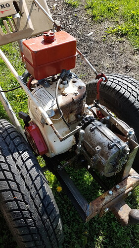

I’ve secretly doing some tinkering lately.

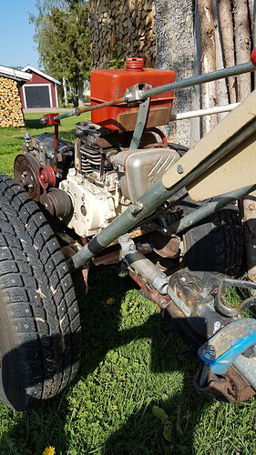

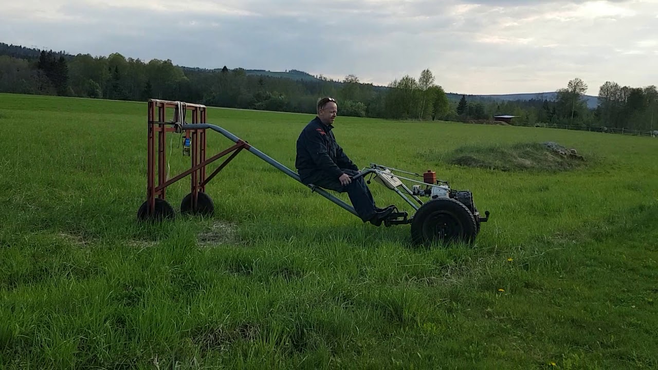

My homemade skidder needed a small horse. Smaller than the Fergie. So, I decided to fabricate one. Good thing is I didn’t need to buy a single item. I used up a few welding rods and cutting discs, thats all. The rest was junk/treassures laying around.
Nice looks like you could sneak that through the woods without much of a path at all.
Dan,
I have a lot if trees down in the edges of the clearcutting area. Stumps and rocky terrain makes it hard for the old Fergie. I hope to be able to use this machine to collect the the logs.

Please post some closeups of the “horse” , looks like a roto tiller on steroids!

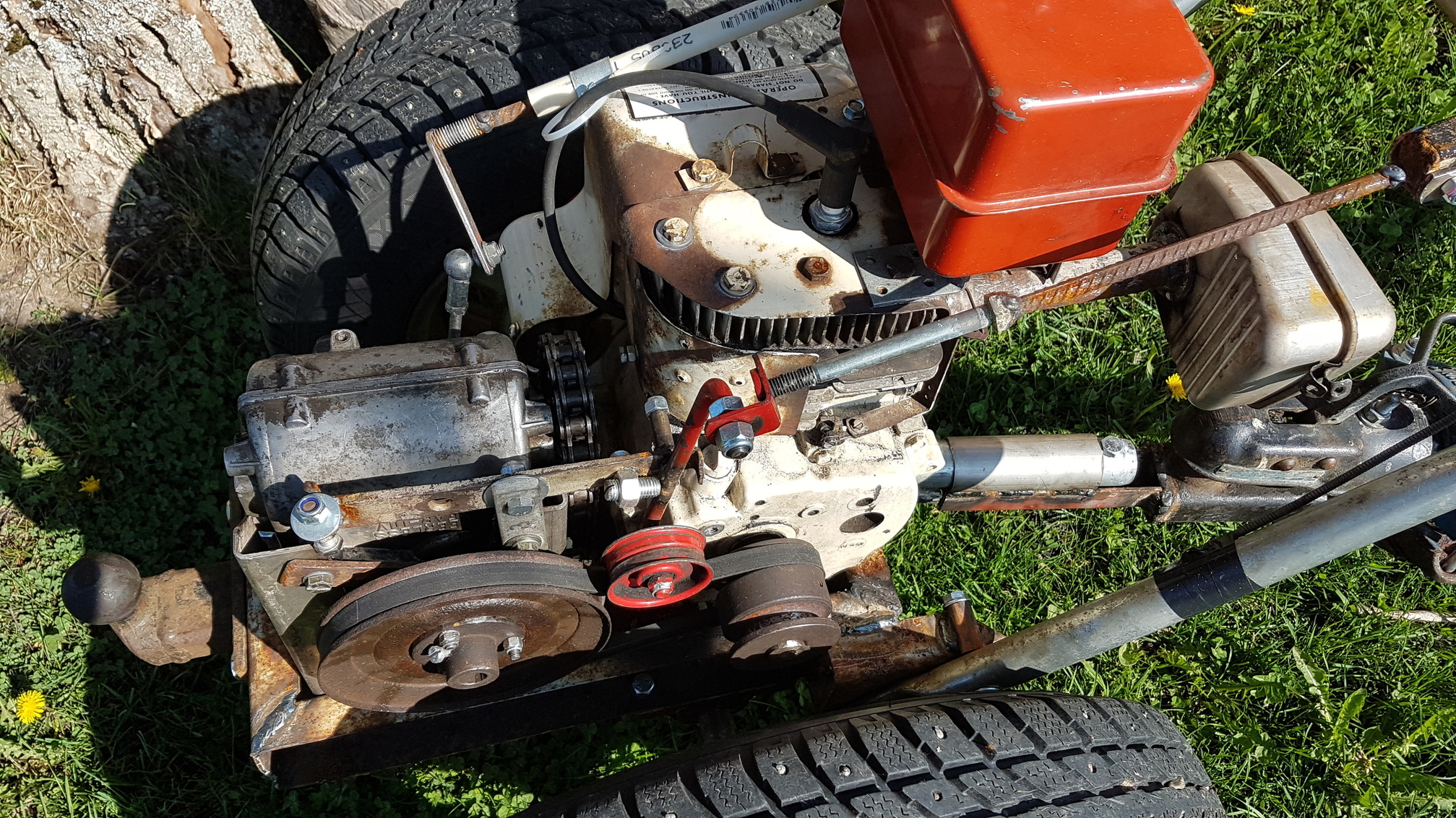

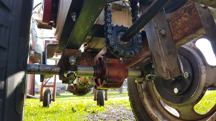

The 7hp Briggs and the axle are probably from a rototiller or a snowblower. 5-speed+R gearbox from a lawnmower tractor and tires from my former old Volvo.
Belt drive from motor to gearbox, with tensioner acting as clutch. Motorcycle chaindrive from gearbox to input screw into the axle. Leftover cut out domes from propane tanks act as “hubs” for the rims.

That is Some impressive engineering and fabrication.

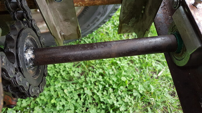

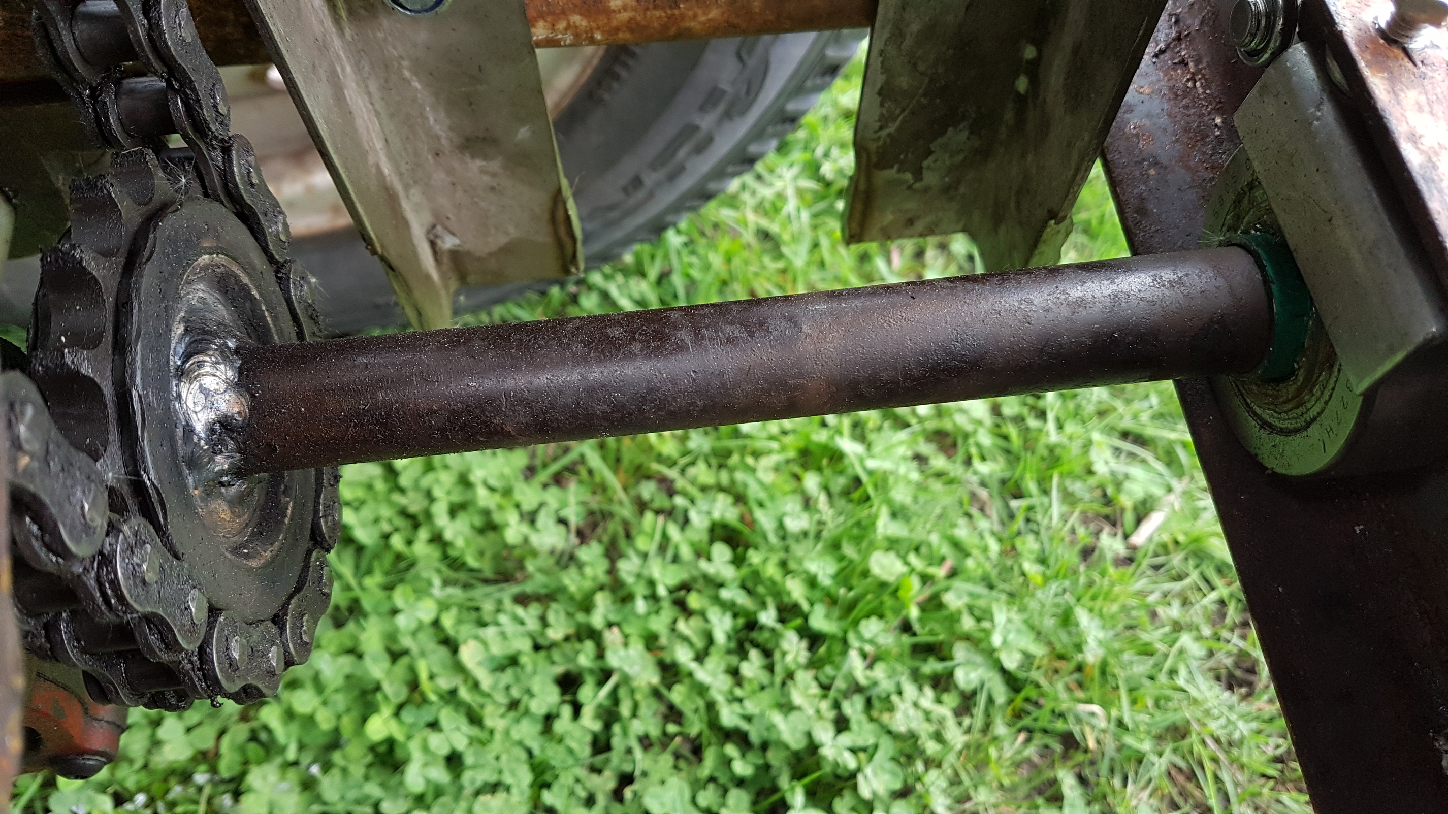

Does the chain drive provide the torque resistance for the wheels?
I could not see any braces to the final gear drive.
Thanks Michael,
I fixed the lengthwise driveshaft with a bearing into the front of the U-beam frame I welded. That’s the only bracing there is. Bearings in the gear will have to manage the torque. The gear is too small and with nowhere to attach additional bracing.

I like the ball hitch at the front. Makes horsing trailers around a lot easier!
