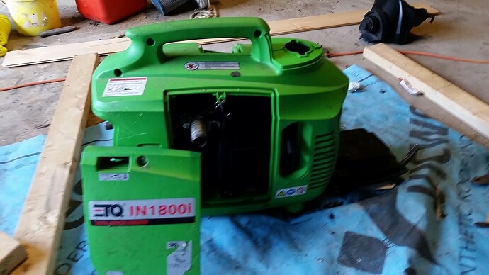

Something else followed me home from the dump. An 1800 watt inverter generator with “carb problems”… already half rigged out for charcoal.
Whoa, a very nice find
I need to go to the dump more often. My scream- o-matic just took a dump. 4000 watt that only puts out about 1500 before voltage drops to under 100. Building my own inverter generator now.

Well the verdict was the fuel pump was shot and a nut on the carb was stripped so it was sucking air… new nUT, tore out the gas carb, built a quick venturi, hooked up a propane diaphragm regulator and voila… She charges batteries amazingly and runs lights… so far up to about 600 watts and will try for more soon

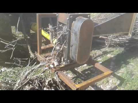

Not ideal for gasifier fuel ,but reduce the volume of branches to about 1/4 . Insanely scary machine. Good fun though.
