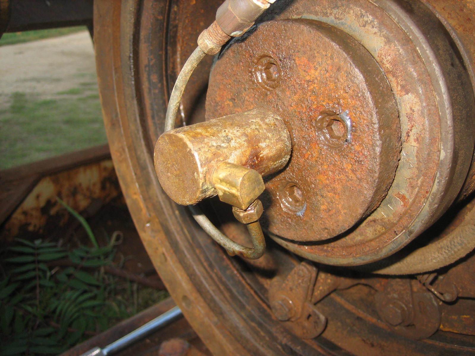

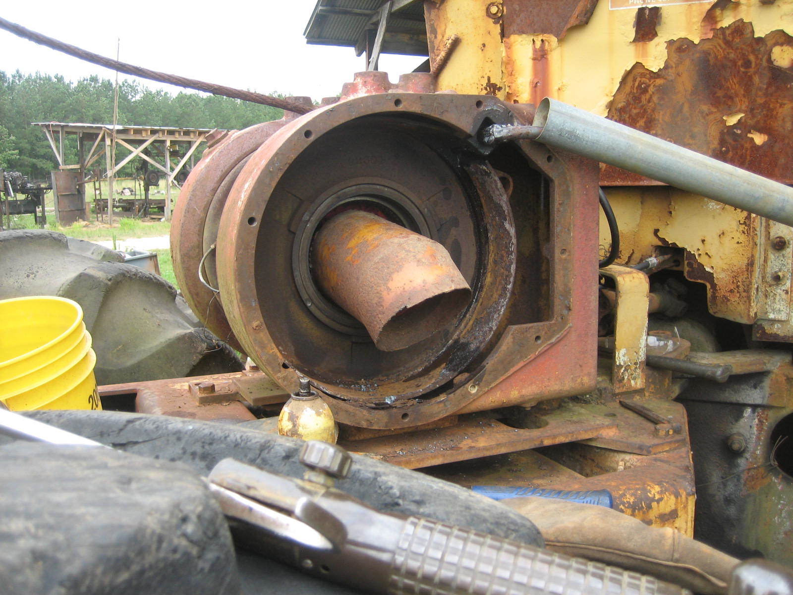

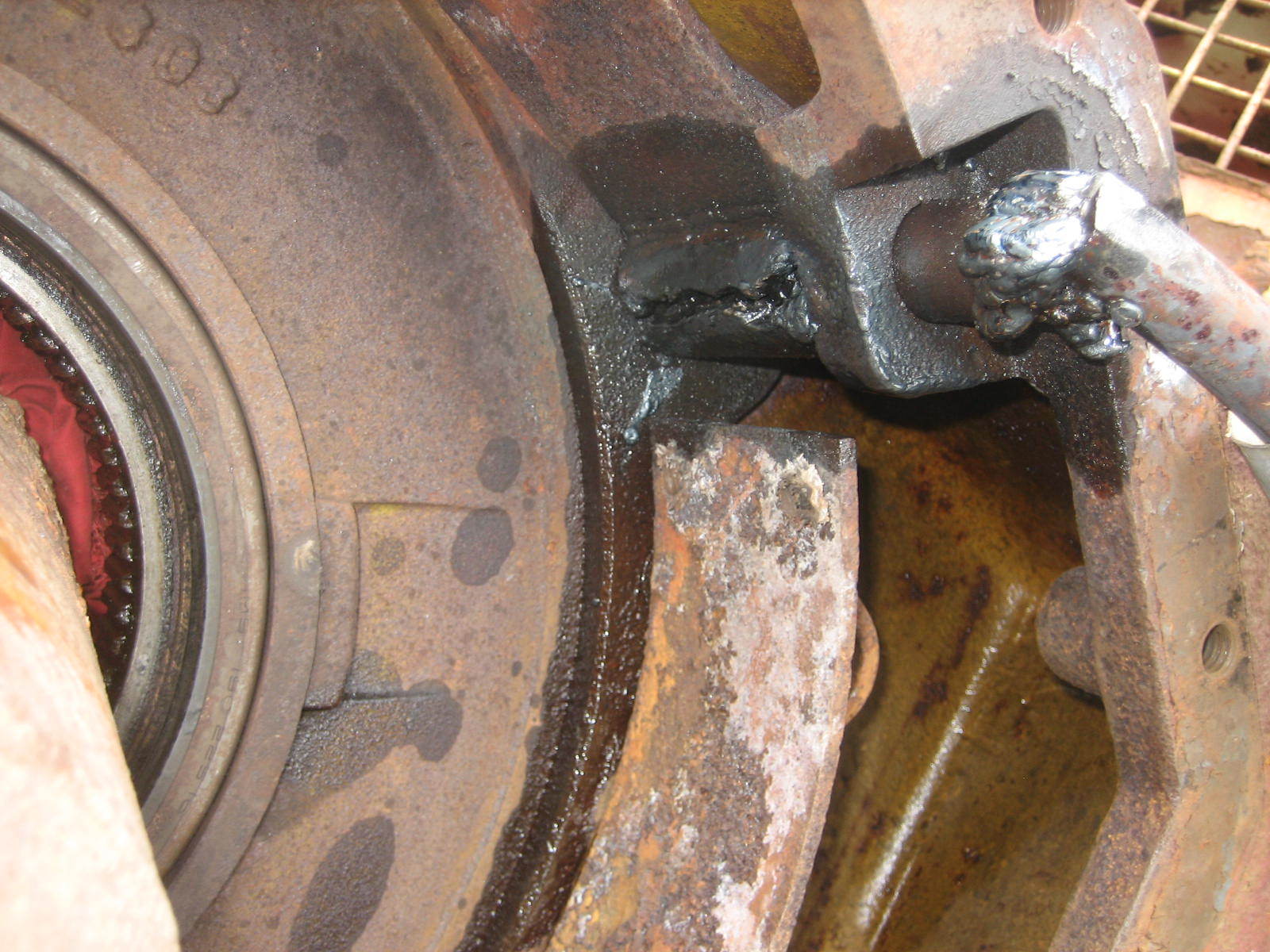

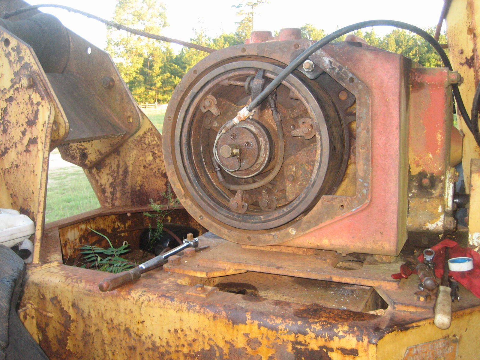

The brake lining was froze to the winch drum and came lose from the brake band.
The anchor pin for the brake band was froze to the housing and the band. It took me about a day and a half to get the pin out but I had to get real ugly with it .
The pin was threaded for 3/8 bolt to act as a puller but the bolts would break right quick . I was able to weld a 5/8 bolt to the pin ( real tight area and over the fuel tank ) and make another puller. With a big pull handle and extension pipe I broke the bolt.
I welded about an inch bar to the pin and put my 300 pound youngon pulling with a 5 foot pipe. With enough heating and quenching we got the pin to turn lose from the housing but no luck with it freeing from the brake band.
Last resort was to cut the brake band but to be very careful not to scar the pin ( shaft ) . Any scaring and the pin would not have come through the housing .
Yes it took a while but got it .![]()
Hey Wayne. It looks like you run into a big job with that. I have had them to stick but not like that.
Looks like the inside shoes are useable if you can get them sanded down and slicked up enough. how about the hub will it shine up. if it is pitted it will most likely grab and wont stop pulling when the handle is released. I have had them to lock in and pull until the cable breaks. The only way to stop it is to hit the clutch.
Be a good time to free up the screw for the spool drag, they can get real stuck and the spring will be all rusted to.

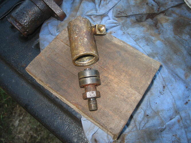

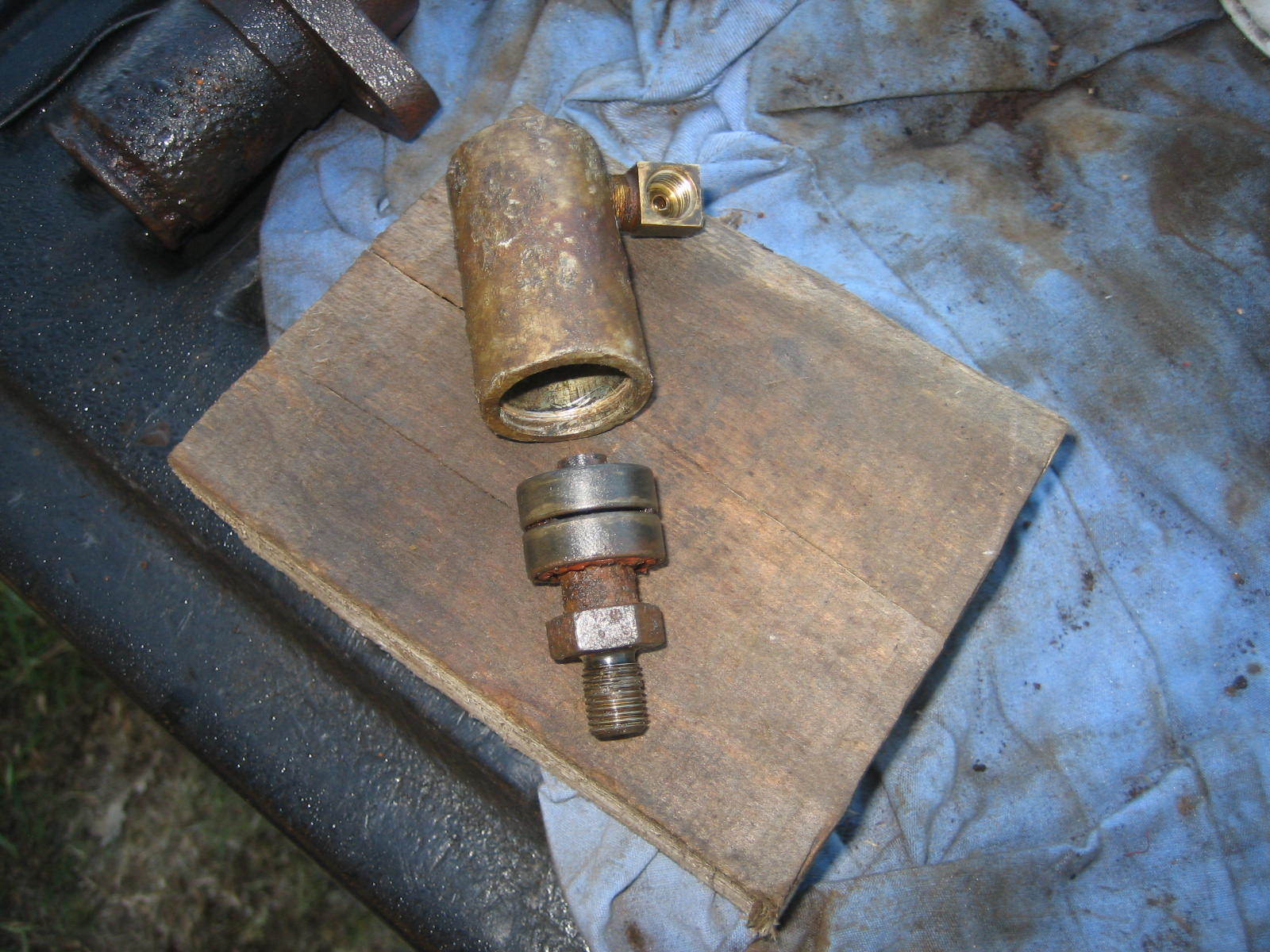

The pictures below show a live hydraulic swivel .
Do you have any leads where they can be bought or better still any tips on stopping them from leaking?

I successfully fix one and totally failed on one.
It has left hand threads were it screws on to the hub if you can get lose there is a little snap ring on the end, ever thing comes out the end. Yours looks rusty about like the one I failed on…Just no way to get it apart.
As for a place to buy one. I found one at ‘’ Ozark machinery’’ in WestPlains mo. About any place that sales parts for Tree Farmer or Timber Jack should be able to get one. There’s a used equipment place in Wolf Lake Ill. that sales used and new parts, and a place in Tennessee called LMI that I got parts from. I don’t know the address or phone number but I can round them up if you need them.
PS—I think it cost about $100.oo.

Hello Wayne
It has been a long time since I had those apart , I believe you take the 4 Allen head screws out and then the plate & swivel come of as a unit , then take the snap ring of and pull the swivel out & then replace the seal.
Polish up the seal surface if not worn to bad.
I may be wrong but…
Calvin…

Early this morning I took the live swivel apart and gave it a good cleaning and put it back on the machine . Seems to be working OK but with a small leak.
I bought this swivel 16-18 years ago for something near $150 ![]()
I think I will give it a try .
It will have to leak a lot of brake fluid to justify me buying another !!
Thanks again all .
Hello Wayne
That’s good it did come apart.
If the bearings are rough they are the same bearings that fit in roller blades and some skate boards that kids play on.

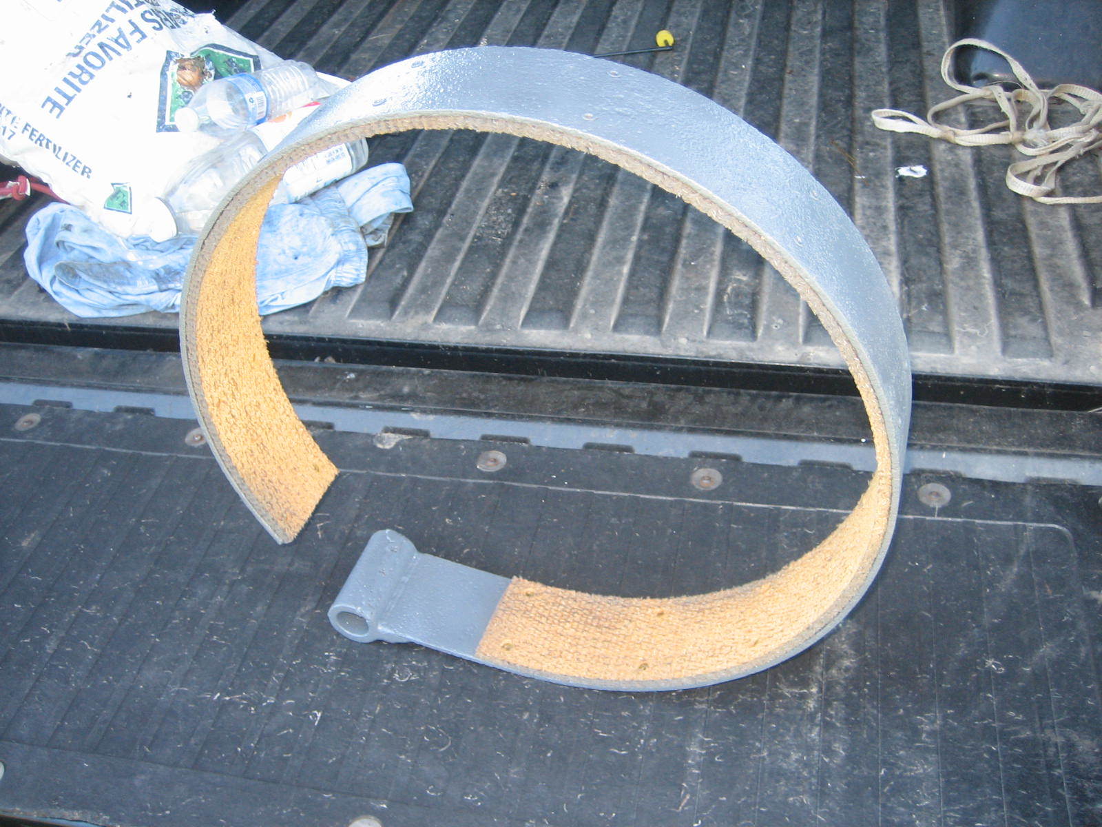

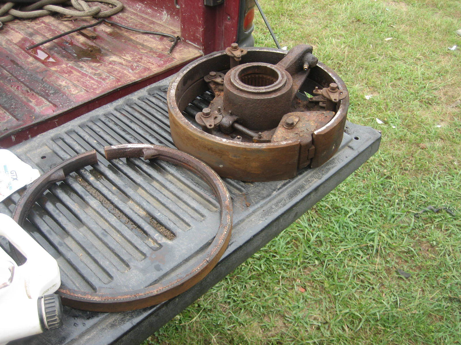

I am having my brake band relined , Should be ready today
Good deal, looks like your on the road to dragging some trees.
The only problem with the swivel leaking is the handle will bleed down when winching.

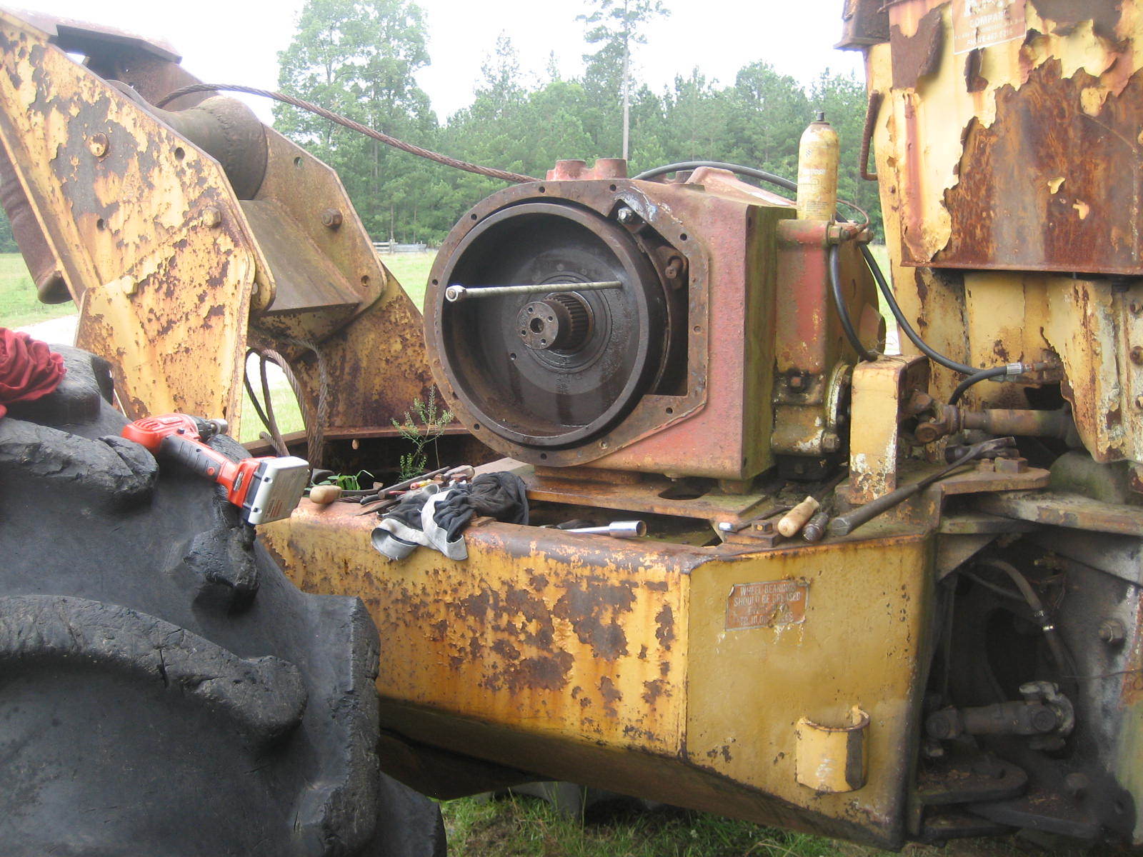

After resorting to the fire wrench to remove this band I never thought it would ever look normal again ![]()

Hi Wayne
That looks like some body did a good job to make it look like that.
Did you put the new end on or the place that relined it.
I tried to get a john deere winch band relined and I couldn’t, there excuse was that the band was spring loaded and over time it would loose its spring and wasn’t worth relining. Sounded like a good line bull to me, I think the dealer was wonting to sale me a new one.
