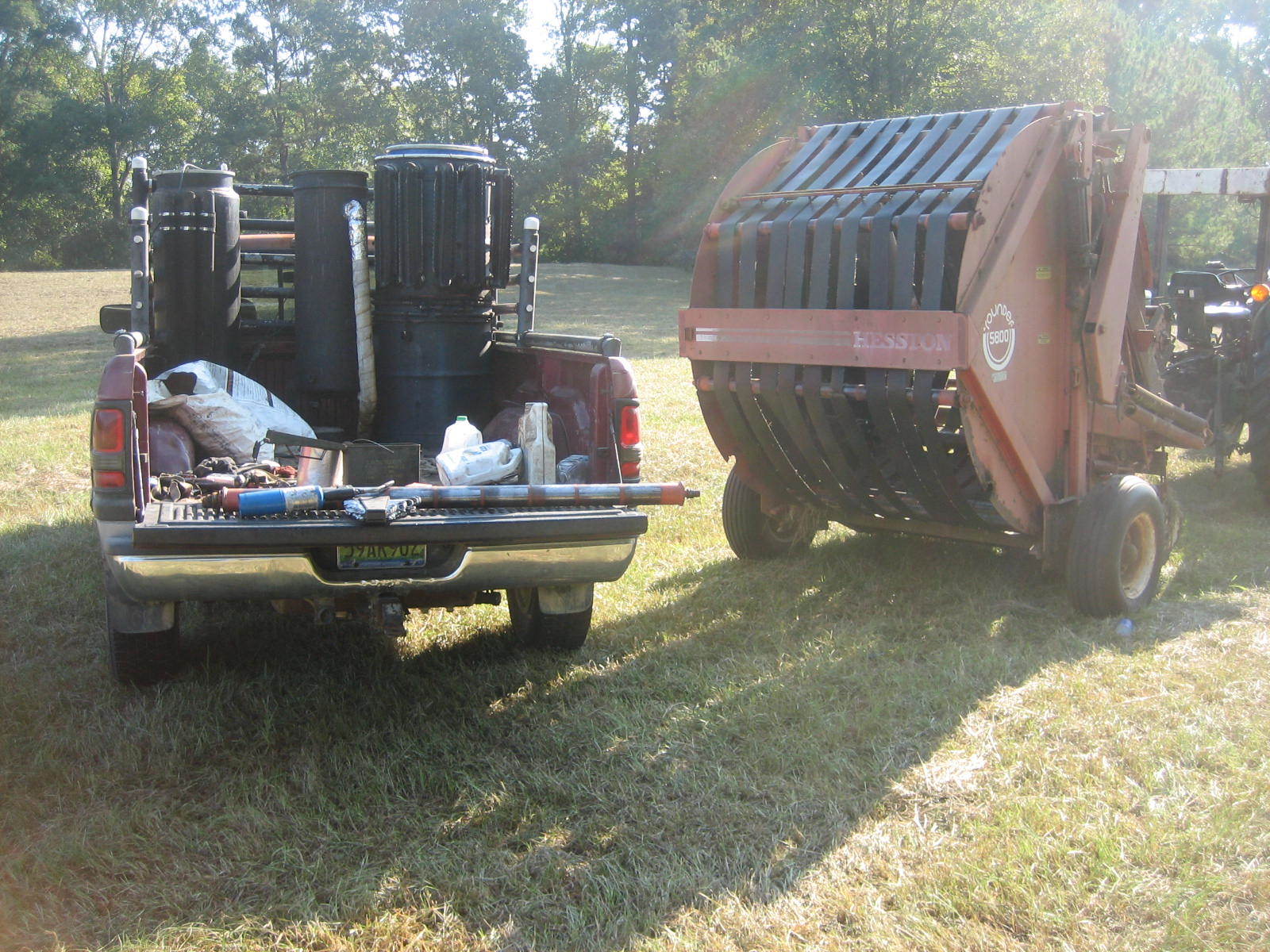

I could use a little help from Chris and his banjo today :joy:
I don’t think a “tune” or even a new banjo string witll solve the roller problem. I know right about now you are up to your neck making hay, but I sure wish I could get out there and make a few rounds of the field. It has to be a beautiful day out or you would not be making hay. Good luck. The cows will appreciate your efforts come January. TomC
