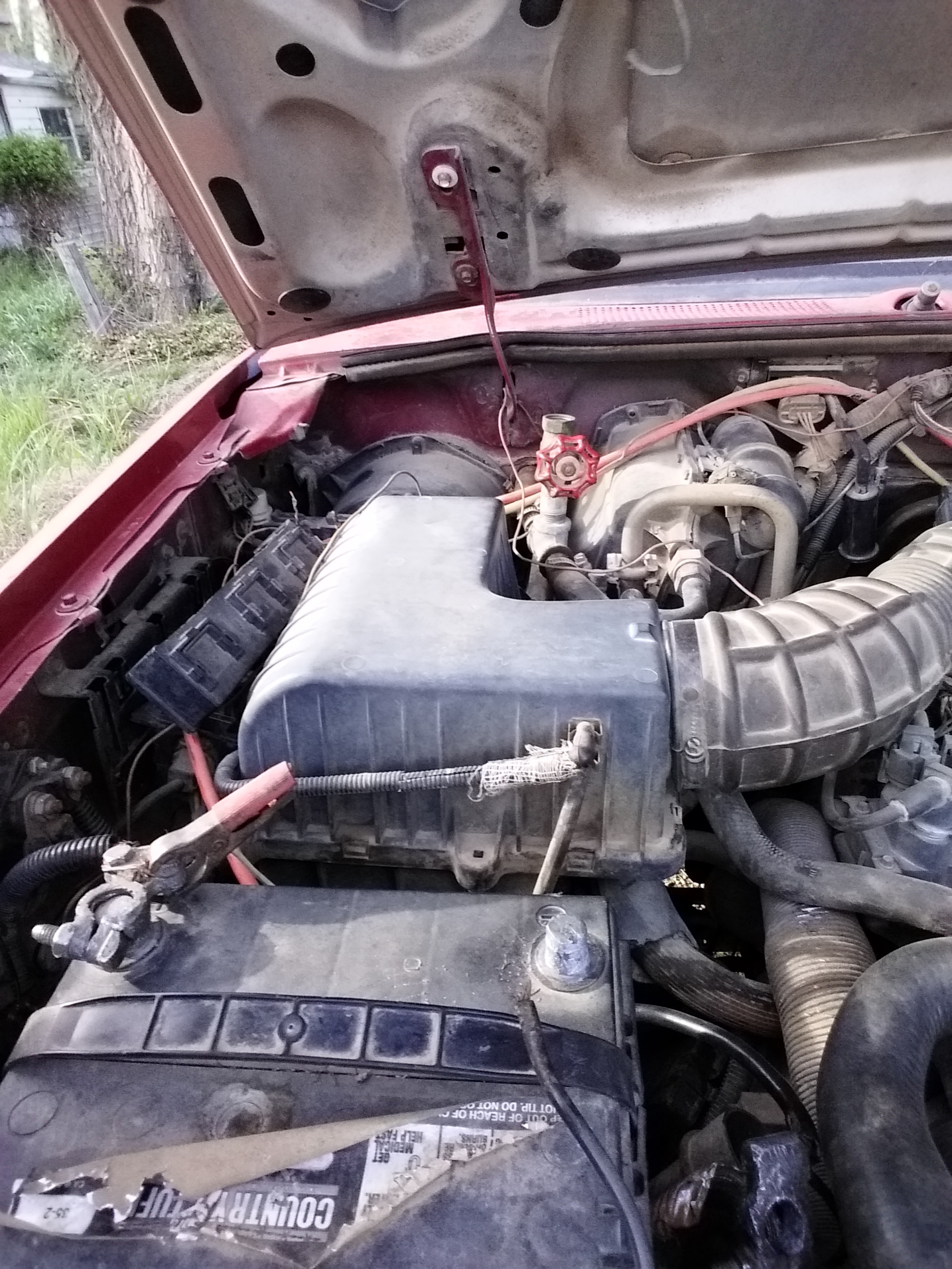

Bare wires spark, can be bad…
I reckon that’s where the airbag goes. But that would be too obvious.
I figured the dashboard notes might give it away… guess not.
Ernie gets the prize. It is indeed a broken cruise control. I had the center airbag out so I could test the cruise switch connector. And the three wires are backprobing the connector on the steering column, which works just fine. I am able to touch wires together to switch on and adjust the cruise control. No sparks, this is a low voltage low current circuit. Very satisfying to make it work this way, for some reason.
The problem component appears to be the clock spring. Apparently there’s a break in the wire somewhere, because the horn and cruise control do not work, but the connectors going to the clock spring do work.
Ha! Did not want to spoil the fun. Had to dealership working replace too many of these.
