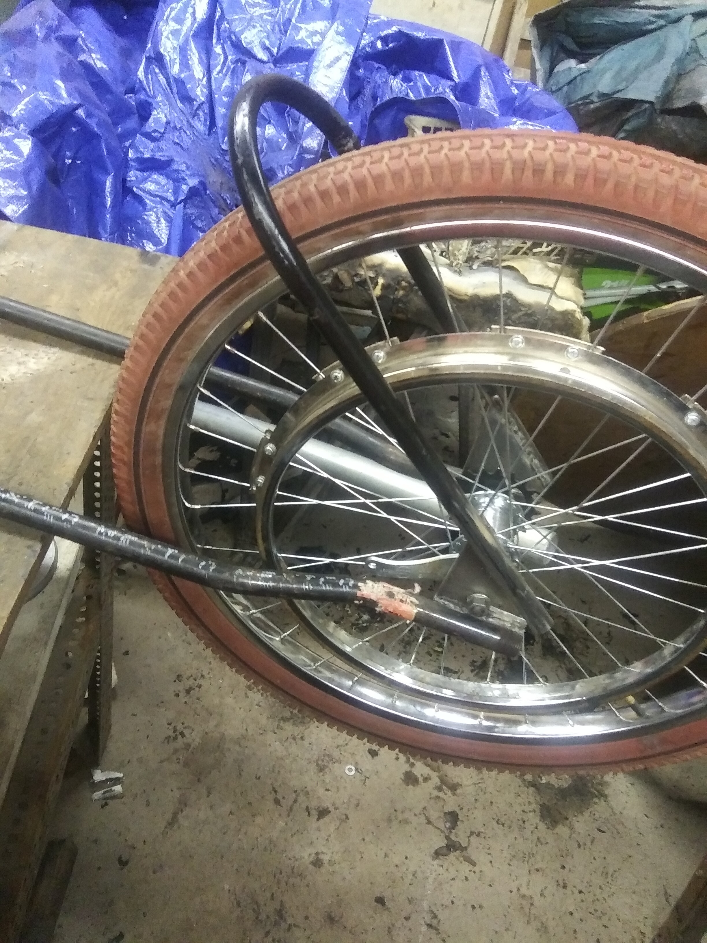

Got more work done on the Henderson frame. It being a Honda clone engine I might name it the Honderson. This seat stay can already support a good bit of my weight which is a really good sign.
I found some jumbo welding gloves and sleeves so I can keep my gauze on while welding.
