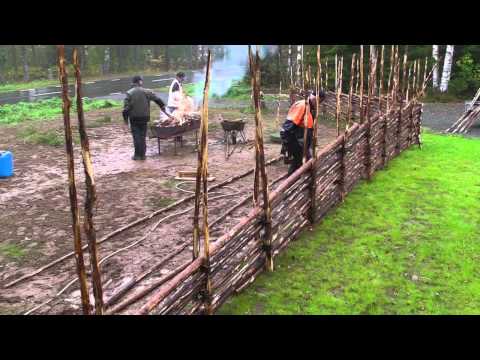

@don_mannes I remember you once asked me about fences you saw in one of my DOW videos. A residual product from thinning spruce forest. This is how they are made.

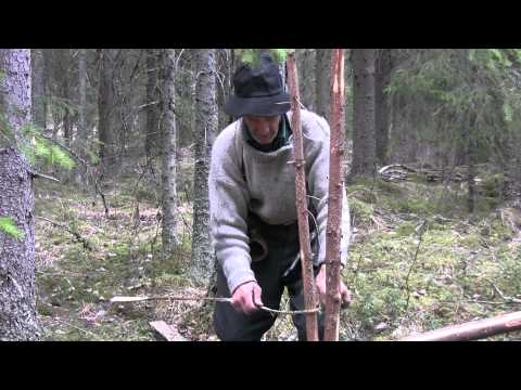

And one of Max Gasman´s fellow-countrymen doing the same. Don´t mind the talking. I don´t understand a single word either.
JO, is the fire just to remove the fingers from the branch or to heat treat the wood? I know some people flame treat axe handles to toughen them up.

Using branches you have to heat them to make them flexible or they will crack. Fingers will fall off anyway eventually. Using young sprigs, heat treating is not nessessary. They are often even split (1.45 vid.2) before tied.

Making flexible wood⌠Hmm, maybe the green wet in the limb turns to steam. Steamed wood.
Wood is a composite material composed mainly out of cellulose and lignin. While cellulose is not heat affected, lignin acts like plastic once heated. Partialy melts when hot and holds its shape once cooled. A technic widely used here mainly for oak wine barrel making. They wuld stack and rim the individual stright oak boards on the bottom lid, then start a fire in the barrel. Once the wood is hot enough, it can be shaped to that clasic roundish shape. We used to make skiis out of left over boards
