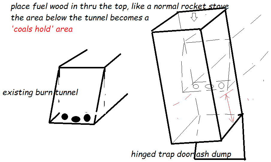

I’ll just throw in my 2 cents worth from my ‘gasifier wannabe armchair’. Try a ‘coals hold’ type thing, that will keep a good amount of your ash, coals, and fuel out of the burn tunnel. I believe this little box could be made of the same square tubing your already using, you could even throw in a grate at some point when it suits ya.
Maybe my picture will make it somewhat clear what a ‘coals hold’ might look like.
Oliver
Hey Oliver, This was another idea I had kicked around as a possible solution, and I think it could work. The biggest complication is how it mounts to the existing burn tunnel without getting in the way of removing the barrel lid. It almost has to just slip on and off, or else it could be bolted onto the lid itself somehow. I do like that in theory this should allow me to stick with a passive airflow, which is a big plus for me, as there is no electrical outlet within about 400 feet. Also, I suspect it might allow me to burn slightly bigger wood, and not have to babysit the retort as much.
