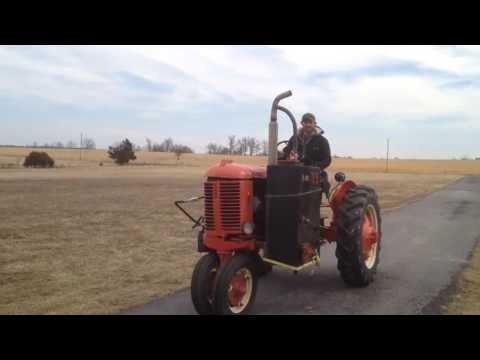

I guess the thing that fascinates me most with the S-80 (once I saw bot the resurrection and tractor videos ) is how compact this unit is . After reading Missouri PDF , I couldn’t work how it could be related to the s-80 , but then figured based on model numbers , they were scaled up or down (to some degree) at the hopper body , , the S-80 being 8 inches ? at the hopper ?
