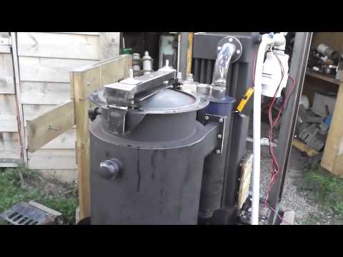

Dan, I thought you said I would like my new vibrator? I love it, man, thanks for your vids, they are great teaching tools from one of the most determined gassers I know.
Here’s a vid of my last run, my best engine run yet. Next up is a new filter system. I noticed I forgot the 2 outer bolts on my motor mount, that’s the vib heard in the vid. I also didn’t pound in the milk can cover all the way so I got an air leak. Maybe that contributed to my lower temps, but still a great run. I also noticed that my air adjustment was on the lean side from my previous run. I saw some comments about this here recently. All interesting 75% tidbits.
Enjoy, Pepe

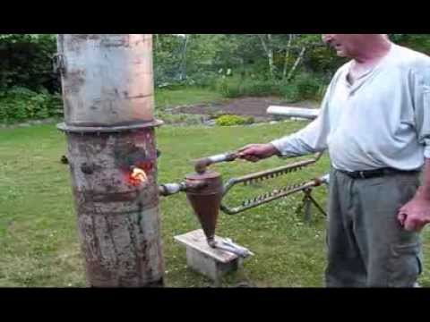

Hi All,
Thought I’d post my 2 fer 1 safety awareness situations. Firstly, my spring loaded lid works and directs the blast AWAY from the operator side of my machine. Secondly, the operator doesn’t work right and could have gotten a face full. That’s a real “hs” smile afterward!
Some have seen them, but there’s a lot more that need to see what can happen in a flash.
Be safe, Pepe
Here’s the new link, it’s only 37 or so secs.
Hi Pepe
You are lucky to catch those puffs on camera, I have had several that have knocked my hat off, but never on camera. They are brilliant educational tools!
Thanks for posting
Patrick
I had one like the second one in your video a few days ago. The gasifier had been in use and shut down for a few hours, then I relight it. My 200 litre fuel hopper blew the lid out before my relief valve on the top of the gasifier opened. My fuel hopper must have filled up with combustible gas when I shut it down from the previous run. It left the relief valve stuck open more than 40 MM with wood chips stuck under it. I hate to think what may have happened without the valve.
I thought this was a good DYI “throttling” design. He claims it’s airtight, but I’m not sure I’d use it for a shutoff. Those of us with near hits will appreciate the caution and invest in globe or gate valves (depending on temp exposure-, globe valve low heat, brass gate valve for heat).

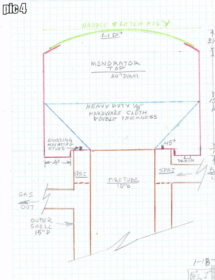

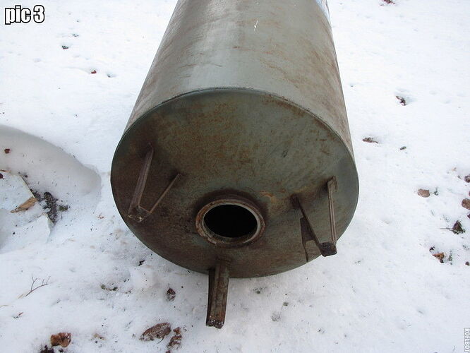

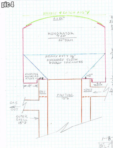

I’m going to build a monorator top for my gasifier from a 24" diameter water storage pressure tank my neighbor donated to science. I can make my total unit height 16" shorter using this tank and retain the existing volume of fuel loaded. I think I’m looking at a 2+ hour run time. We’ll see. Hopefully this will wring more water out.
Pic 1 Both ends have the same shape and a 3 1/2" crown.
Pic 2 This will become the new lid.
Pic 3 This will become the loading end since it already has a hole in it.
Pic 4 The plan. The monorator will bolt to the existing studs for the old hopper (last pic). There’s plenty of room to bolt it down through the large open lid. At least I’ll be doing something in the shop while winter plays out. Going to minus 10 F this week.
Yes the flanges in the last pic are not shown on the diagram, good catch, lol.
Pepe
