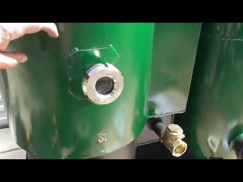

Here watch Tone’s last video for how to stoke up for a flare:

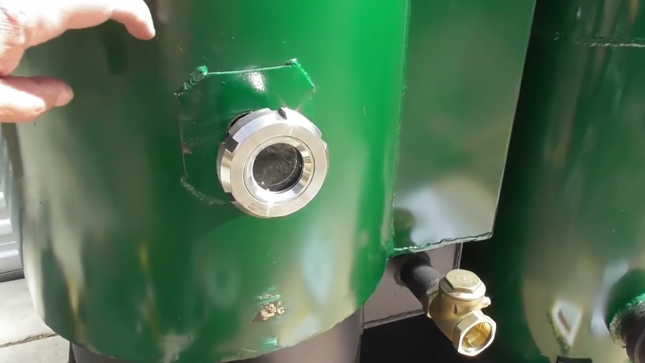

Here is one of Steve Offgrid48 videos on starting the gasifier up: There may be some hints for you in there.
