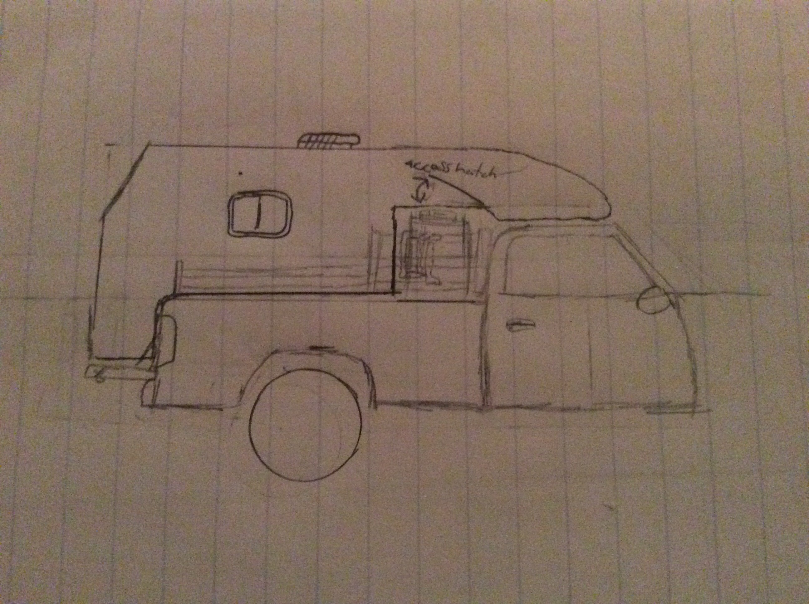

Could you possibly build an older van with a ford 302 v8? Just curious. I was exploring the idea of Mobile living, like vans and such, but I am not planning to do any of it, I just want some insight on what would go into it. Another idea, probably not practical, but making a plywood or fiberglass camper shell for the Dakota, but forming it around the gasifier, and inside have a sealed hatch to load wood, and have ample ventilation for possible lingering gases. I am aware that the weight and aerodynamics would by substantially thrown off, but I am just looking at the possibilities, and something to think about. Here is a sketch to represent this so called wood gas accessible camper.

The sketch as you have it drawn not a good idea. Camper shells and gasifier don’t go together . A better combination would be a gasified truck pulling a small camper trailer or a camper pulling a trailer mounted gasifier .
I was thinking the truck and camper trailer as well the other benefit is you can park the camper at a camp ground and drive around in the truck looking for more wood.

Just putting ideas out there and seeing everyone’s input. Thanks wayne, dan, and mike for responding, I was watching videos about living in the back of pickup trucks and custom campers, I thought it was interesting so I decided to post something about it. Tyler

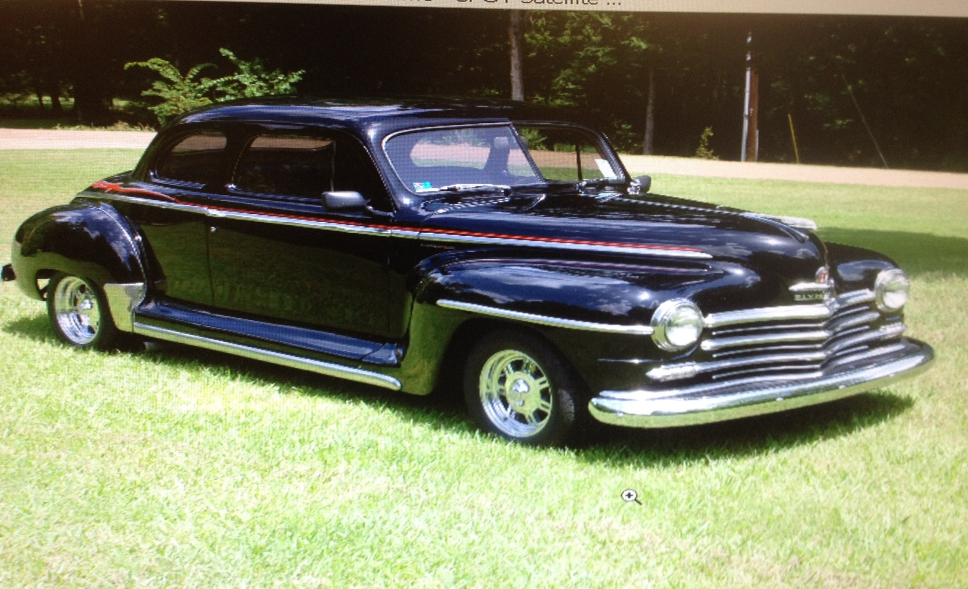

Thanks, Al. Looks like you are a bit of a streetrodder with the cool '48. I have a '48 Plymouth Club Coupe that I take to Louisville to the Street Rod Nationals.
