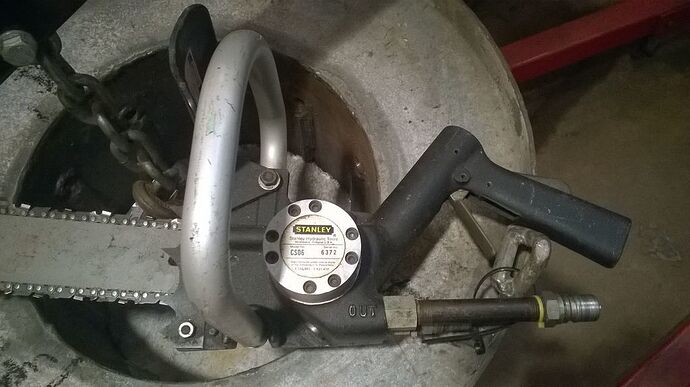

I’m digging it Arvid I need one too. I am going to skip the electric and use this. I bought it to use when I get to building my skid steer mounted wood processer. It has quick connectors on the hoses to run off aux hydraulics Very powerful and light as a feather.
Man i haven’t seen or even thought of a handheld hydraulic saw in years…an Ex girlfriends father had one that i used to cut alot of his firewood for a few years (ahhh, the things we do get a leg over… lol).
that one even looks like it has a kickback brake on it…the one i used didn’t have one…was no problem… as long as you knew not to use the upper part of the blade nose when cutting.
the only real problem i had was remembering when i went back to a normal saw that i didn’t have 28 HP to play with anymore
Those hydraulic saws are really nice and was something that I wanted to do with my setup, a lot of the older dodge transmissions (manuals) have a spot where you can install a PTO.

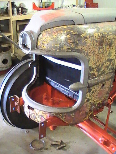

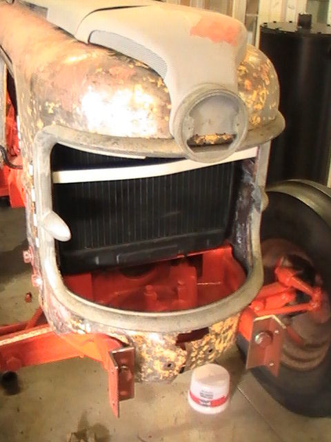

hey, the front grill surrond fits and latches like it is supposed to now… paint will happen soon I’m thinking…
Looking good!!
Very nice!
Looks awesome, Arvid! Nice craftsmanship…

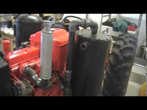

a short video of the case running on gasoline for the first time since we got it… well, probably for more than 5 years in reality.

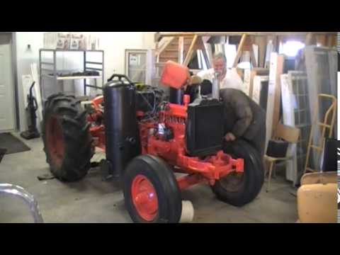

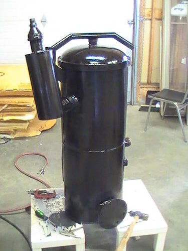

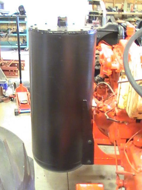

a pics… getting closer everyday… some sealing and plumbing and we should be sent to go…
and of course, better than original, because it now runs on WG!
