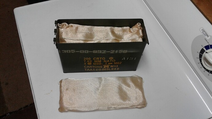

I can send you a piece of one inch ceramic blanket. Put that on the lid and make a sheet metal cap to go over it so your soot will fall off without getting stuck in the blanket.

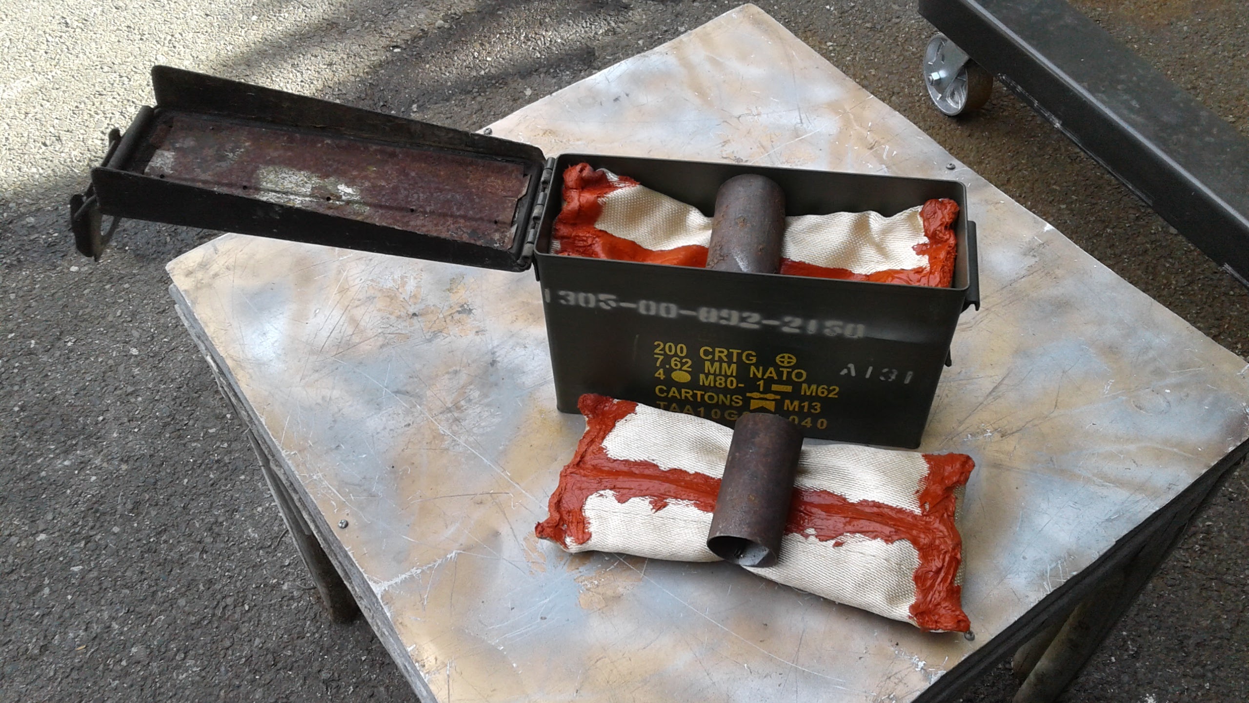

I used some ceramic wool cut to the shape of the box and wraped with fiberglass welding blanket. Used wire to stick it together. I put the pipe tubing in the middle holding it wire. It fits snug with the pipe under it leaving a air space. The pupe keeps the sides of the ammo can from bending from high vacuum pulls. The folded seals under it is glue with high temperature silicone. It keep hot charcoal away from the hatch seal. No more cooking the seal.
Bob next time you have it open Iâd like to see a picture of that setup.
Here is a picture of it.

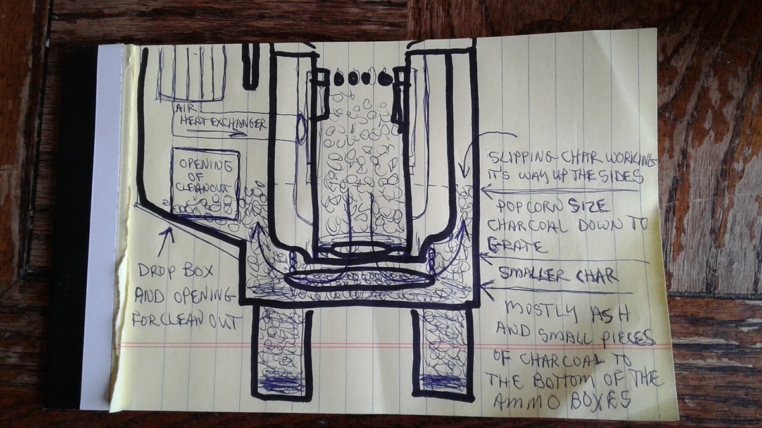

Here is a cut away drawing of my gasifer
of what happened when it got to full of charcoal and ash.
It caused a very high vacuum. Charcoal and ash in the drop box.
The restriction opening is not drawn into the drawing and it is not to scale.
