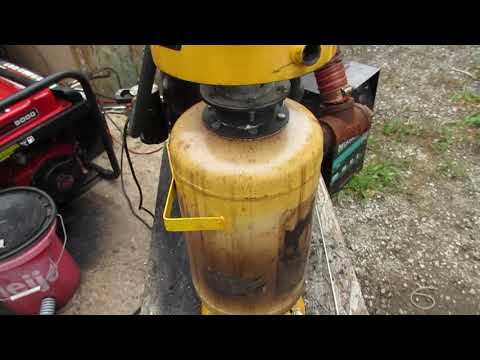

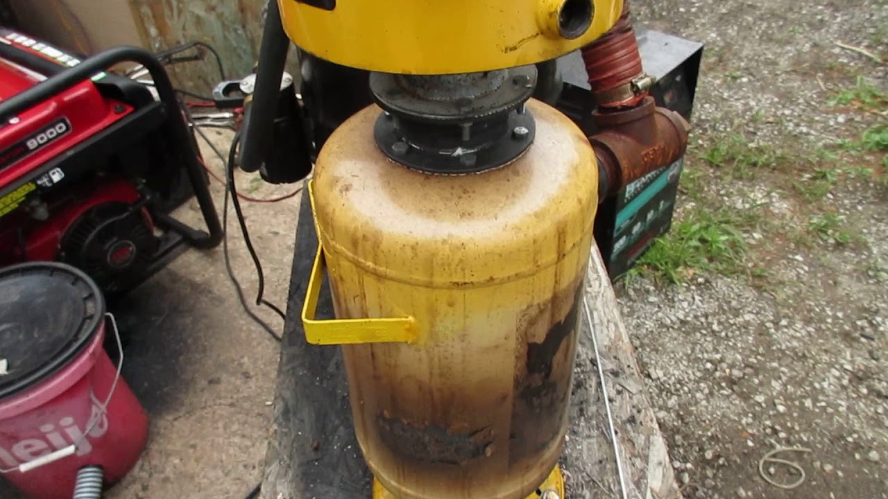

He said “Yup this is a pellet fuel machine. Pellets are the way forward for me with this reactor technology. This is the same technology that is in the Flex Power System. So it can run a range of engines from 400 cc up to the V twins in the 700 to 800 cc range.”
This will not run a car, its only capable of 400 to 700 cc engine run.
The charcoal is very low volume, it should not get hot enough where it is melting things. Besides there is not a jet in there to melt. There is a choke ring and this a consumable part and can be replaced if needed.
Keep in mind this not a sole charcoal unit where all of its volume from the char reactor. Only about 15% of volume is coming from this unit. the rest is coming from the upper reactor. This is also open source, so it is left open for improvement as well. We may add on a steam reactor later, but for now KISS!!!
Well hopefully this thing will run at the show like has been today. This thing is as low tech as it gets. No automated grate or hopper shaker, no fuel mixer controller, just a simple pellet fuel gasifier and this thing has been running like a top.
I also suspect this machine could run 100% charcoal.

It will have to be char pellets :slight_smile: this is strictly a pellet fuel machine. What ever you put into it, it has to pass thru a 1" hole in the reactor with out any hang ups.
would screened to say between 1/2 and 1/4 work? In reality 3/8s would probably be better then 1/2 but i don’t think it is a common size. I wonder if it would run the wet stuff after it was running.
That may work if it is screened small enough. But I suspect wood charcoal will be to light and bridge at the tiny restriction in the pellet fuel reactor. Pellets are very dense; both in wood form and charcoal form and are very uniform. This is key for flows in this reactor set up.
However, the only way to know is to try it, I dont know for certain so I cant say if it will or not. The machine has only been existence and operational for like a day!! lol. Small, wood chips I already know will not work in any shape or form in this reactor as the upper restriction the fuel is flowing through raw with out any reduction. .
I also do not know longevity of the charcoal reactor running wide open. So far I have had that thing running wide open and have pulled it apart and there is no melting so far. There is a choke ring there that is designed to take the brunt of the heat and can be replaced if needed.
Now there may be the possibility where the upper reactor and carb are removed to free flow any size charcoal with in reason.
In full charcoal mode this can run in two modes. first is where the upper chambers are closed off and the lower charcoal reactor is running at 100% or mode two, where both reactors are lit just like if it is running in wood gas mode. Still experimenting with this yet.

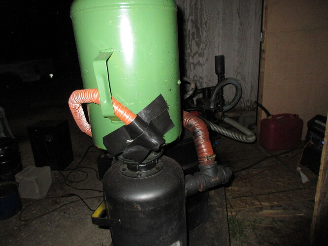

Just for you!! I hit the lower with Thrive Energy Black and the hopper John Deere Green!! :fire:
I even made sure to get some on some hoses and other things that arnt supposed to be green just like factory!! lol

I like the color scheme. Thank you!! :slight_smile: The hoses that get hit with overspray, I think are intentional so you know if you have the original hoses. :slight_smile:

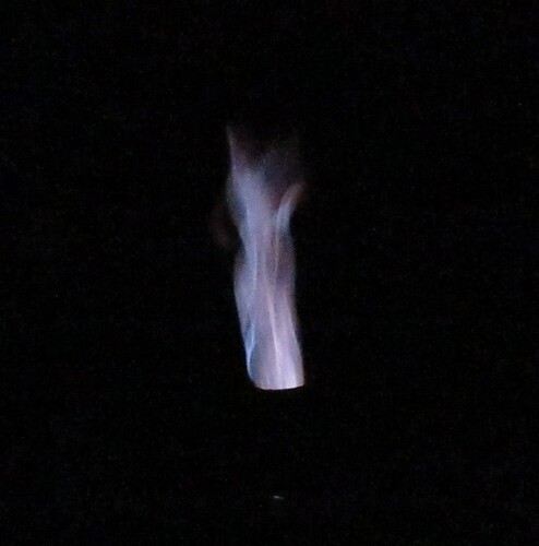

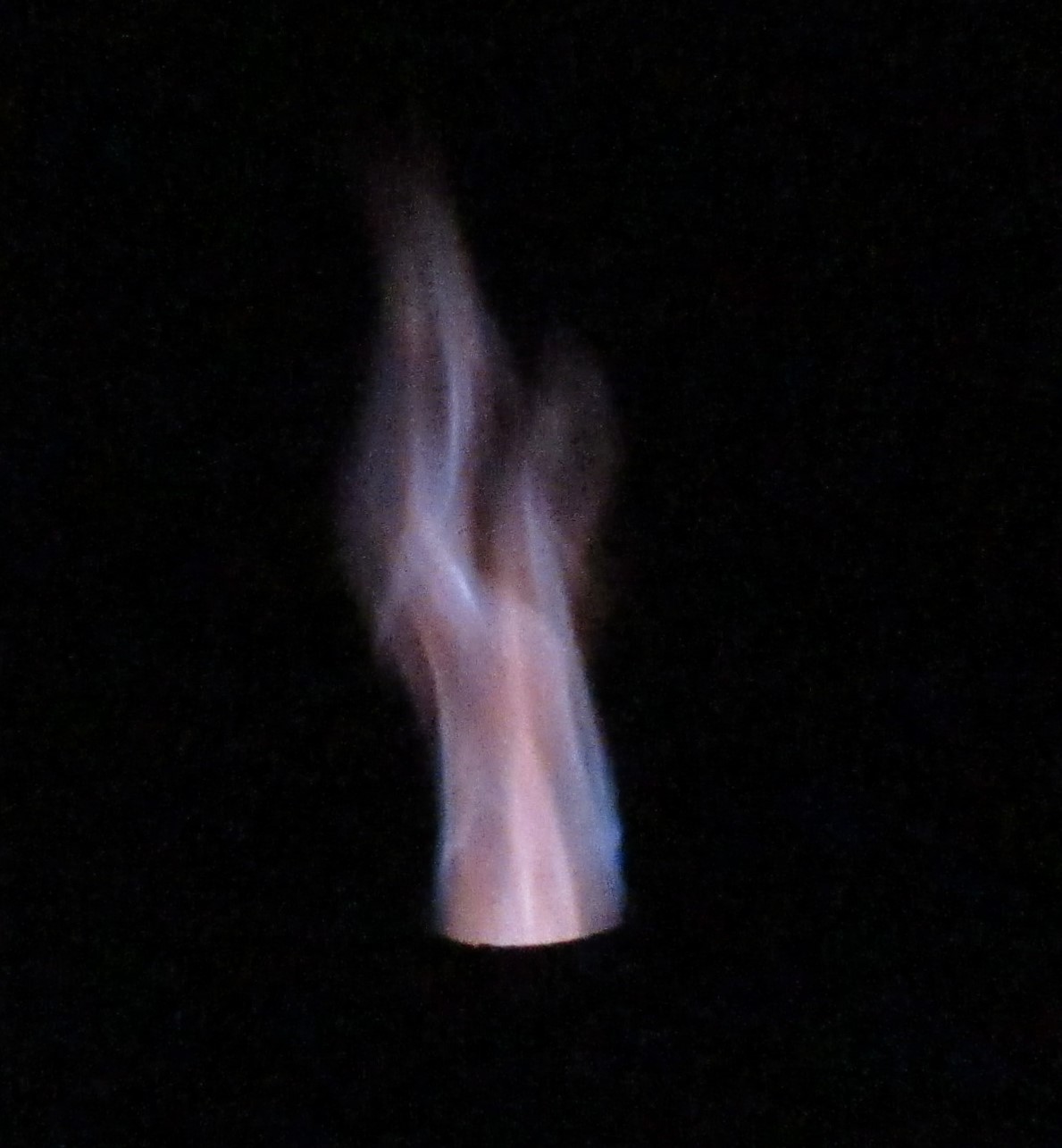

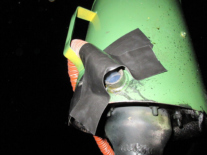

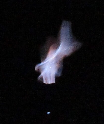

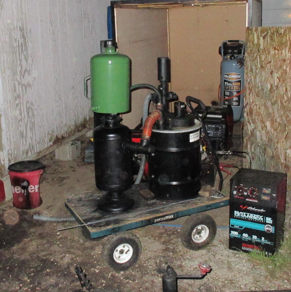

So to put this to the test, I simply recirculated the produce gas back into the gasifier. Pics speak for themselves and it did this for over an hour with less than half a hopper load. Probably three pounds of fuel. I know that the blower is capable of boosting the engine and I know the generator runs for an hour on a full hopper load. So Id have to say there are some efficiencies gained. However I need to re test and re test again to make sure this is repeating and not some other thing is happening that Im not aware of.
This is with the char unit wide open and feeding the hearth a woodgas mix. It can not run in char mode wide open otherwise. At least not for very long with out the top reactor going out.
I ran a battery test on the battery I had at the show. Its junk!! haha. The amps test is in the dirt 10% of what its supposed to be. I ran that blower from the charger and it screams like its supposed too. generally my blowers are a bit loud.
This thing can be stubborn little bugger to get going sometimes. But it is up and running under blower power for the day with the re circulation set up. This can be done on pretty much any gasifier, so it would be interesting to see what others experience. This mod by itself maybe a simple upgrade to achieve more stable flows along with a hotter hearth / cleaner gas output.
Now I got to figure out how to add this re circulation while under engine run. I think I might tap into the hose connection between the dual cyclones and feed the engine from the first one and then feed the gasifier with the blower.
Anyways for today, I am going to run all day and just observe it. I cant even see the flare not even a slight tint of color. So will need to wait till dusk to see whats going on.
