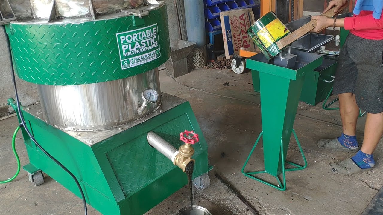

I found this machine interesting, imaging what i can do with the heat of charcoal making as energy source…
Very interesting.
It looks like the sort of undertaking that makes good sense in the 3rd world.
When I saw the paving stones made from plastic, I was thinking how slippery those would become once worn and wet. It occurred to me that a high proportion of the mix could be sand, thus greatly extending the use of the plastic, and making a stronger and more useful product.
I hope you explore this idea further.
I was also concerned about the lack of gloves or safety glasses around the molten plastic, the consequences could be catastrophic!
I wonder how you would ever clean it up if the plastic goop in that outlet pipe cools?
Tiger torch…
Plus a few more characters.
…And a cloud of toxic smoke…
yup, was thinking the same…
dough i love the possibility’s with the idea…
What other options come to mind are making fence pole’s, construction beams for small sheds, etc etc…
I have always thought of building inter locking bricks for basements and retaining walls. Possibly putting them together with all purpose pipe glue to seal them.
