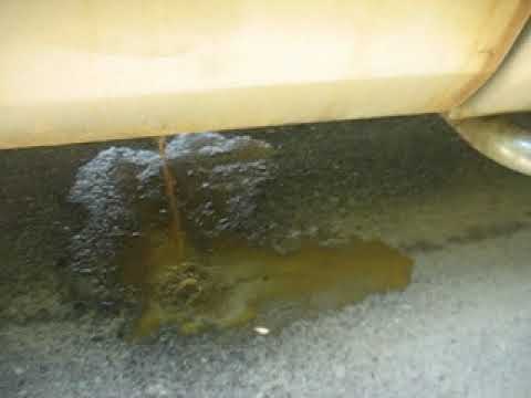

When draining the hopper condensate if the gasifier is warm and alive there should be smoke coming out of the drain valve . If no smoke you know the piping from the gutter to the condensate tank is clogging .
When my gasifier is hot and the truck is shut off with the gas vavles closed i can turn the pusher blower on for a little bit and blow alot of smoke out of the vavle that tells me its open.
Also i use the pusher blower to blow heat though the condenser tank to help drain the tar.

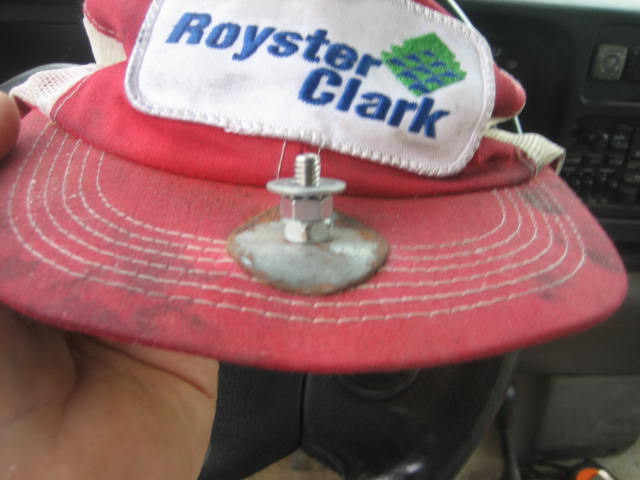

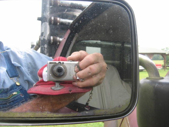

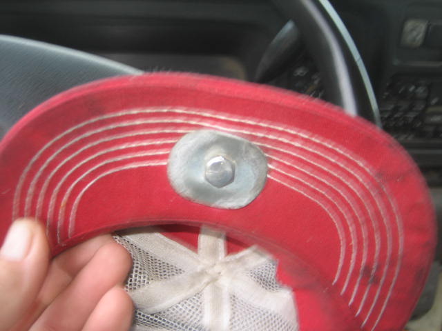

Hello Don Mannes
At Argos you were asking about my CAP CAM.
Poor folks have poor ways :grinning:
IMG_0905IMG_0906IMG_0910
I like it Wayne. But I think I will have some problems mounting my Sony Cam Recorder on the bill of the hat. Just kidding.
I need something a lot lighter in weight like my Cell phone with a short holder that can be mounted to a hat bill.
And all this time I thought you went out and bought some fancy Go Pro Camera, I should of known you would come up with something better and more practical with out all the Bells and Whistles and other stuff attached.
Thanks for the Great idea Wayne. Keeping it Simple and DOW seems to be why you are so successful.

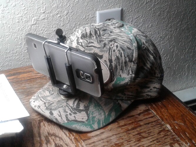

Here is my latest edit:
I mounted my cell phone on my camouflage hat so no one would notice the video camera running while DOW. “Stealth cap cam”
