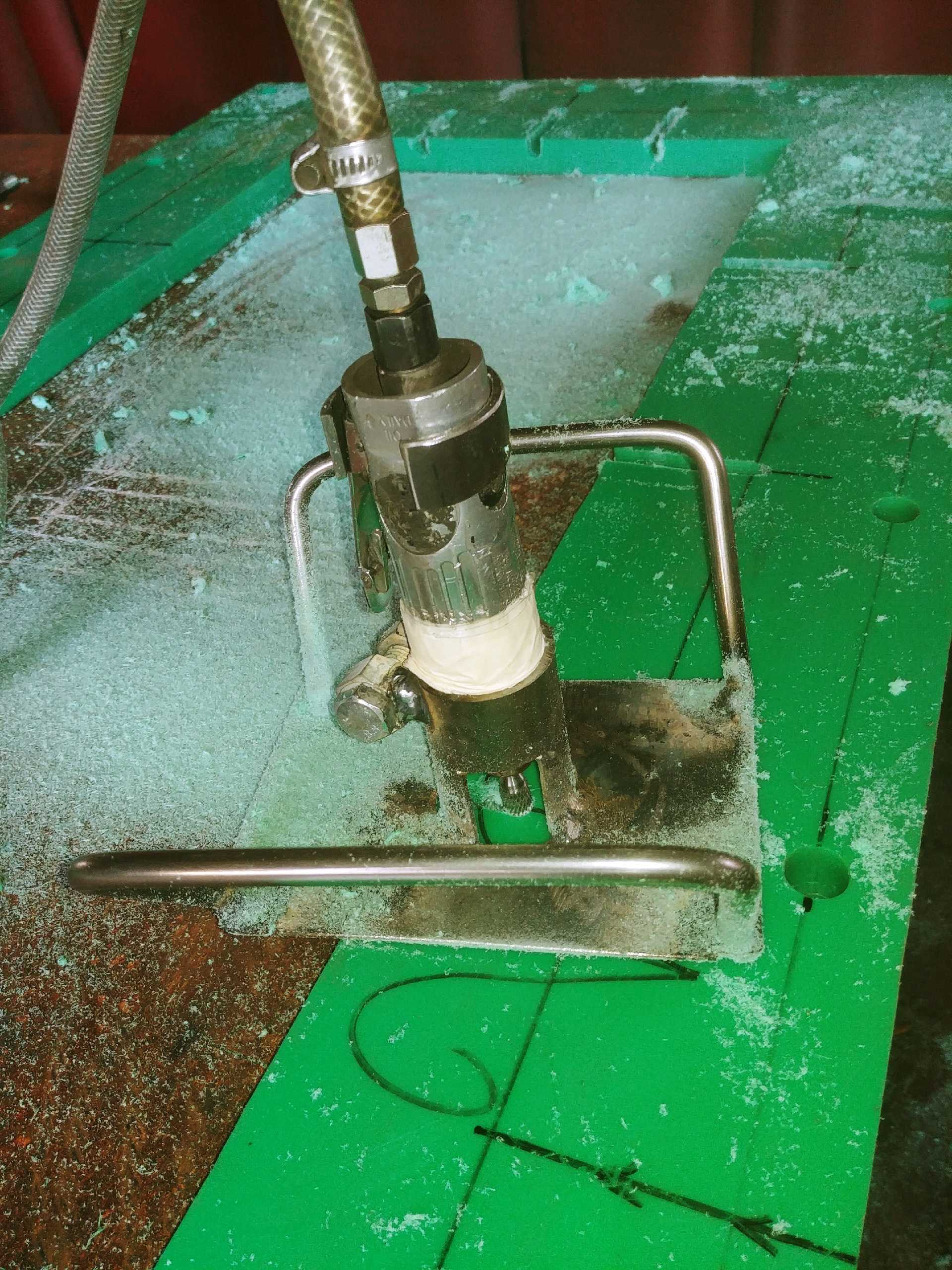

a small adaptation to an air bur to run grooves in plastic plates

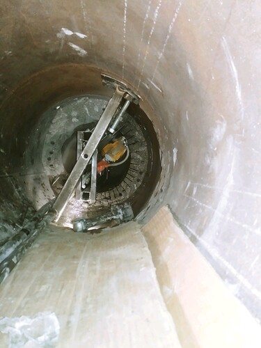

Demolition of a concrete in a steel tube,
adaptation of a sawing system to the diamond disc to then be broken with a pneumatic hammer.

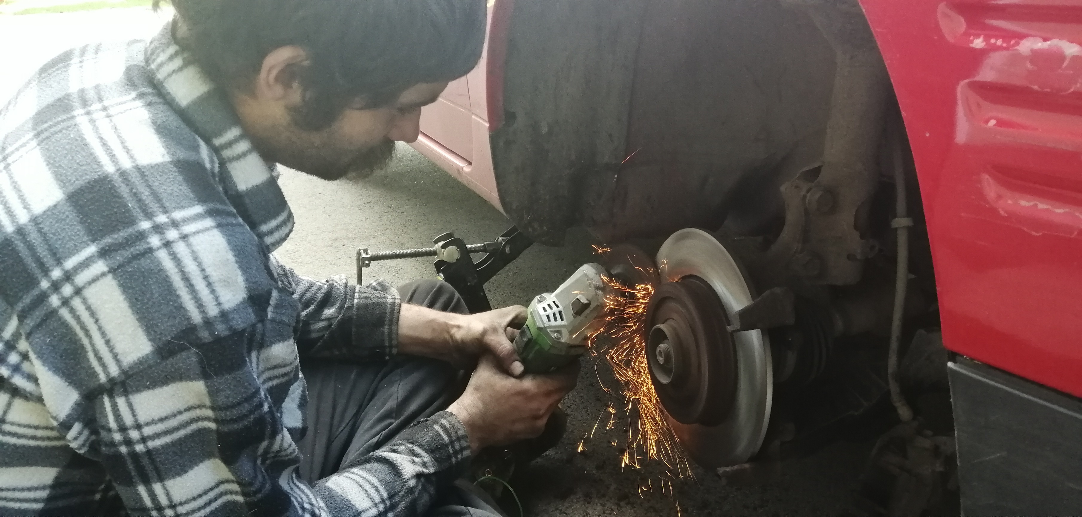

The car inspector sayd the discs on my trusty old Seat need replaceing, or latheing down due to severe oxidation and pitting on some places. Well, new discs do cost money and l do not posess a lathe… Or do l? :wink:
Surpriseingly, it did a preety good job. I need to correct one side, l can feel its not 100% true. The left side apears to come out perfect.
Good job Kristijan; I was at my mechanic’s shop and he had a brake lathe sitting in the corner. He was putting new disks on a truck. l asked him if they ever ground brakes down any more and he said up here in the rust belt, the disk/drums are too pitted. That salt or cloride or what ever they are putting on the roads cost us big money for the material but worst what it does to our vehicles. TomC
I usually glue abrasive paper to the blocks and then ride and brake a little gently, doing really well.
Ha, thats a fantastic idea! Thanks will try tomorow.

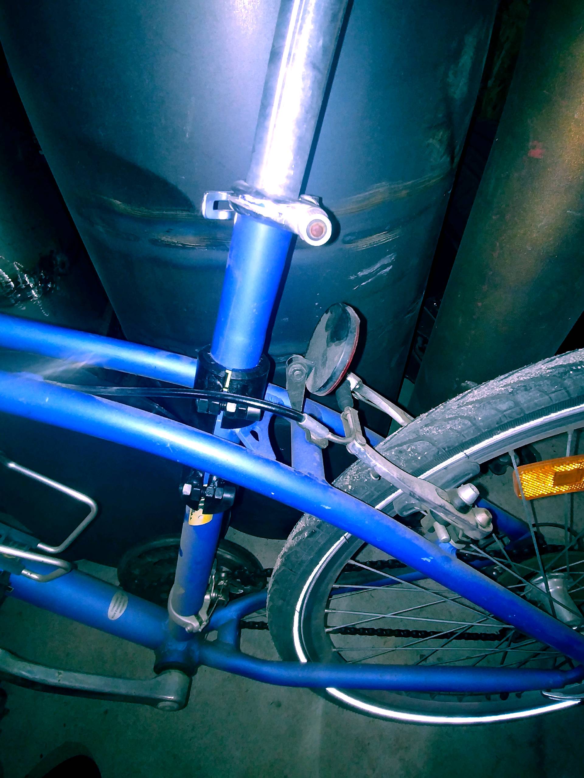

clamp for consolidation of the broken bike frame.
it is true that I am big and the frame did not resist.

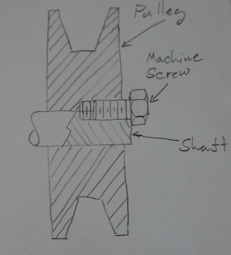

I once saw where someone had drilled and tapped a hole into the crack between the pulley and shaft. Then threaded a machine screw into the hole. It worked.

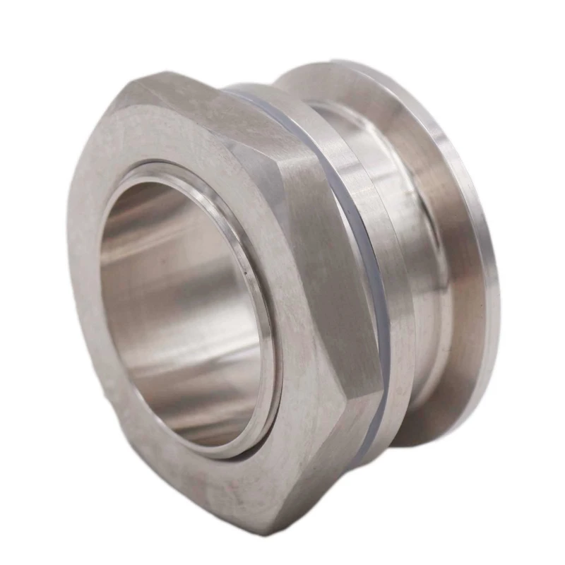

just ordered a bunch of this stuff kind to play around with.
Looks great for covers , filterhousings and a lot of stuff…
Search for Tri Clamp and start dreaming (drooling) what you want to build with it…
For filterhousing, i ordered a bunch fittings with 2",
Bulkheads…
Very nice! I’ve not encountered that style of filter housing.
At one time, I started putting together a gasifier design built purely out of tri-clamp fittings. I never did finish it, but you’re making me want to dig out the parts and resume that…
Lots of fun stuff Sanitary Concentric Reducer | Tri Clamp 8 inch x 4 - SS304
1/8" and 1/4" fiberglass braided rope intended for stove gaskets happens to fit beautifully under compression in the grooves intended for the triclamp gaskets…
