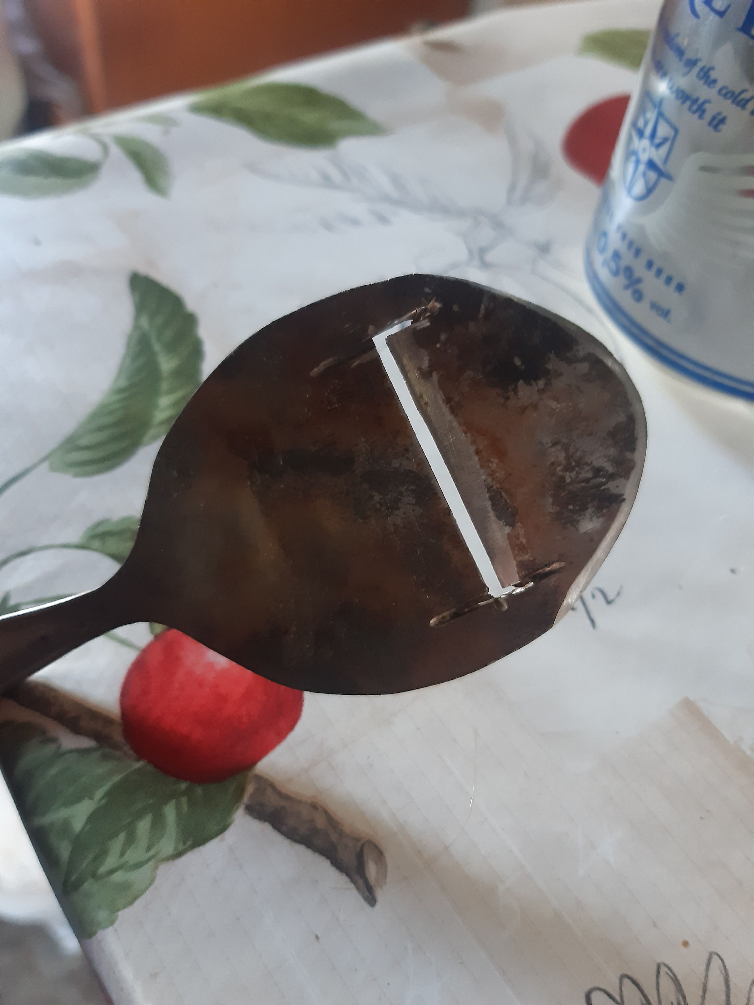

I have a trick of my own to report. I got sick and tired from those crapy potato pealers constantly breaking. So l forged my own ![]()
Did you sacrifice the silverware?
