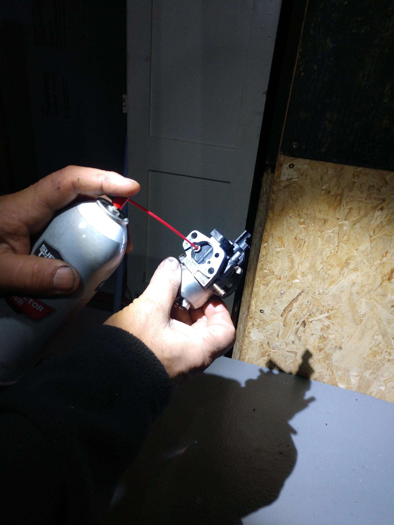

This picture shows where to spray into the left side passage

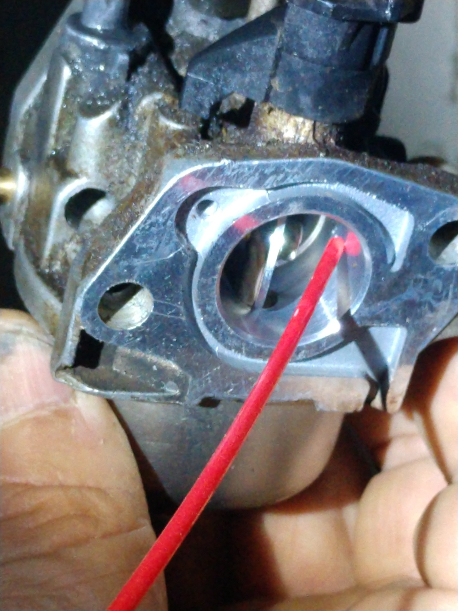

The straw in this picture, is pointing to the off idle ports. This is the engine side of the carb.
Tom, if you take off the air cleaner apparatus and expose the choke end of the carburetor, you can spray carb cleaner into the left side passage. This passage goes directly to the three little off idle fuel passages that may be the cause of your governor hunting. It’s a minimally invasive procedure.
Not supposed to snow on Friday Bruce. I’ll try the choke side option then and report the results. You must have a good camera.
