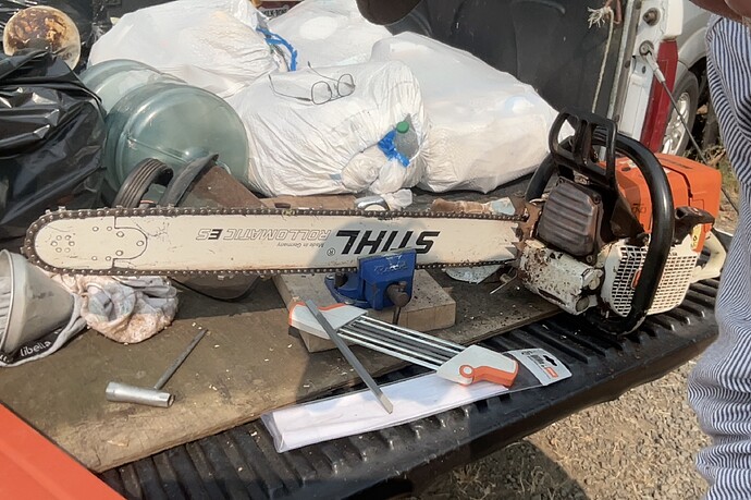

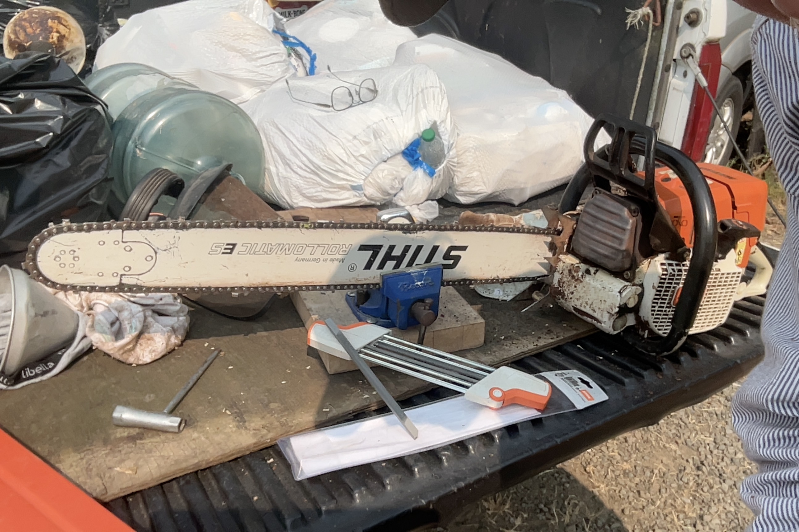

Here is a new-to-me woodcutters tool I’ll review:

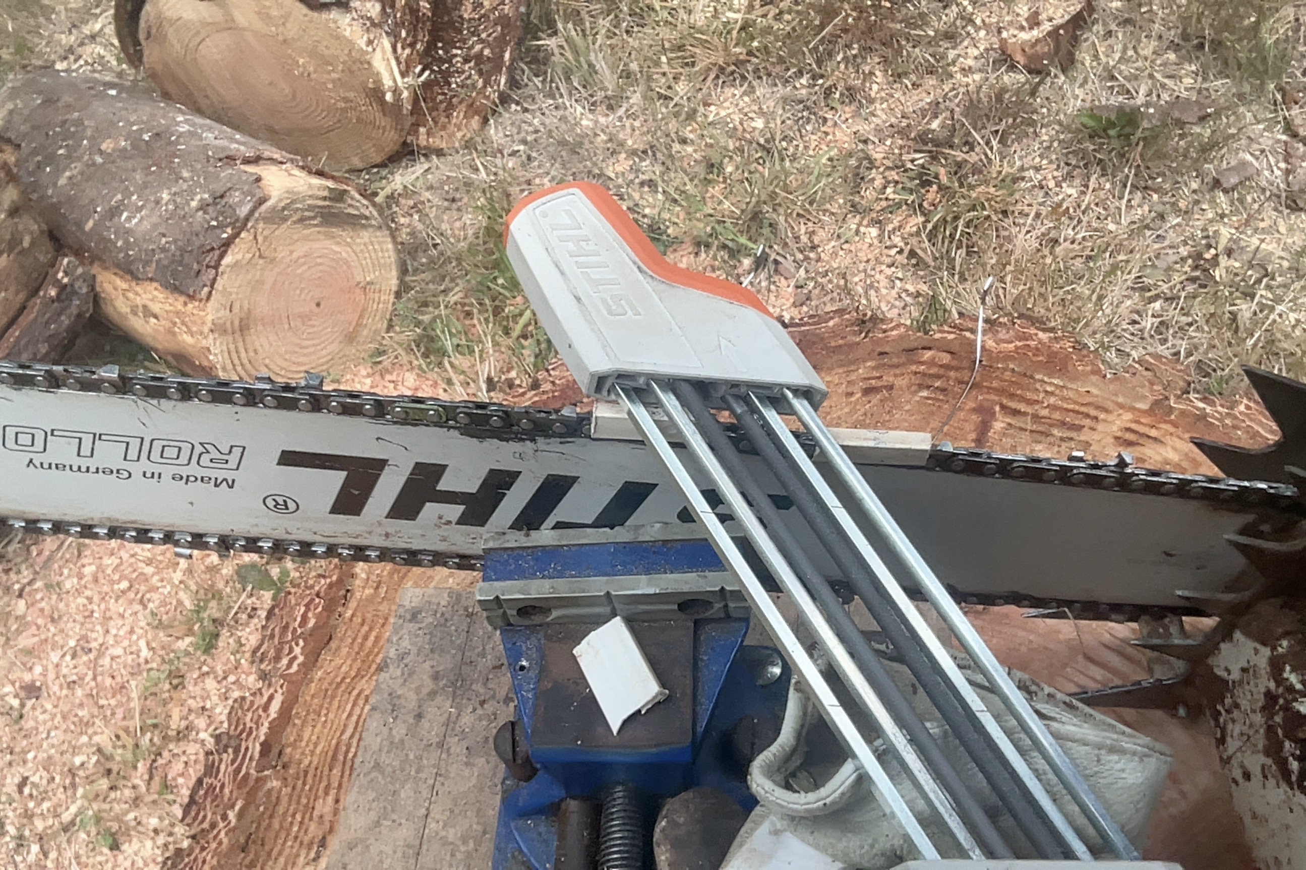

The Stihl 2-in-1 file holder. I’ve been able to now get nearly chain-off-bar, machine ground sharpening’s. With those cuts-like-butter performance’s.
The only downside is the square file for simultaneous depth tooth filing is set up way too aggressive. Letting it decide on my first-use sharping I was then cutter tooth grabbing and even stopping the chain. This tool is set up as openable to allow for round files rotating and replacing. Tip: only let the square file work ~halfway down, then remove it. Finishing off with just the round files. Later when your chip eject and cutting rate decreases (or gauge measuring protrusions of the depth teeth), put the square file back in.

I must add an addendum to my review of the Stihl 3-in-1 fine holder tool. Observing it in use; and going back and carefully viewing the pictorial instructions; it was designed for a FULL Composition of cutter teeth chain. I use skip tooth chain! The outward square guiding rod is supposed to ride on the top of the next tooth to be sharpened. Skip tooth, it then rides on the much lower plain connector links. Why it was filing the depth teeth aggressively too low.
So out of plastic windows moulding I made clip over raising adapters to mimic the missing teeth tops

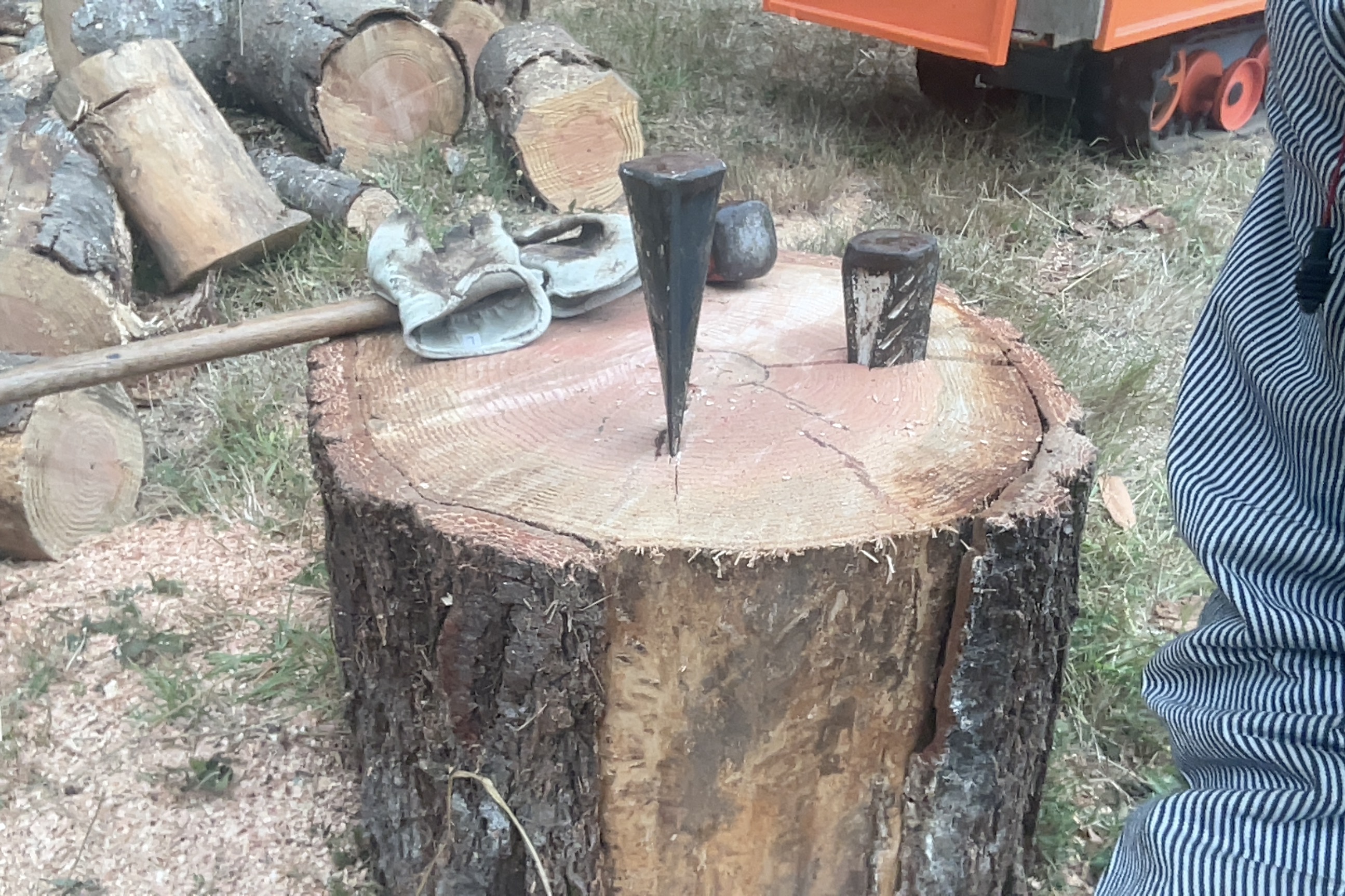

Here is a make-work tool I’ve been using now for over 10+ years since I turned old-man with no power swing breathing capability. European twisted steel splitting wedges.
The older white painted one with the diagonal steps in it was 1st grade expensive. Said to be from France. And has excellent steel and a heat treated head. The newer gray one at 1/3rd the price, without the diagonal steps works just as well. But is striking head mushrooming already on only it’s second year of usage.
These are much, much better than anything else I’ve ever used. Just one tap to set. Then no more than three easy swing smacks ( old-man/woman) to get the round halved. Two more sets and six more strokes and I have quicker drying, easy handling, quarter splits. Those pointy Wood Grenades too often sink them selves without splitting on my fir wood rounds in my experiences.
