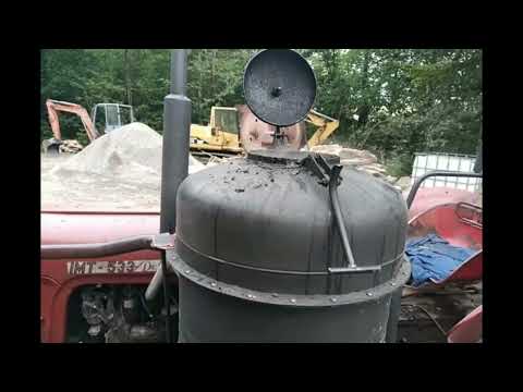

Lately, the start-up of the gasifier has been taking a little longer than usual, but I decided to do a thorough cleaning, well, there are a few pieces of ā€œstonesā€ underneath, and the restrictor tube is a little damaged. I did the last emptying of the gasifier 100 hours ago, when I changed the restrictor tube.
Stones = slag? Too much air? Something happened to the cetral nozzle?
I dont dare to say anything. Only that I am impressed how airtight your build is. Any leak would apear when you start up. And I am trying to understand how all is connected.
JO, the central nozzle is undamaged, for the formation of slag, a very high temperature and density of ash is required in the hot part, which does not retreat into the ash space, in which the ash level is too high,… :stuck_out_tongue_winking_eye:, to conclude, the fault was negligent and a lazy operator who didn’t remove the ashes, ME :woozy_face:

There in the ā€œVolvoā€ thread, I said something about reworking the gasifier or the hot zone, well, let’s not just talk about it,…
comparison old and new unfinished unit
old and new nozzle, in the middle the nozzle for the upper part
larger diameter of the restriction pipe
nozzles installed in a diameter of 14" for gasification of fuel against the walls and a tube for reflection of hot radiation around the upright grille are also missing
of course I will save the old unit as a good spare part if the attempt fails
