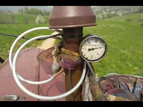

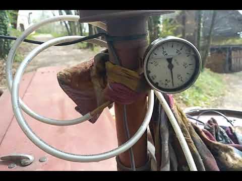

There is a lot of talk about engines, loss of power due to negative pressure, which is created due to the resistance of the gas mixer, filter, cooler, gasifier,
 I made a negative pressure measurement directly in the intake manifold behind the throttle valve, so we can actually see what amount of gases the engine inhales. When the engine is unloaded and idling, the vacuum is 0.6 bar (that means 6 m of water column or 236 inches), and with the throttle valve fully open, the vacuum is 0.95 bar (0.5 m of water column or approx. 20 inches). . When I think about what this means for the operation of the engine, I can say that an unloaded engine needs at least 40% of its cylinders to be filled with a combustible mixture, which expands and pushes the piston during ignition and combustion, and at the end of the working cycle, the pressure of these gases is higher than ambient pressure, and at the same time we must also take into account that some of these gases remain in the cylinder when the exhaust and intake strokes alternate, so the engine actually captures only about 30%-35% of the fresh mixture. Here we can conclude that wood gas increases its volume by approx. twice upon combustion, interestingly, similar to when operating on diesel fuel.
If I try to think about the vacuum at full power (0.95 bar), I can say that the resistance of the wood gasification system does not take much power, more power is lost if the engine has a low compression ratio, because more of the burned hot gases remain in the engine due to the large volume of the compression space
Your logic and reasoning is sound Tone. Beginning states. Ending states. And residuals all affect.
