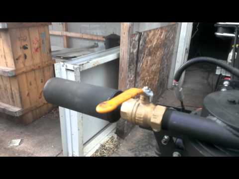

Well here is the first 2016 Flex R-1 machine, I built the electrical box tonight and will work on the fuel mixer system tomorrow. Should have this ready to run this weekend.
Looks good Matt R, that must be the one made too run the 12.000 watt generator around 5000, I could hook that too my plasma cutter.or mig welder and build all day long on wood chips.I run across anyone looking for a top notch unit i will send them your way.
The electronic fuel mixer controller is now available. It comes standard with a 1" valve but we can build up to 2" valves upon request. Pricing $950.00
Burning the machine in today, we ran the generator for an hour on full auto mode. The chips I have suck they are seasoned but have been left in the rain and are soaking wet. I got a clothes dryer at my disposal, we are going to dump some chips in that thing and see what happens lol

Well if you are in a pinch and need to dry your fuel this does work. What I did was wrap a load of chips in a bed sheet and zip tied the corners together. Our fuel is soaked, the meter we have wont even register. It took four full cycles to fully dry. I got this dryer at a second hand store for 25 bucks a few years ago.

Our plasma cutter does not have the right plug or I would have tried it. 35 amps @ 220 V I is 7700 watts, this would be more than the rated 5 kW rated output. When we rate the machines we cut the generator output by 50% this gives the machine a reasonable rating that we know can be achieved. However, 70% of the power can be harnessed but conditions must be perfect and this is not always going to be the case.
