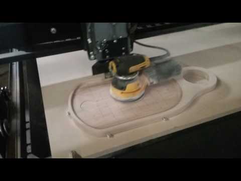

Ok the CNC machine is almost complete. Just a few minor things left, I have to install the limit switches, and the top panel to the operator’s stand. It turned out really nice and I have it tuned in to hall a$$!!!
We will run test parts early next week and should have it in production as early as the end of the week.
Yeah, not only is the first machine, its going into a production environment!!!
That looks like a thick sheet of steel on the table. How thick can it cut? Does the torch have the capability for auto height control? What kind of drive is on the Y axis (up and down the table)?
Rack and pinion? I seen what looks to be a sprocket that makes me guess chain drive.
Cool looking unit I want one.
Hi Tom, this is going into a wood shop. The head that is on it a simple Dewalt orbital sander. The top piece is a fixture plate and is 3/4" plastic so they can mount fixturing to it. This machine will be performing finishing process for chair armrest
Yes tried a chain drive on this one, however, I wll go back to belt drive going forward. The chain adds more wieght to the inertia loading.
Unit pricing is $8,500.00 USD, this comes with controls and if you are going run a plasma application it will have the THC set up as well. You will need to wire in your voltage leads from your plasma machine though. If you want this turnkey we can do this as well cost will be around $11,500.00 and it would have the Hypertherm 65 with a machine torch all ready to go.
