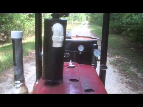

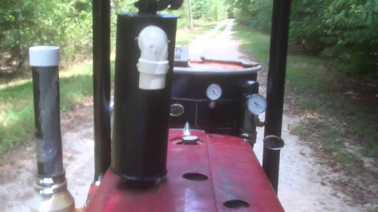

Here is a video of the first few minutes after firing the gasifier and driving to the mail box. Poor quality video as usual and trying to learn to drive a new machine with one hand .
One steel pipe on the left side in my field of view exiting the vacuum blowers can be removed. I hardly ever flare so I shouldn’t need it . .
