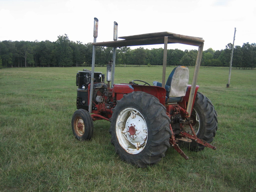

Yuppers it’s working now… Sure like how that tractor is running it!

Hey Bill and Terry , Thanks much for the nice comment.
Bill ,
" Did I notice a hole in the line for air and a valve near the tractor? "
The hole in the line lets in close to the amount of mixing air the tractor will need. The valve is for fine adjustment.
" Also, when you disconnected the gas hose from your truck, Is it important to seal the truck up right away as to not get oxygen creeping into the system while the hearth is still hot? "
As long as the gasifier is warm there will be a light positive pressure through the system . When the gasifier cools of enough that the air flow might seep back in the gasifier there will be no fire. Each time I shut down I try to remember to close the intake air but often I forget . I do try to remember venting the hopper before sticking the lighting torch in at next light up. .

Can’t wait to see this one flare late evening or night .
HWWF ( have wood will farm )

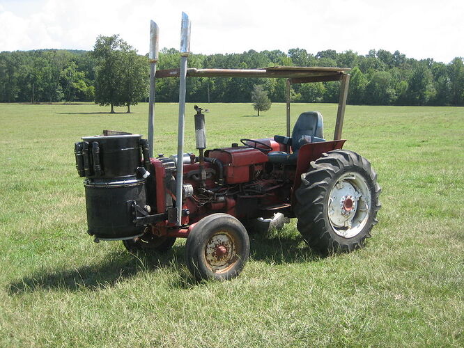

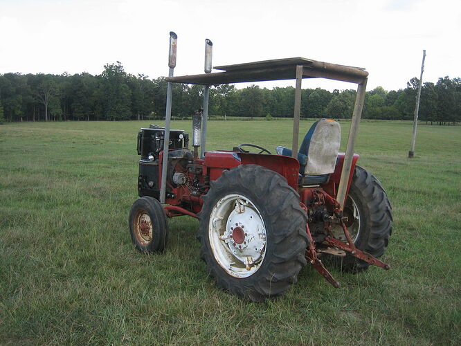

PS still have a lot of work to do , motor exhaust heat exchager , condensate tanks , and filter .
Like those dual chrome stacks, are you going to flair out of those? I like the whole project!
Hello Herb,
Thanks for the comment ,
I could flare from those stacks but hardly ever flare . I stuck those stacks up there just to take a pic and see what it would look like
A low hanging limb would probable wipe them out .
Did you post somewhere about the ammo box on top that I missed? Hopper fill lid? angled for condensate runoff? Need springs yet?

yes wayne that one will definatley stand out but I like it I put a vote in for the stacks you can always take them off if you find your self farming in the wood anyway ha. well I should go clean off the truck manure thanks carl.
Thanks guys
Don I will get you some detailed pictures first thing in the morning .

Hey Chris,

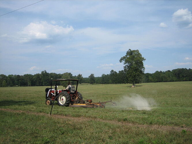

I guess you can add another tractor to the completed list . I still have a few minor thing to do to it but I have been the last 2-3 hours bush hogging . Running great so far .
Videos to come , computer very slow .
