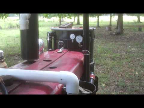

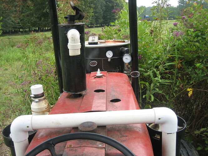

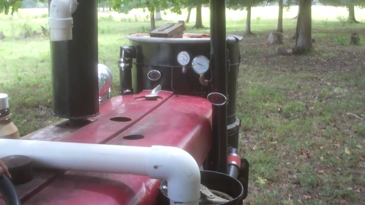

With pine the 33 pounds is about the limit. I worked about 5 min too long trying to make the two hour mark . Hopper temps shot up , cooling rails temp increased , decreased power . The wood / char was at nozzle level .
One thing to keep in mind . If the tractor is used for some type of stationary use a hopper extension can be used .

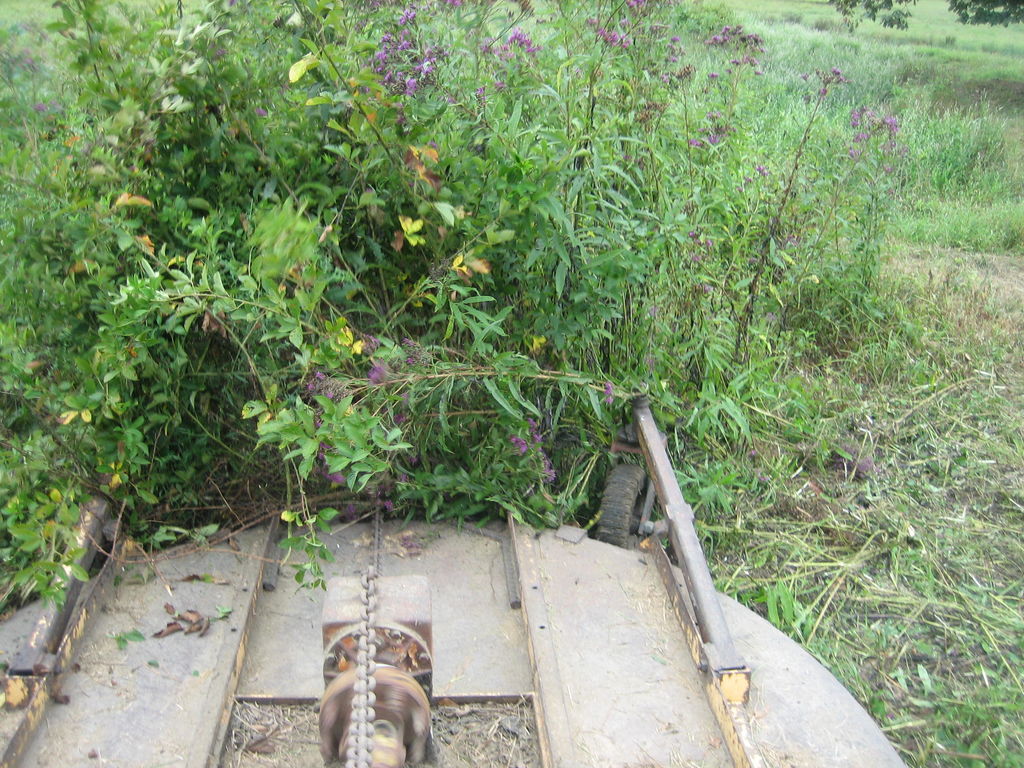

Here is another one you can’t watch but Terry L probably will . It is one lap around one of the patches mowing with the wood burner .
Wayne, did you take lessons from Terry Grzyb? It looks like you popped a wheelie at 055 minutes. That tractor sounds really good brush hogging. Are you running at about 3/4 throttle?

No wheelie but going up a steep bank.
Tractor throttle set at about half . Whenever in thick grass maybe 3/4 . ( grass is much harder to cut than weeds )

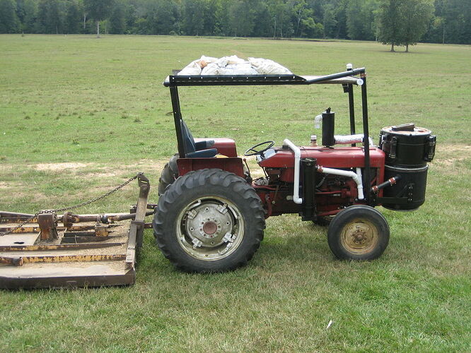

I will be adding a top.

The first impressions are good and if I were to start another gasifier today I would go with the latest ( experimental ) design. The truth is it has not past the time test yet .
I have been working the tractor hard and will be putting 6 more hours on it before the day is dark . If I were using gasoline I couldn’t speed up much more because my speed is limited to the roughness of the ground vs power available.

Looks like that gas cooler could perform double duty as a wood drier if needed!

It doesn’t get very hot up there but if the wood was in onion sacks and ride it around with you all day I’m sure it would dry some.
